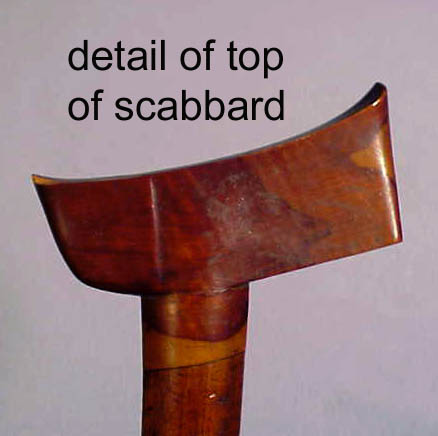

Dear Alan,
I have some info to share.
I referred my pictures below. Here in my place, people liked to name it as tumbuk lada instead or siwar/sewar.
When I ordered a new dress for this siwar from tukang in Terengganu, Malaysia, I have specifically asked for kemuning. He admitted this wood very hard to find and managed to get some of it.
I do not know wether he correct about kemuning, but majority people in my place believed it is kemuning.
I provide a picture of the wood before and after polishing.
Ria

I thank you for these photos Pak Ria.
All I can say is that both your chatoyant yellow wood, and the chatoyant yellow wood in the other photograph have the precise appearance of akasia.
If you tell me that you have been told by the tukang wrongko that it is kemuning, I believe you.
The only kemuning that I have seen, and that I know was kemuning, has been in old Peninsula and Bugis wrongkos. It has been hard, and the chatoyant grain has had the nature of a sunburst, rather than the consistent fiddleback grain that I can see in the other wrongko and in your scabbard. I have never seen a kemuning wrongko with this fiddleback grain, but I have seen Javanese hilts with a fiddleback grain.
On the other hand, I have seen a lot of wrongkos made from akasia that do have the consistent fiddleback grain that is shown in your scabbard and in the other wrongko.
We're working with photos here, not the real thing, but based upon what I can see in the photos I would without hesitation say that I'm looking at akasia, simply because I have never seen any verifiable kemuning that looks anything like this, but I have seen a great deal of akasia that looks precisely like it.
I have also seen other woods that are close to kemuning in colour, and that have a fiddleback grain, and that have been used in wrongkos, such as paumarfin--- a South American wood that a dealer in Jawa imported a very large quantity of from Sth America about 30 years ago.
But if you tell me that your scabbard is kemuning, I believe you; its just that this is the only piece of kemuning that I've ever seen that looks like this --- except for the wrongko in the previous linked site.
One of the facts of life is that akasia is a wood that has only begun to be used in the recent past. It has no history, and no esoterica attached to it. In fact, although it is sourced from Indonesian trees, I'm not even certain that it is an Indonesian idigenous wood. Its always easier to sell something if that something can be linked to a little bit of tradition. Akasia has no tradition.

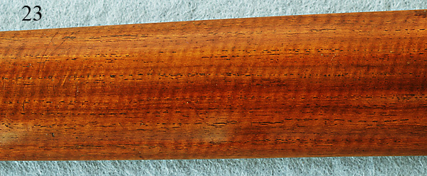

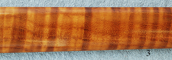

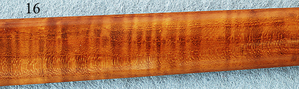

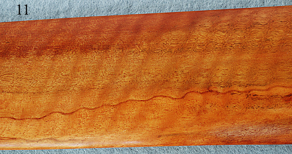

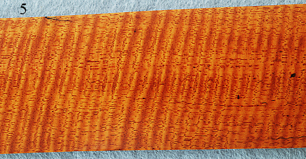

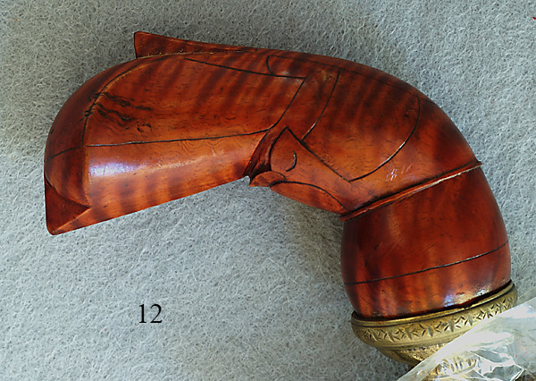

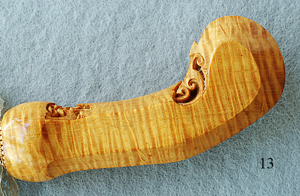

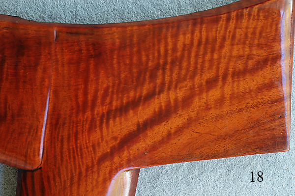

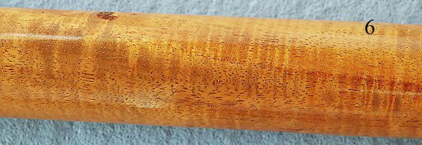

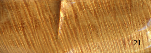

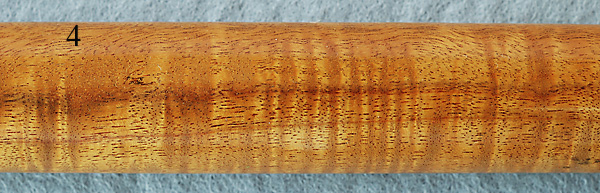

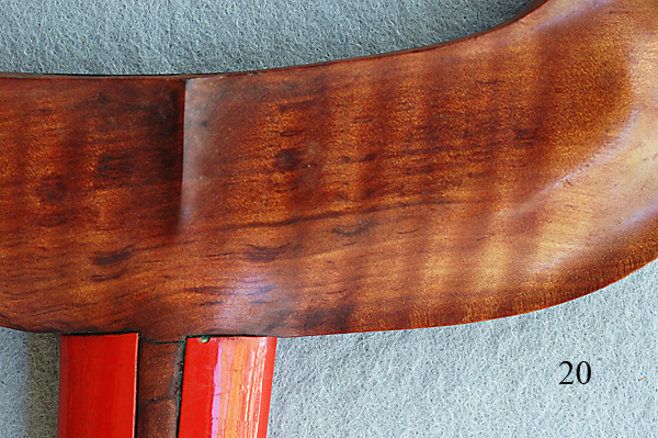

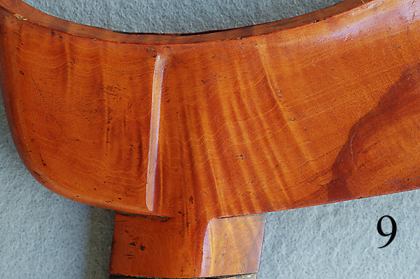

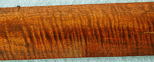

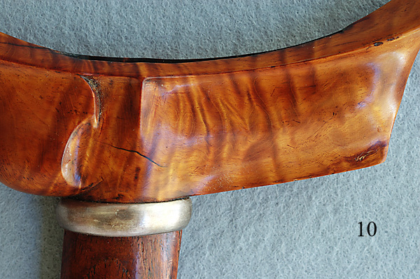

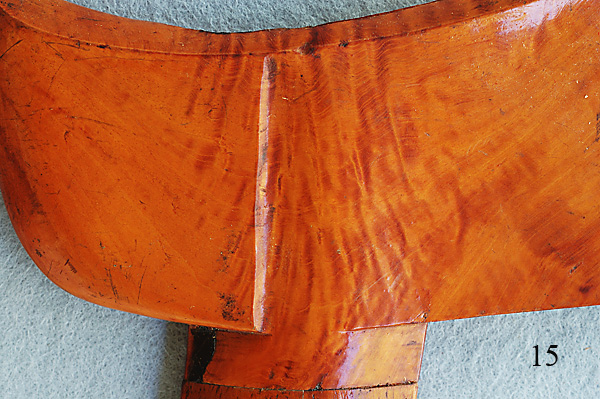

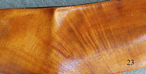

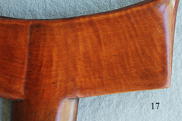

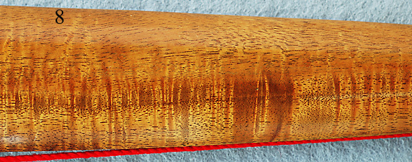

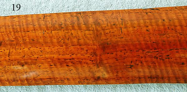

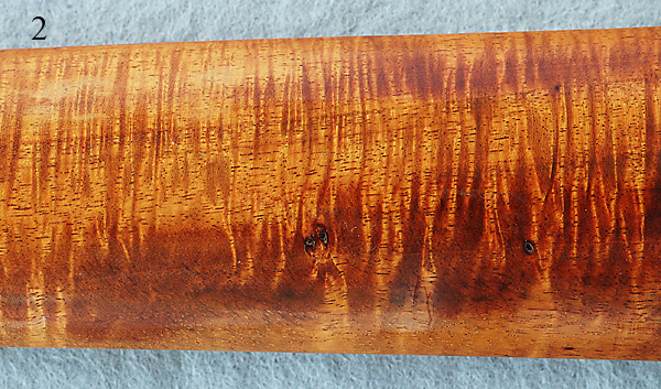

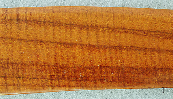

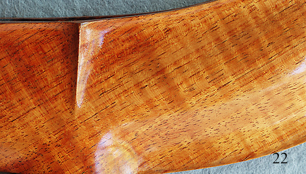

The following 20 or so images are examples of similar wood grains.
I cannot correctly name all the different types of wood that are shown here. I can name some with absolute certainty, I can guess at others, and there are some that I do not know.
I am inviting everybody to nominate the images which are images of kemuning.

Posts: 7,209
The examples of wood that I posted yesterday have been viewed 110 times since they were posted.
It appears that none of these 110 views has been sufficient to permit any of the viewers to identify the examples of kemuning.
Here are the woods that I know with absolute certainty:-
akasia:-
6, 4, 3, 2, 11, 8, 16
pau marfin:-
13, 21
Tasmanian blackwood:-
22
#1 is probably akasia, but I am not certain.
the following numbers I am uncertain of; I can guess that some are kemuning, but I do not know with absolute certainty that this is the case:-
20, 10, 9, 7, 5, 18, 17, 15, 12, 19, 23 & 23.
Note:- I made an error in numbering, there are two examples identified as #23

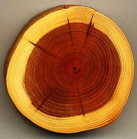

The only theorising that I've come across that relates to colour variations like is that when you get a wide variation in colour in the sap wood what you are looking at is the result of infection or damage to the tree. However, the way in which a log is sawn also has a huge effect on the final material. There is very often a wide colour variation between the sap wood and the heart wood in a tree.
The grain in the material of the example you have shown runs along the width of the wrongko top, from one end to the other. This means that it has been cut from a length of timber that has been sawn from the length of the trunk. A tree grows outwards from its core, so when you have a poor season, or a dry season, or a very good season, you can see this reflected in the growth rings that radiate from the core of the trunk.
Looking at the example that you have posted, Kai, I believe that what we are looking at is the result of the way in which the log was cut. There are several techniques used for cutting a log that will produce different effects in the grain shown in the final plank. The most common technique used to produce fancy grain material is called quarter sawing, a technique that results in the growth rings falling between 80 and 90 degrees to the face of the plank.This is done by first cutting the log into quartersthrough it, and then sawing each of those quarters longitudinally, producing increasingly smaller planks as you move to the outside of the quarter.
If we look at this example, we can see very pale wood at the extreme right, then moving left a darker wood, and at the far left a small touch of pale wood again. The pale wood would be sap wood, and the dark wood would be heart wood. The log that produced the material from which this wrongko was carved was sawn in a way to maximise the colour variation between heart wood and sap wood, and at the same time to maximise the chatoyant effect of the curly grain.
The image of a log cross section might clarify how this can be done.
Then again there are the other factors of genetics and disease.

IN the region there is also the nara tree that has a red core and a brown outer wood. Could other trees in the region also have similar characteristics?
Old 1st May 2010, 11:07 PM   #48
Posts: 7,209
Other trees all over the world share these characteristics.
All trees have heart wood (the core) and sap wood (the outer wood).
Almost invariably these materials differ in colour.
I've never seen it, but I have been told that the sap wood of black ebony is in fact white.
