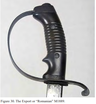

Is that grip a turn of 19th century/ww1 German sabre grip?
I now wonder if this possibly a not often seen German export , Romanian artillery officers sabre?

Certianly German manufatcure?
