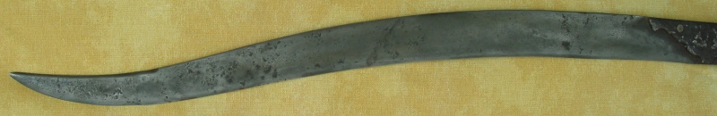

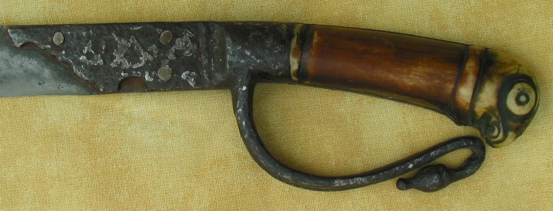

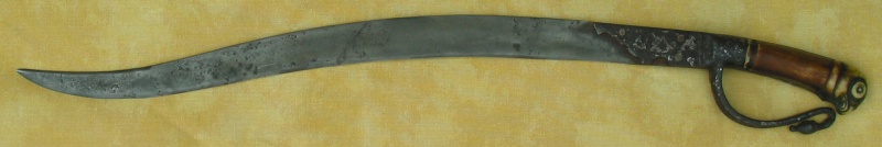

My interest in Kopesh/Kopis-like blades got me this nice sword for which I yet have to find a name or any other details on its history - any suggestions/observations most welcome!

Total length is 62.7 cm with 50.4 cm of Wootz/Bulat blade (that's almost 25" and 20") and a cast(?) metal hilt (21.2 cm or 8.3" including the reinforcements) with little silver Koftgari left. The grip scales are bone and have been painted (brownish body with traces of olive/green remaining on the head of the parrot).
The blade has a ricasso (4.6 cm/1.81") and a sharpened false edge (10.0 cm/4"). It has an hardly noticeable, forged central "fuller area" almost along the whole length (i.e. blade slightly thicker along the spine as well as towards the sharpened edges than along the center). Maximum thickness is 3.9 mm (2.5/16") with 3.4 mm (2.1/16") remaining at the base of the false edge. Blade height is 23.2 mm (0.91") at the base, flaring out to 30.9 mm (1.22") around the middle of the blade, and still 26.9 mm (1.06") high at the base of the false edge.
Although it may have originated somewhere else, it was obtained from the Hyderabad region, a hotbed of So(us)sun Patta(h)s. However, the blade of this sword is about 1/3rd shorter than a regular blade of those larger cousins and just about everything else doesn't fit either...
I don't have much experience with Indian arms and would appreciate any pointers or references!
It was said to be late 18th century but please put forth your own estimates...

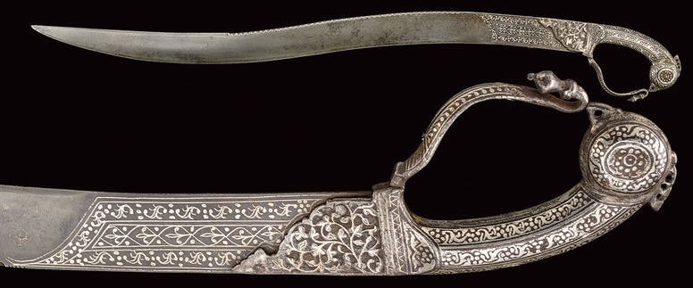

I could not resist coming in on this as it recalled some discussions we had on a chopping sword with vague similarities last June. I recall that initially I was inclined to presume NW frontier regions as the knuckleguard etc recalled a variant form of the Khyber knife...but later realized the form was distinctly of southern regions of India.
Actually Pant does illustrate certain items that seem to correspond to the gestalt of this sword (photo CLI, a dragonhead brass hilt that also has the upper blade bolster of type seen on Ottoman yataghans; another plate XI; another with parrot hilt on tulwar from Gujerat ). The dragonhead items are from Tanjore which is of course SE India. Elgood notes on p.197 of his magnificent "Hindu Arms and Ritual" that yellow brass hilts frequently are characteristic of southern, SW India, and illustrates a hilt with dragonhead and knuckleguard similar to those in Pant.
The blade seems to be consistant with Deccani sosun pattah according to Pant (p.80, fig.167) although he notes the Deccani examples seldom had knuckleguards. It would seem these recurved blades that resemble Mughal daggers such as khandjar and bichwa came in a larger swordsword version probably best compared to dirks or shortswords for close quarters combat.
I have an example with short blade such as yours and with guardless hilt and the khanjhar hilt form which is essentially ultrastylized 'parrothead'.

Nice to have you back. I too have a south Indian feeling, but I don’t like, that we so far, have been unable to find a similar blade – other than the one from Figiel’s auction, and that is not exactly like the one Kai shows.

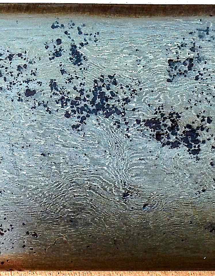

Here's a close-up showing the wootz blade of the sword starting this thread. Am I correct to see some surface manipulation during forging of the ingot to achieve a (possibly ladder-like) pattern?
