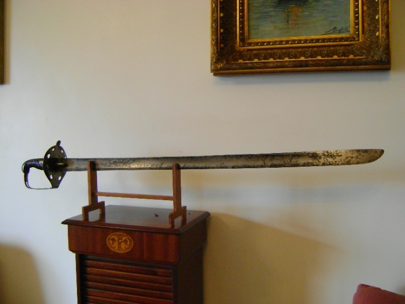

I still have to clean the rust from this piece, but i can't wait to found out what the marks on it represent.
Anyone here familiar with these things?
Thanks a lot in advance
Fernando

That is a beauty, the famed M1796 heavy cavalry disc hilt, as carried by the 2nd Dragoons ("Royal Scots Greys") at thier immortal charge at Waterloo.
The marking 'I. Gill' was of course John Gill, one of the more prominant swordmakers of Birmingham. Osborn & Gunby as seen on the scabbard was another purveyor of c.1800-10 and typically supplied M1796 patterns for both light and heavy cavalry.
In incongruent scabbard in my estimation has always suggested battlefield pickups, as these swords and scabbards were carried off fields of battle in the aftermath, and seldom were this disconnected pieces found together.
The swords which remained with original scabbards were of course with those survivors.
There is always of course the fact that many of these swords were collected into the Royal Armouries as they became obsolete in the 1820's, but it is my understanding that many, if not most of those were destroyed in a fire in the 1850's if I recall. There was a brief project at refurbishing these into other practice or cutlass type weapons I think, but cannot recall that distinctly either. It would seem unlikely that mismatches would occur in the case of weapons turned in.
The crowned 4 is an inspectors mark after the weapon was 'viewed' on acceptance for issue. Usually regimental marks are found on the underside of the disc, and include regiment numerics, rack and issue numbers.
This could very well have been one of these famed 'disc hilts' that was carried by the 'Greys' that day at Waterloo. I have seen examples of disc hilts that were indeed there, and also by this maker I. Gill.
This is what I can recall for now, but I'll have to find the references for the inspectors mark in Robson, but its buried someplace here in the bookmobile!!
All the best,
P.S. Please be ultra careful cleaning this, super fine steel wool and light grade oil...see if you can find those markings on the underside of the disc. This may be a real treasure!! Whether so marked or not, these disc hilts have become about as rare as hens teeth..so have profound value regardless.

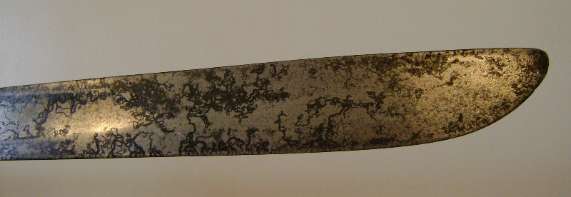

I have finished the cleaning of the blade and the scabbard (inside and outside); i was glad to find thqat the wooden plates are still there.

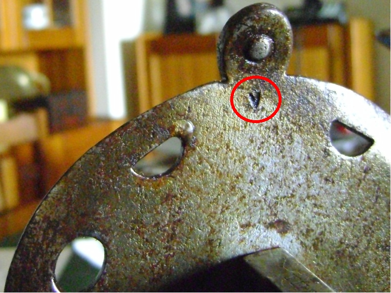

There are no more marks, except for a little V on the guard front; i wonder if this is the punction for viewed.

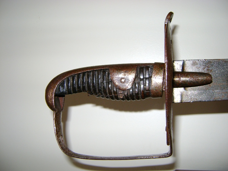

Seeing the photographs of the hilt and blade you appear to have a complete unmodified example. Having handled a few of these I wonder just how long one could wield such a sword in a battle situation. I suspect a lot of hours in practice would be needed before you could confidently handle a 'beefy' blade like this in actual combat. I wonder if, like the draw arm on longbowmen, the sword arm was noticeably more muscle intensive than its counterpart, I suppose it must have been. I look forward to more info on this most distinctive sabre.

As you've probably read on this thread I was very fortunate in being able to purchase from Fernando the sword that was the subject of the initial post on this thread. The V mark on the guard has never been satisfactorily explained and I wondered if you have any insight as to its meaning. The sword was discovered in Portugal and has been in the possession of a Portuguese family for some considerable time although it is not possible to determine how long that may have been nor the original source.

I'm afraid I do not know what the V stamping might mean. I don't think I've ever seen it before on one of these swords, or any other British sword of the period. However, of course, it is a very well known stamp on French Napoleonic swords, often found on hilts, blades and scabbards and signifying as I recall "verifie" (checked or approved). But on a British sword ?
