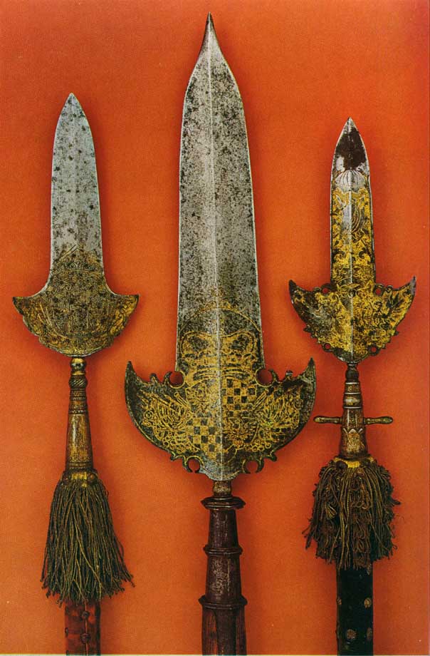

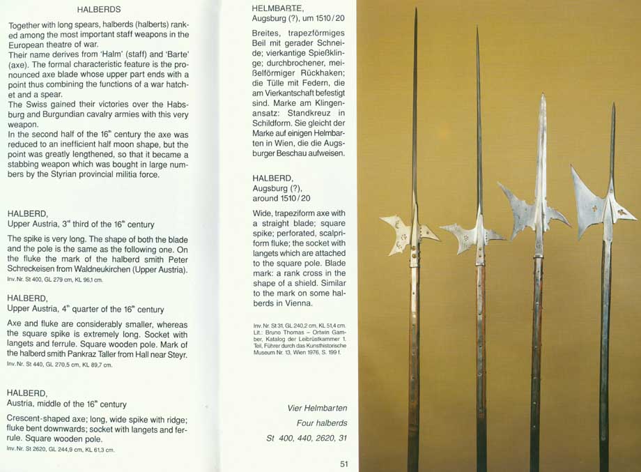

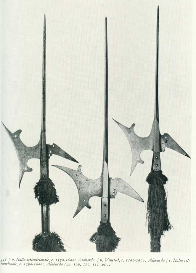

I attach images of other typical contemporary Styrian halberds thousands of which are preserved at the Graz Armoury, and of the characteristic textile decoration on North Italian pieces.

The picture of the Italian spontoons also shows the textile haft coverings and may be a reference for your partizan/spontoon.

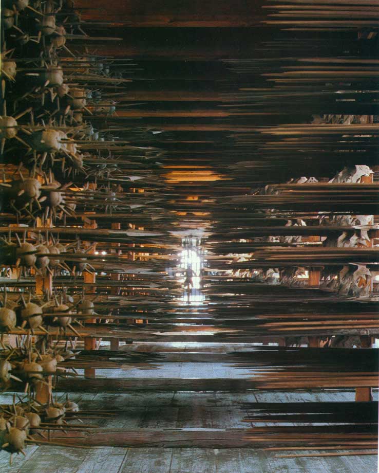

Great info Matchlock, thanks.....although this picture looks more like an 'obstacle' Indiana Jones would have to run through
Kind Regards David

Hi, David alias Katana Jones,
The treasure Indiana Jones is headed for would have to be the far away suit of 16th c. half armor then seen in the back against the light ...

In the Partisan type arms you posted the one on the far right has a cross bar below the blade. One opinion was that this was for the purpose of winding the matchcord for the firing of cannon. After seeing your images I can see that this is not possible with silk tassels so close to it. Any idea of the purpose?

I should refer to that transverse bar just as a sort of stylized quillons which, in earlier and fighting or hunting pole arms, were meant to ward off an enemy's or animal's body and stop it from sliding sort of on to the haft.
Had they been matchholders they would have been shaped somewhat like the serpentines on muskets, with a wing nut for tightening the two halves. This would, as you remarked, not be possible that close to the tassels though.
