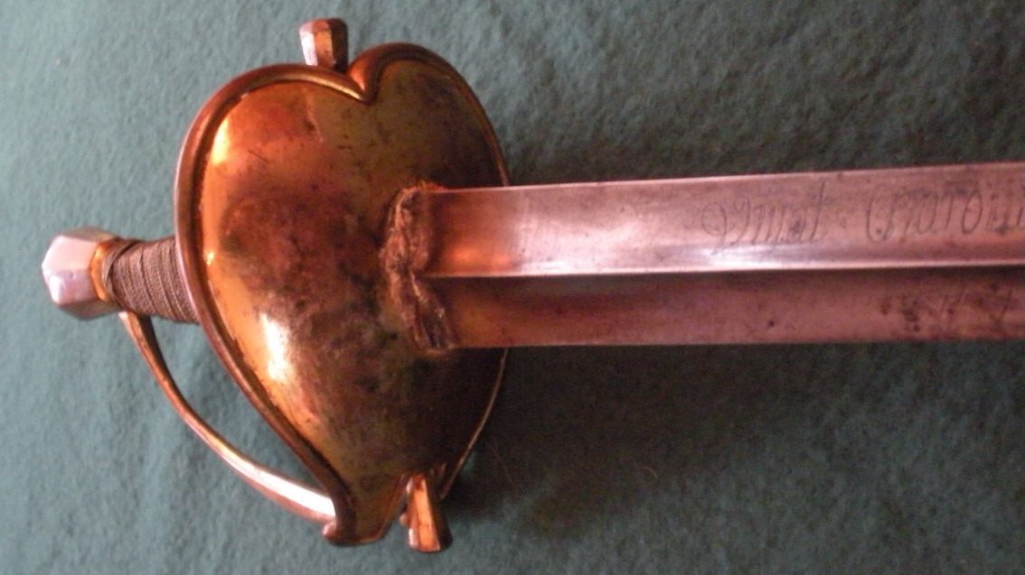

I have this sword for comment and identification please. Hilt is brass and appears that it might be cast. The blade is straight and is not sharp on either edge. It looks as if it was made specifically for thrusting. Blade profile is as shown (on both sides).
Regards Stuart

Hi Stu,
Very attractive cavalry officers 'walloon' type sword, probably Continental and end of the 18th century to early 19th. It seems like this form was widely used for military officers by many countries, so we would need to really hit the typology references to really narrow it down. The scallop shell decoration may offer some telling definition. That blade cross section seems unusual as well. More research needed of course, but this is the trail to follow in my perception.

Thanks Jim for your input. Does anyone else have any ideas please??

Hi Guys, I don't think kt's a walloon. More probably late 19th C or early 20th?
Perhaps Swedish?

Searched in some books but couldn't pin it down. I think it is military, British and probably an infantry sabre.
The gues of Manuel about age is probably correct.

Hi Henk,
Not a sabre IMHO as they were a cutting weapon. This is DEFINATELY a thrusting weapon as the edges are not sharp. I very much doubt the British heritage also, as military swords usually had the Regimental Cypher on the hilt, and also the name of the swordsmith, or at least a proof stamp.
The plot thickens!!

Hi Stu,
All best regards,
I'd say you are pretty much bang on the button Jim.
It's a Walloon, and I'd agree the simple bronze form of the guard is later, I'd have said last 1/4 of the 18thC, possibly a little earlier if I had to guess.
IMHO its not British, and without finding some marks on the blade I'd possibly lean towards it being Dutch with 2x?? added because thats just a first impression.

Hi, and thanks for the replies so far from those who have answered. Consensus seems to suggest a Walloon, but I sense some doubt.
I have had a look at all references to Walloon that I can fine in my books, and although the hilt is SIMILAR, it is not in my mind a definate identification.
WHAT ABOUT THE BLADE??
I have yet to see an illustration showing this blade profile. All that I have seen on illustrations of Walloon have fullers, or are what I would call standard blade profile.
What do you think?

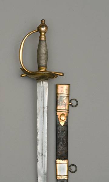

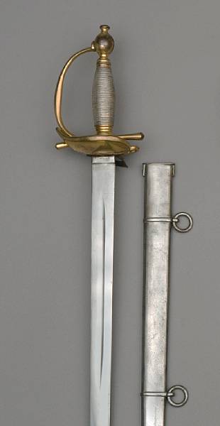

Hi All,
Three British 1796 Heavy Cavalry Dress Swords all slightly different hilts, blades and scabbards. As a dress sword the blade profile may not be just as important as usual and could possibly be an older 'family' blade remounted.
Norman.
