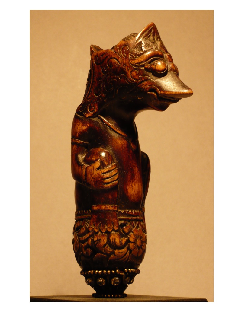

BluErf
Your nice ivory hit could be from Tegal (of course Cirebon style)... but there is something in the form (Nyamba ???) that tell me it could also comes from the area that runs from Madura till to the Jawa's cost in front of Balì.
To explain better i put here a photo of a hit that, i suppose, comes from this area.
About the blade IMO it could be done in Madura

Hey Marcos,
That's a mighty interesting hilt you have!
Pg63 of Kerner's big book has a set of 4 pics of hilts attributed to the Nyamba style. Kerner wrote (ok, we have take with a pinch of salt) that Nyamba hilts were known only as metal hilts, and those 4 examples had almost a comical look. Yours had the same features, but a more dignified look, and not covered in motifs.
Though one question - is Nyamba a city or region name? Was trying to google to find out, but they led to keris auction descriptions and not much else.
Perhaps Tunggulametung could help throw some light on where my hilt was acquired?
