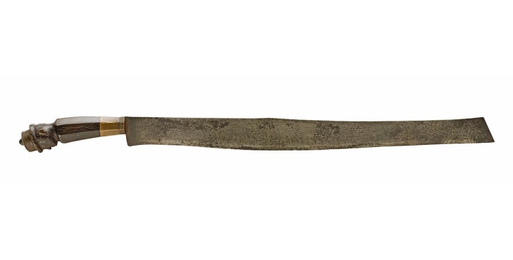

At the recent Macao exhibit, there's a similar sword [pic below] described as:
212. Luzon Tabak
Period : Post 1900, Katipunan Era
Hilt : Carved carabao horn in the shape of a human figural head with hat/cap. Hilt with octagonal brass ferrule and cap with peened tang construction.
Blade : Long clipped tipped blade. Typical blade shape used by Katipuneros.
Scabbard : Not available
Origin : Southern Luzon, Batangas
Overall Length : 65.2 cm [25.7"]
Blade Length : 50.2 cm [19.8"]
Handle Length : 15 cm [5.9"]
Scabbard Length : No Scabbard
