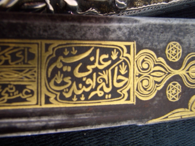

Hakim Ali Besim Efendi (this is the name of the owner, the title "Hakim" has two meanings, 1) judge, magistrate 2) ruler, governor)

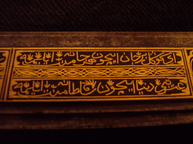

Ey gönül bir can içün her cana zillet eyleme
İşret-i dünya içün sultana minnet eyleme
Do not hold oh heart all the lives in contempt just for a life
Do not bow to the sultan for the pleasures of mundane life

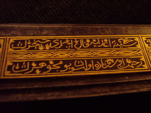

Sine-i 'adaya fal açtı hançerin
Rahmet üstada olsun bu mücevherin
Your dagger opened the bossom of enemy for soothsaying
May God Bless the master of this jewel (meaning the yatağan, I believe)
This is a very interesting part but there is also possibility that I'm not interpreting it correctly. Soothsaying by looking at the entrails of animals was a pagan practice, it is interesting if the inscription refers to such knowledge.

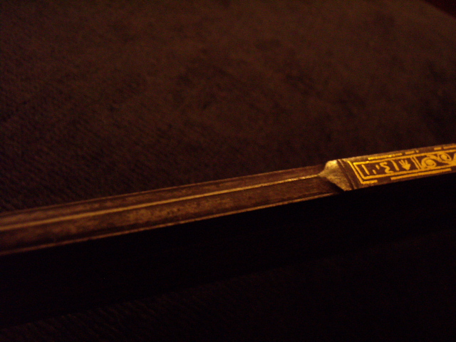

1241 (1826)

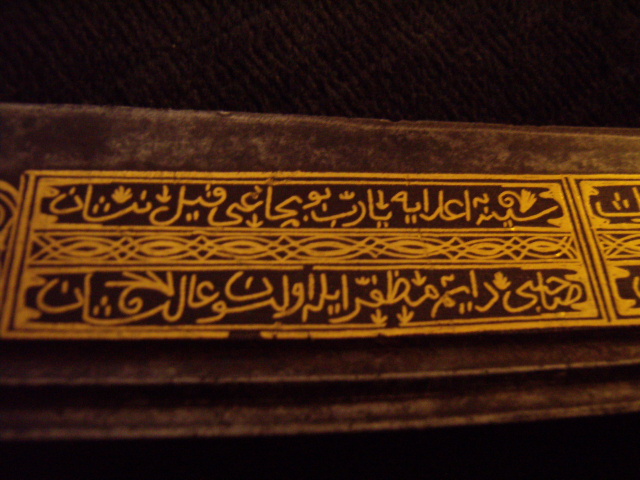

sine-i 'adaya yarub bu bıçağı kıl nişan
sahibi daim muzaffer eyle olsun alişan
Let this knife be a sign on the bossom of the enemy
Let its owner be glorious and high in fame

Originally Posted by Zifir
1241 (1826)
The koftgari looks to be in very good condition if it's nearly 200 years old.
Is it possible this sword was made to memorialize the massacre of the Janissary corps in 1826 by Mahmud II?
