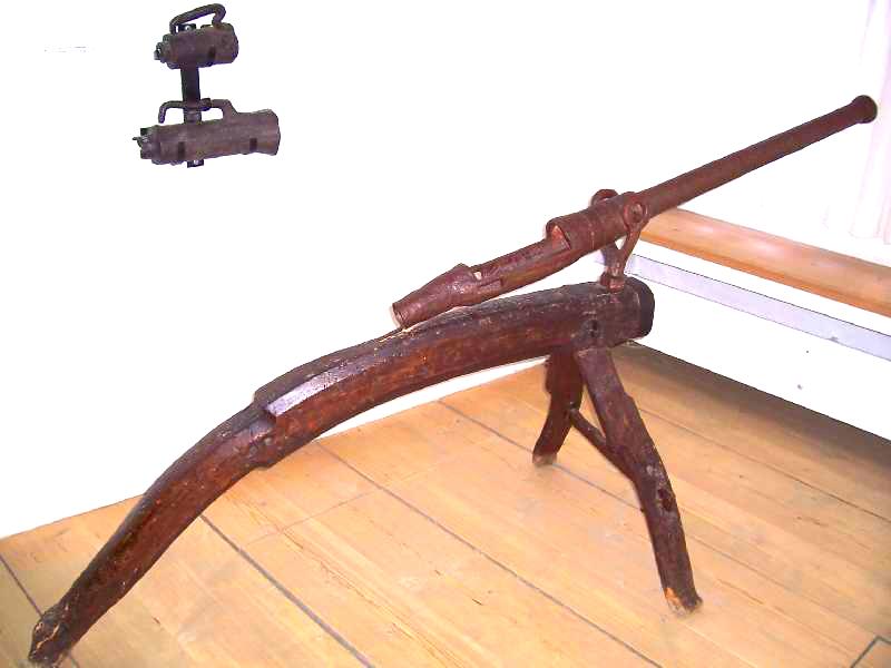

From top:
- an extremely rare wrought iron chamber for a small breech loading falconet (Kammerschlange), ca. 1450, length 23 cm, bore ca. 3 cm; yet in my collection, but for sale as I do not collect cannons any longer
- two views of such breech loading cannons: the first in the Historisches Museum Berne, ca. 1460-70, the carriage an early 20th century reconstruction; the second a line drawing from the Maximilianische Zeugbücher, ca. 1500

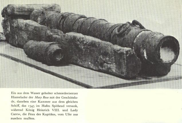

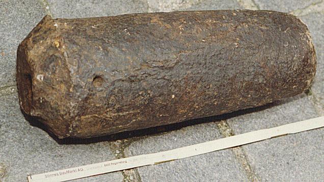

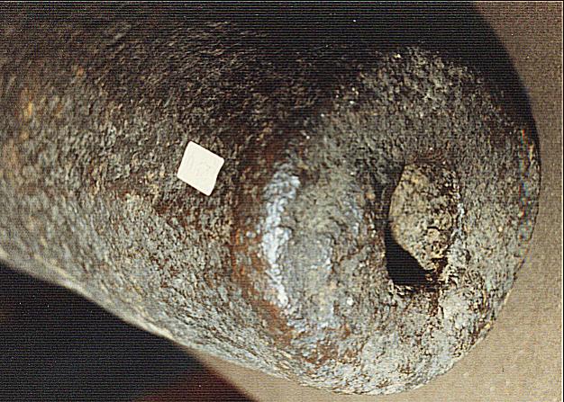

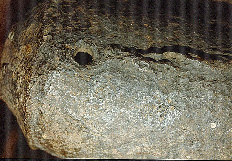

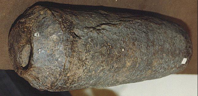

I sold this a few weeks ago:
46 cm long, bore 4 cm, weight 54 kilograms (!) - remember it's just a powder chamber that was closed by a wooden plug. The bullet(s) were shoved in the barrel from the rear before the breech piece was put in and secured by wooden or iron wedges.
It originally belonged to a big breech-loading cannon like the ones found on the Mary Rose of Henry VIII that sank in 1545 - see b/w illustration.

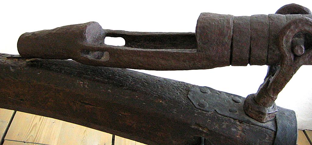

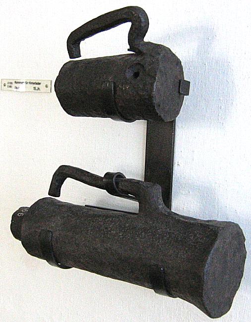

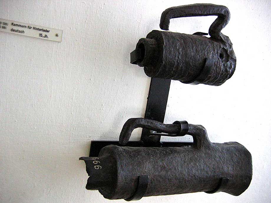

Default Breech loading pieces, mid 15th century
In the Bayerisches Armeemuseum Ingolstadt.

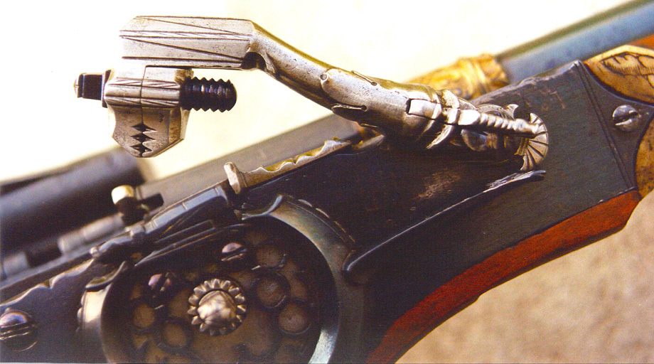

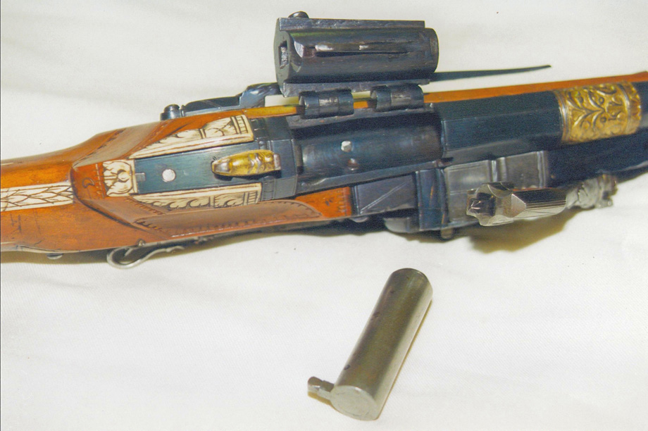

Default Iron "cartridges" for early breech loaders

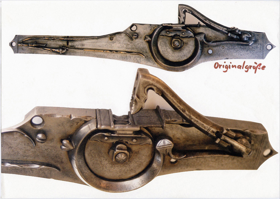

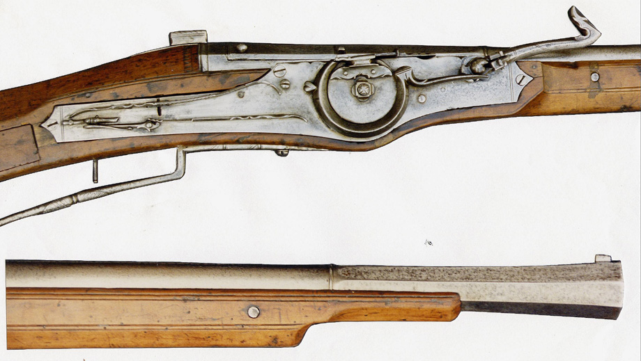

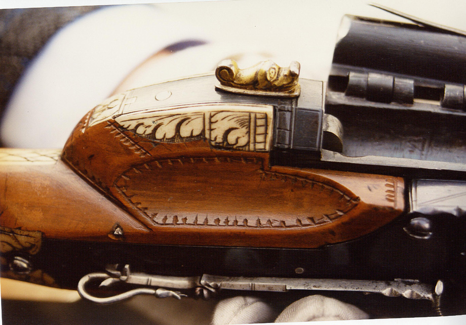

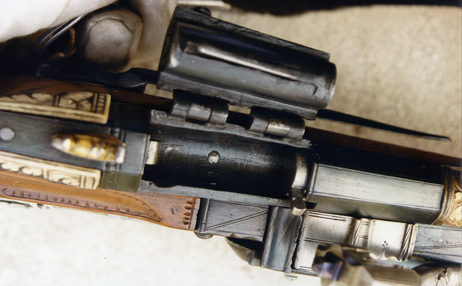

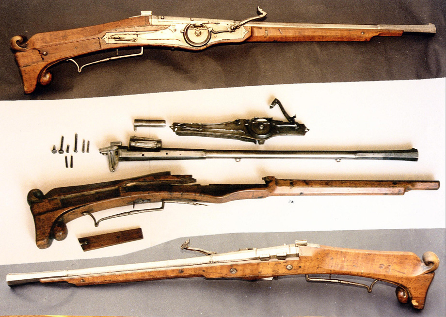

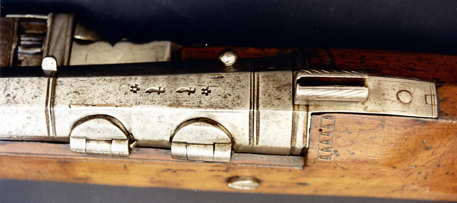

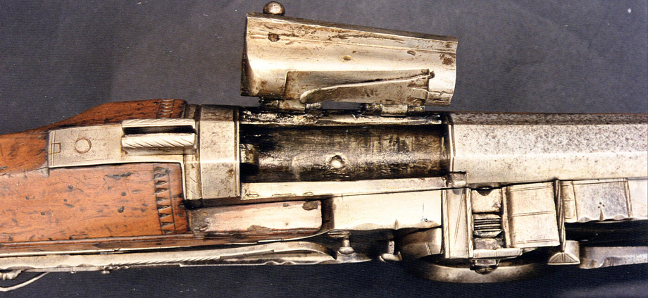

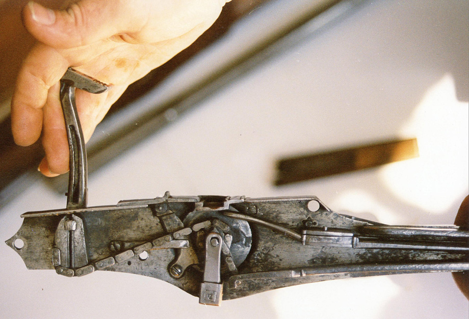

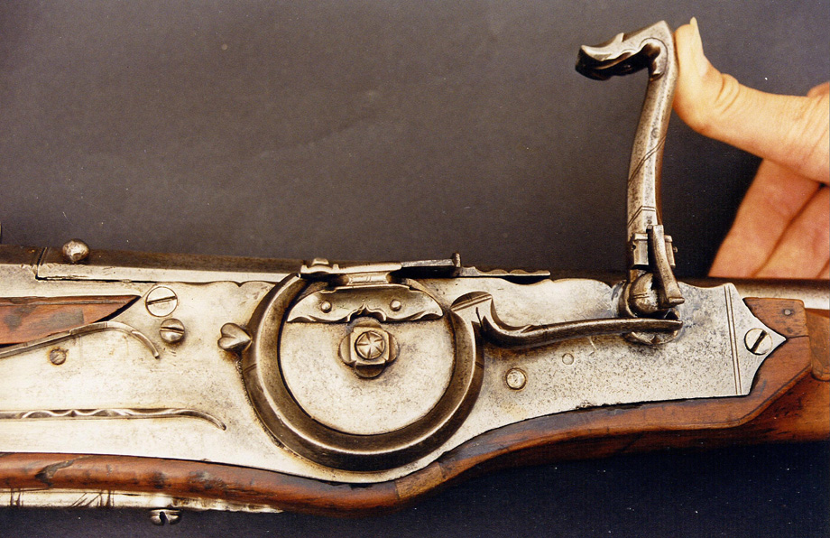

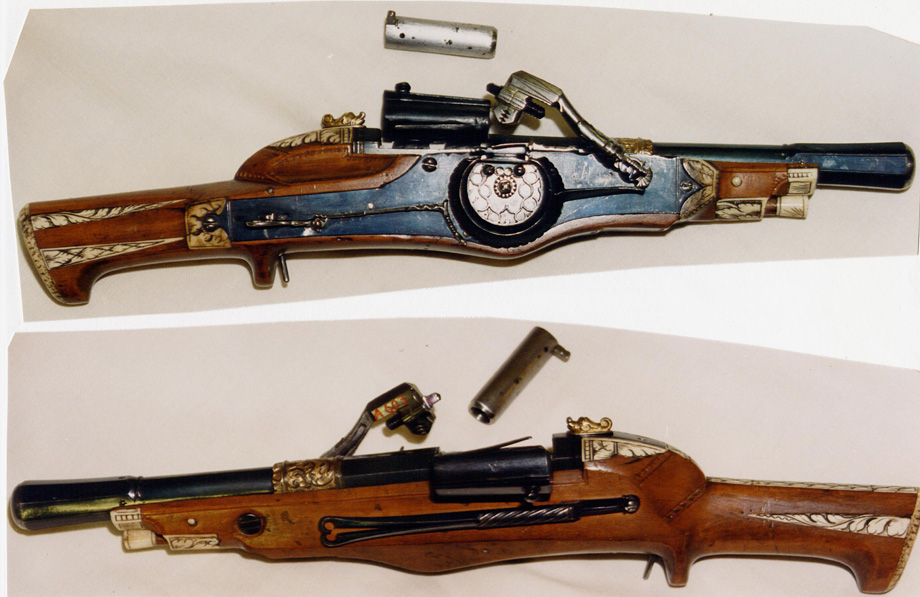

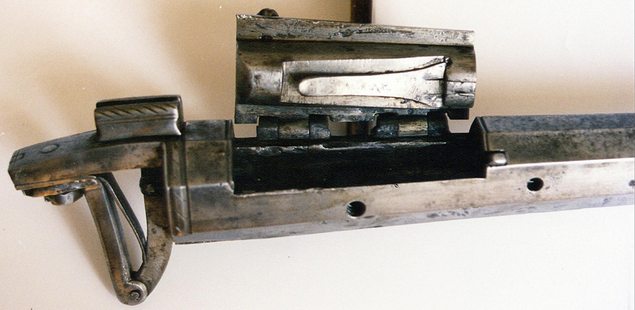

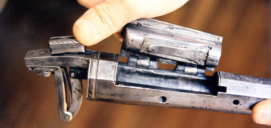

Richard,
No one could be any happier than myself about your shedding new light on one of my older posts (I joined the forum only two months ago).
Actually, the bolt action breech loading system has been employed with wheel-locks at least from 1540.
I attach some images of a combined snap tinder lock and self spanning wheel-lock breech loading harquebus (the snap tinder holder and iron "cartridge" now missing), the barrel bearing the double falchion mark of Christoph Arnold, Augsburg, ca. 1540 (an almost identical piece in the collection of Schloss Grunewald near Berlin bears the same marks together with the date 1540), and a short wheel-lock breech loading harquebus or pistol by the same maker and of identical date. I got allowed to take the photos of the latter in the Imperial Vienna collection 20 years ago. Its exceptionally fine condition strikingly illustrates the original impact of contrasting colored surfaces in those mid 16th century pieces!
You are doubtlessly right in assuming that such a costly and refined system would only have made sense if used together with pre loaded and readily primed interchangeable iron "cartridges". Only in wheel-locks the pan was an integral part of the lock and had to be primed manually prior to each shot.
Interchangeable breech loading with cannon was in use since at least mid 15th century. It took some time to get applied to harquebuses, though.

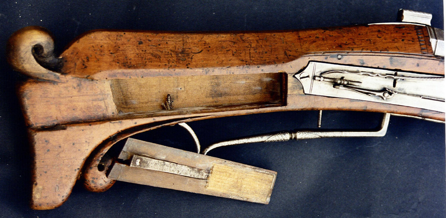

We know of some very rare breech loading break down action flintlock guns of early to mid 18th century date whose sets of spare cartridges are still contained in a leather collar, each of them equipped with its own frizzen and pan - perfectly ready and primed!
I enclose some views of one rare sample of such a rifle, ca. 1700 but re-stocked in mid 18th century, together with its original cartridge collar containing 11 numbered and rifled (!!!) iron cartridges, with number 12 inserted in the breech. I was granted to take the pictures in the reserve collection of the Princes of Thurn & Taxis, Regensburg/Bavaria, 26 years ago.
In all probability, mid 16th century "cartridge" containers for breech loaders looked very much the same.

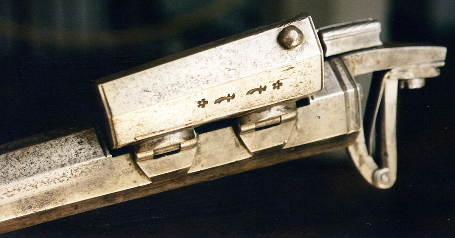

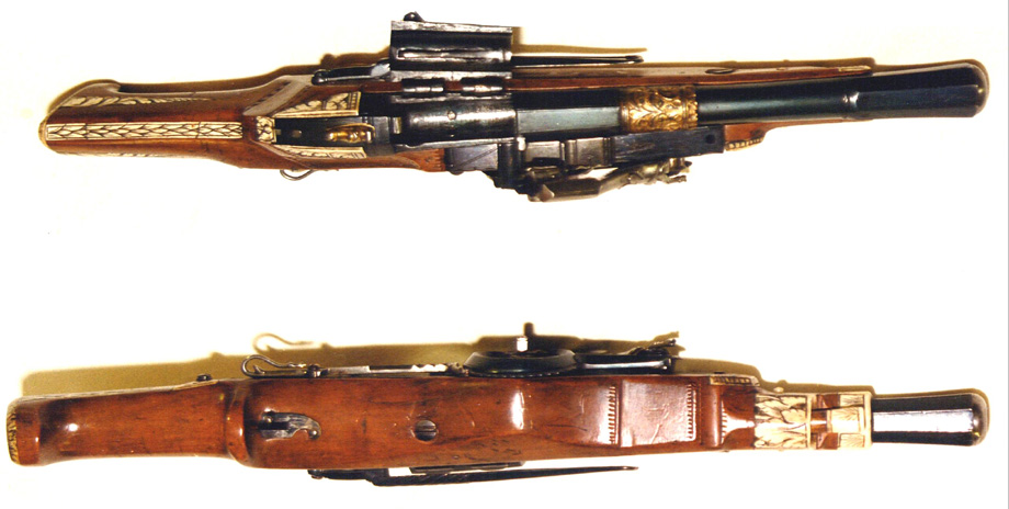

Old 20th November 2008, 07:22 PM   #6
Matchlock
Matchlock's Avatar
Join Date: Sep 2008
Posts: 4,310

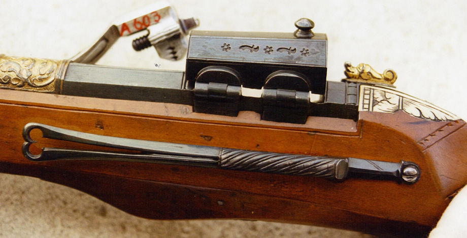

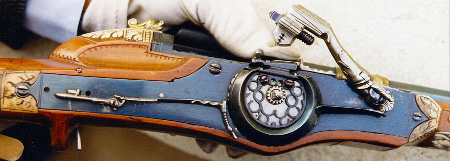

The extremely fine and perfectly preserved Vienna breech loading wheel-lock pistol, like the harquebus posted above made by Simon Arnold, Augsburg, ca. 1540.
