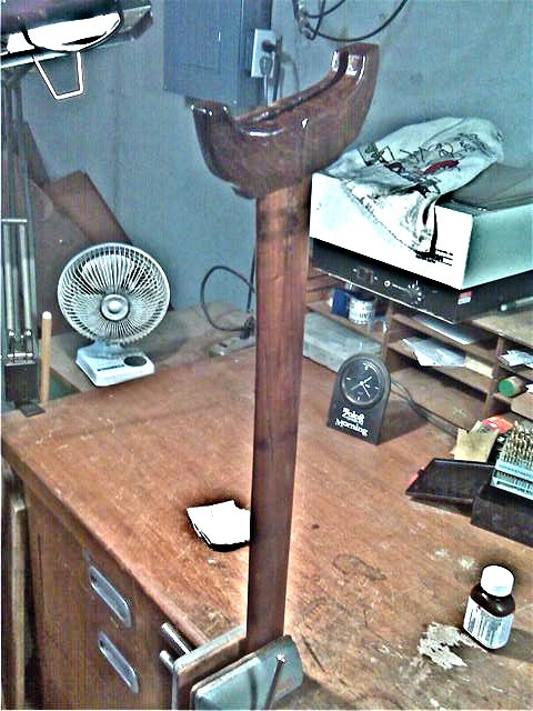

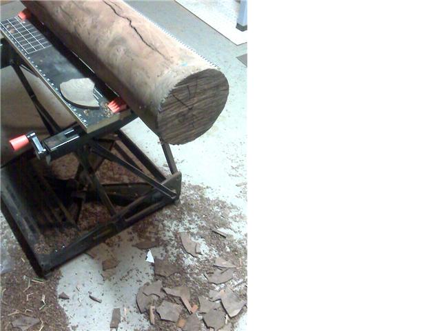

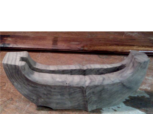

The bigger process was the wranga. I had to cut a chunk of burled walnut from a log and carve it out. Then I stained it to better match the hue of the scabbard patina.

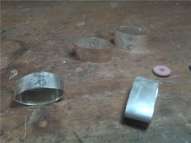

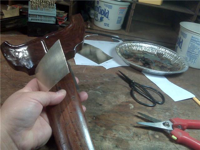

Finally, I took plain sheet silver and wrapped the scabbard, making silver bands and placing them on the scabbard.

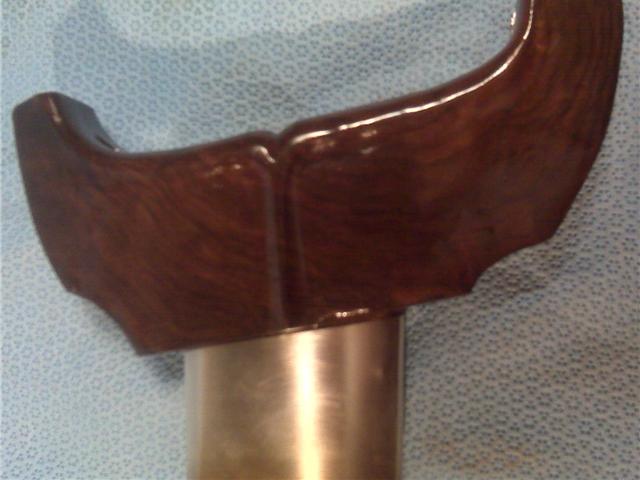

Here is a close up of the finished wranga:
