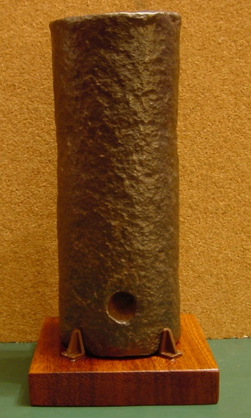

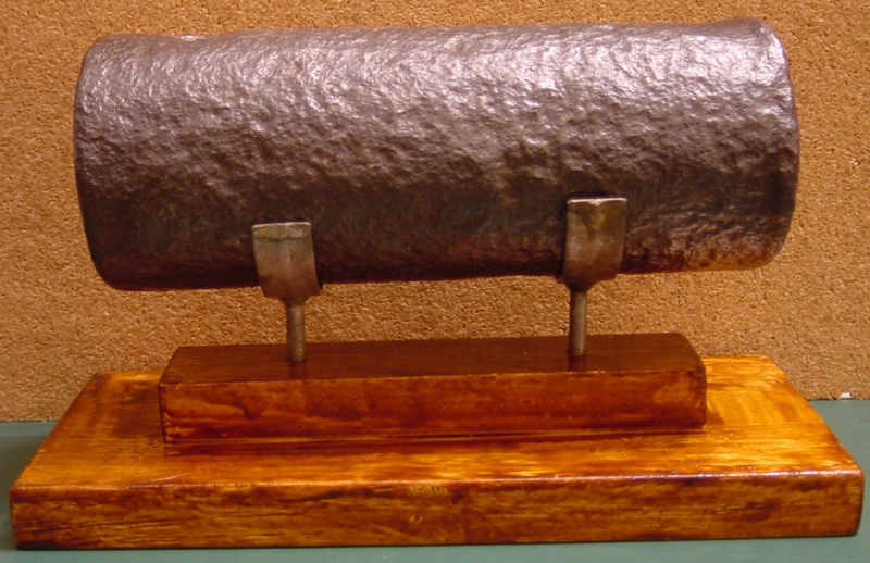

I wouldn't know on what tipology tis small cannon falls ... assuming i can call it a cannon.
We can say the previous owner didn't need to clean it so much ... despite most probably being full of rust.
Height 18 cms (7"). Diameter 7 cms (2 3/4"). Bore about 4 cms. (1 1/2").
Weight around 3,5 Kilos (7 pounds) ... the kitchen scale couldn't make it right.
A thin sleeve is lining the barrel, most probably a reinforcement (steel) to resist wear.
The seller says is portuguese, as he bought it in Portugal; i have no reason(or knowledge) not to beleive so. He also says it is from the 16/17th century, as it was the period this type was used, but i wouldn't know.
Coments on these particular assumptions and also in general will be so much welcome.

Hi Fernando.
Do you think its a hand-cannon?
I've no experience of sleeved cannon barrels, but many barrels are made from a sheet which is rolled around a core (which is removed of course), I've only had experience of this on much later weapons, but the principal would be the same and oxidisation could certainly cause the inner layer to look similar to your piece.
BTW, I would think it was earlier if its a hand cannon.

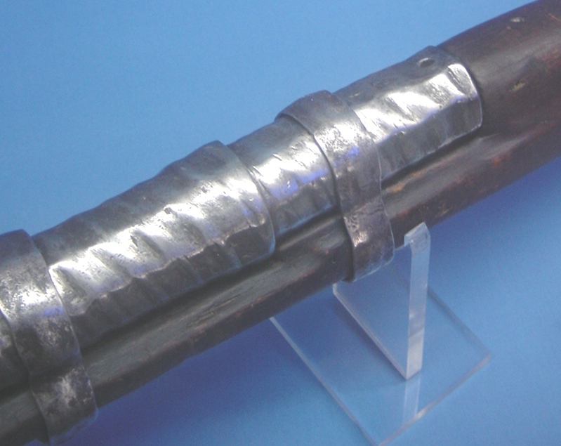

interesting item, this picture of a hand cannon seems to also have that 'inner lining'

My knowledge of older firearms is limited but I am of the opinion that this must be a signaling mortar of some sort. A cannon that would be used to fire a projectile in any way effectively would have a much smaller diameter touchhole, even taking into account wear and tear and corrosion over the years, and probably a longer barrel to bore ratio. The size of the touchhole on this example would be more suited to, as you say, a fuse e.g. hemp impregnated with saltpetre or a thin tube filled with black powder. Hope this is of some assistance.

You must be quite right. I have just come to observe that the recipee for signal cannons (mortars) is powder, plug (no ball) and fuse cord.

I think Atlantia may be right about your piece. It may be an 'optical illusion' but there appears to be evidence (on the surface of the iron) that bands once held the cannon to a handle (see pictures below). I know the general agreement is that this is a signalling 'device' (and it probably is) but if a 'maritime' item ..this would 'double-up' nicely as a grape shot/ 'shrapnal' hand cannon ...useful for clearing the 'decks'. Most Navys of the time, would not want to laden their sailing ships unnecessarily (little space and the excess weight would impede speed and manoeuvrability) so items tended to have a 'dual purpose' ....or in your cannon's case a 'duel purpose'
Kind Regards David

David does have a good point about dual usage as both a signal mortar and mounted hand cannon. Ships did, as mentioned, have space issues when it came to armament. Small mounted swivel guns (miniature deck cannons) were popular for this purpose and likewise, some literature supports the fact that even larger mortars (the portable Coehorn, which fired an exploding shell filled with little grapeshot) made it on board ships. The reason I had initially questioned it as a hand-cannon was due to its short length. However, for shipboard use and "clearing the deck", it wouldn't need to be very long (same reason blunderbus were so popular; close-range spread of projectiles). One last comment, though. Is there any possibility that the band-pattern we are seeing might have been bands encircling the cannon to strengthen it? As items on a ship became worn, repairs were done to naturally extend their working life, if possible.

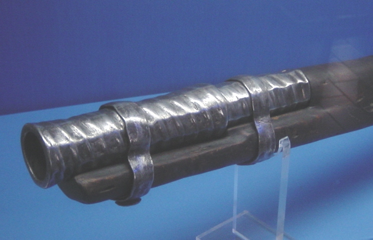

Some more examples of hand cannons.

i feel it's a hand cannon myself, the rough bore would not be unusual after all these years of relative neglect and corrosion, probably was a bit more regular when 1st made & used.
they'd use pretty crude powder, grass wadding and convenient sized rocks for ammo, iron and lead shot is a much later application for sophisticated matchlock and later wheel locks when bores could be controlled better during mfg to reduce windage...
additionally, it was expected that the odd hand cannon or two would blow up (variance in powder quality, payload, corrosion due to poor cleaning, poor craftsmanship techniques, double loading*, etc. one reason fro a LONG stick. the bands not only held it to the stick, but kept some of the chunks of a burst barrel from zapping the shooter or those alongside.
the short barrel while not allowing maximum velocity, would give less chance of a shot sticking or jamming and blowing up the device, while still producing a satisfactory BOOM, smoke and such to frighten the horses, and if really lucky actually have the projectile hit and damage an armoured man.

This gives me some self confidence, in my endeavour to change the type of stand for the piece. I started by making a square base, to put it upright, after the signal cannon assumption. I am now rehearsing a rectangular base with two forks, to relate its position to the later commonly agreed hand cannon posture.
... but i will not through away the first version ... just in case

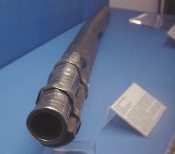

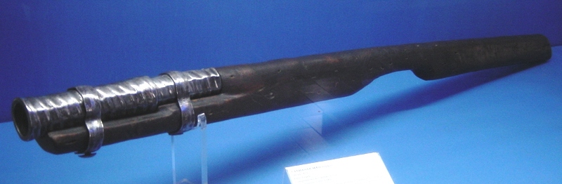

This is the replica of a XIV century hand cannon at the Lisbon Military Museum ... where pictures are not allowed
The barrel has 27 cms. and is made of hot welded staves. The whole thing, barrel and pole, measures 1,24 mts.
The tag doesn't mention its caliber, but we can see it's quite a large one, close from my example, i would say. Also the touch hole is quite significant in size, meaning that after some shooting and degradation could well become as large as the one in my specimen.
The legend in the tag confirms that these things were handled by two men; one holding the pole under the arm and pointing the barrel mouth to the enemy lines and the "bota-fogo" (an expression that became legendary), a guy with the slow match, to detonate the device. Also as already aproached here, the accuracy of the shot was very limited, but the psichologic efect of the noise, the black smoke shadow and the smell of burnt sulphur, provoked in the spirit of medieval man the conviction that he was in the presence of devil's work.
Fernando
