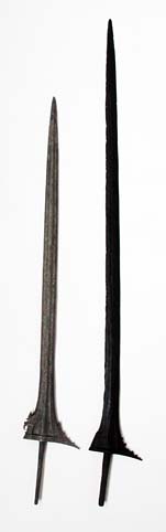

We – in Java – call kerises such these, as Bangkinang (the longer), and Bahari kerises (the shorter one). But of course some of you know better than me what they really are. The shorter keris with specific "greneng" measured 42 cm (not including the pesi) and the longer is 54 cm long. More information on these kinds of keris, please?

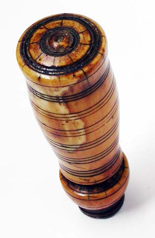

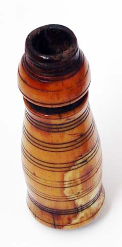

The Malays of Sumatra & Peninsula call these dapors as keris Penyalang. Some would simply call them keris Panjang.
BTW, are the hilts original to the blade, or are they much later additions? I never saw this type of hilt in a keris Penyalang / Panjang before.

- based only on length; yes, the short one (LHS) can be called 'bahari' and the longer one (RHS) a 'Bangkinang'
- the Bangkinang was developed in answer to the Portuguese rapier, mainly for use on horse-back (read 'pony-back'). So it was straight (no eloeks/waves) and concentrated more on steel content than pamor/damascene patterns). Also, the Bangkinang did not have a tonggong/back-bone). Last of all, the bedor/tang had a flat section to prevent rotation.

Sumuhun (thanks -- in Soenda dialect), kang Amuk... Once again I post pics of the blades but without hilt. The pesi (or 'bedor' in your term) of the longer keris is not flat as you mentioned. But round -- though bigger than the normal kerises, even a bit bigger than Balinese blade (but not longer).

Dear Penangsang, the hilt belongs to the longer one. It is not ivory, but perhaps old 'duyung' teeth. I got the 'keris panjang' with such hilt (keris Bangkinang in Javanese term -- Bangkinang is a name of a small place in the southwest of Pekanbaru Riau, Sumatera to the direction of Padang, Sumatera Barat. This place, believed to be the 'origin' of such keris model or at least popularized from this place before 19th century). The style of sheath is Palembang, but the wooden "gandar" (blade section sheath) is no more original. Maybe broken, and changed with trembalo wood gandar..

I was talking about the Bangkinang keris. At the time, Bangkinang was an even smaller place then it is today. It was a very isolated place (dense vegetation etc.) and formed one of the 'rantau'/outer-regions of the Minang empire (similar to the 'kejawen' areas of the Jawa empire). Most travelling was done on horseback.I don't believe it would've had a navy, so I don't know what navy you mean..
Perhaps I used the wrong words: '......the Bangkinang was developed in answer to the Portuguese rapier, mainly for use on horse-back (read 'pony-back')...Last of all, the bedor/tang had a flat section to prevent rotation...'.
I meant that the shape was influenced by the rapier and its length more suited for horse-back. Also, I meant that the tang was round, but that only a section of it had been flattened (e.g. in the middle or at the tip).
