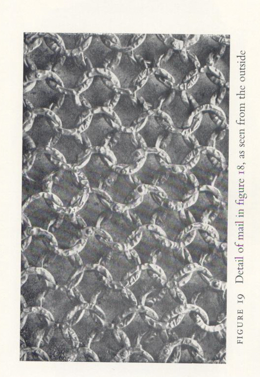

ausjulius, you might find this stuff interesting. This book was printed 1963 then the outlook on what Africa could produce was a little different from today. Every other possible source of origin is suggested but also questioned. There is no open mention of an African origin, however I read that this is an open invitation for contemporary collectors and students to take further. It is interesting that the weapons of Persian form and etched with script are made in Africa. Some infidel weapon forms from the forests of central Africa have indeed be Islamized by such decoration. Read these extracts from "Nigerian Panoply arms and armour of the Northern Region" We are looking at Islamic city states not mud hut villages.

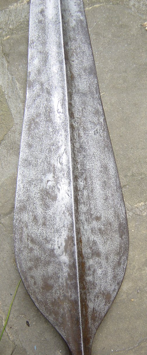

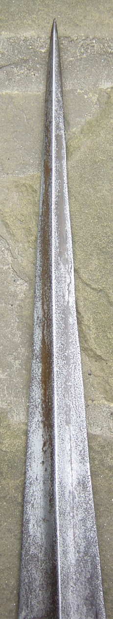

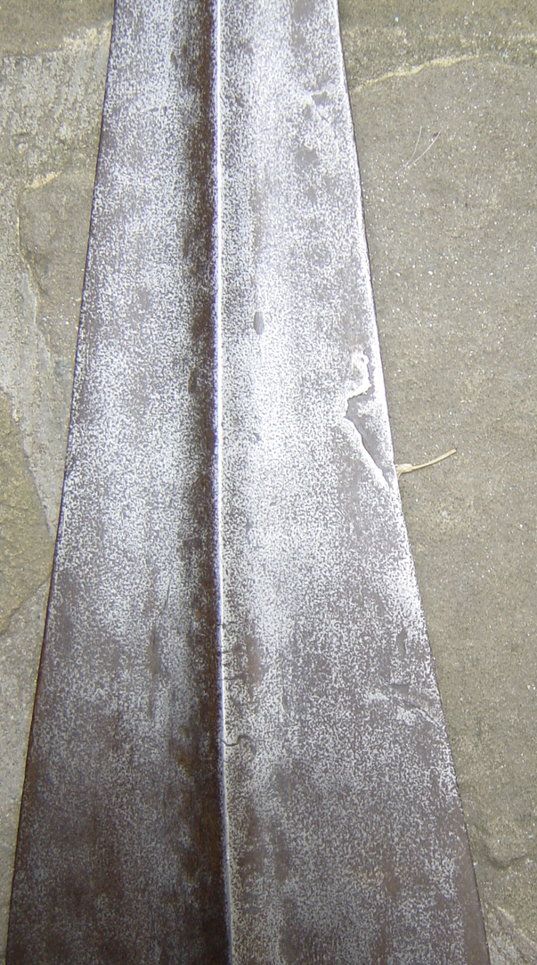

Old 13th June 2008, 06:40 PM   #5
Posts: 5,986
Default Thousand km south and east

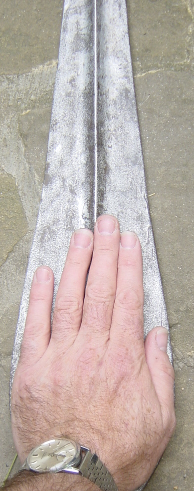

If you down load these pics and examine magnified. You will see a form of layering. Believe me this is tempered. I am sure that if I were to etch the surface, patterns would appear but only incidental. The spine of the spear is over 1cm thick. I think one has to develop more of an eye with African pieces
thanks yes, and in southern sudan mail like this was very common, but these people wer einfluence and dominated by small numbers of middle eastern traders,, introducing new things and ultimatly dominating the society in these areas.
i was after indiginous invention.

I'll start with the mail shirt posted earlier on this thread. It's ceremonial.
A common mistake made by many when viewing mail of this type is to assume that it's functional. Mail of this caliber was never meant to see combat. This mail shirt is a talismanic ceremonial expression. A tell tale sign of this are the Arabic inscriptions placed on every single link. It is a tribute and a sacrifice of one's time and effort to show their religious devotion and was worn on ceremonial and festive occasions. Real functional combat mail worn by the Sudanese was much more closely linked.
