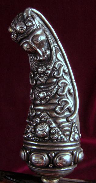

What is the kocet-kocetan hilt?
Where does it originate from?
What are its meaning and symbolism behind this hilt form?
I'm a bit puzzled about this kocet-kocetan hilt "kurisi"? [ link ]
Is it a local name, for this type of hilt form? Hmmm...
This are the info that I've seen... from Dominique Buttin's site.
"It is an insect as can be seen by its six legs. Some sources identify it as a stink-bug.
The story behind the Kocet-Kocetan is the following: The beetle (or bug) Batara Karpa was born out of an egg which was laid by his mother Dewi Winata, a bird-demon, who was married with the Rishi Kasyapa, a tortoise. Three other animal gods were born out of this marriage: Batara Garuda the sun-eagle, Batara Agniya the marten and Batara Kowara the snake.
So the xenomorphical shape of a beetle is a very old motif and probably has a very deep mythological background.
The Kocet Kocetan equals Batara Karpa. That is why the shape of it was only permitted to be used by the Brahman, the Hindu priestly caste.
It is believed that the kerises of the Brahman do have magical powers and are able to create `Holy Water`.
But some of the hilt's head does looks like a horse?
Any ideas, suggestions, comments, objections... etc.

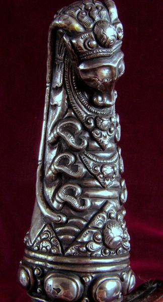

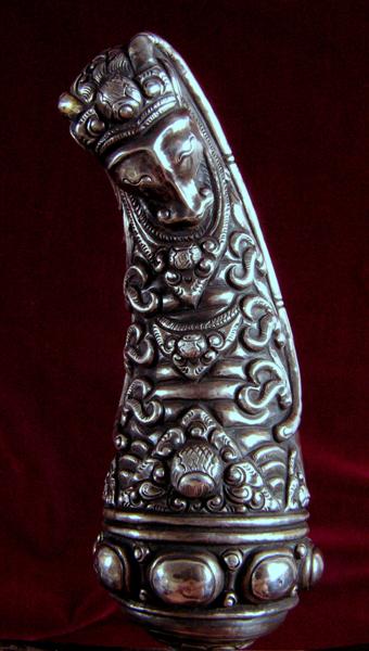

Alam
Before i always thought that this hilt was a horse.
Then, ...reading Kerner's books and other books i ear "Kocet Kocetan" but If i speack with Bali people about this hilt they don't seem to unerstand well what is "Kocet Kocettan"
Sometimes the hilt has 4 legs (horse ?) more times 6 legs(insect?)
The face of the subject is very ducky indeed

Marco, if shown the hilt, what do they call it there?
Looking into Kerner's Keris-Griffe,
Pg 86, G116, show a mantis with 4 windows and 2 legs;
Pg 87, G120-121, shows an insect head with 6 legs
Pg 87, G123, shows a horse head with 8 legs.
Looking into Tammen's De Kris 2, on Pg 28, described as 'Kocet Kocettan'... possibly an earlier representation, with it's head, looks beak-like.
Pg 29, described as 'Kocet Kocettan','Boktor'... looks like the 2nd picture I've posted but without any gold decorations.
Pg 31, described as 'Kocet Kocettan', 4 legs, neck and belly ornament; head with tiara.
Pg 32, described as 'Kocet Kocettan' modern version, where the head is more horse-like, legs(?) hardly visible (if any).
It's as though I'm repeating what Marco had just said.
So now I'm confused.
Does 'kocet kocettan' have many variants?
Does anyone knows what 'kurisi' means?
Marco, your duck, does look horse-like...

Marcokeris
Marcokeris's Avatar
Location: Italy
Posts: 928
Thanks a lot to all members for great full explanatons.
Now i have no doubts: it is a insect!
