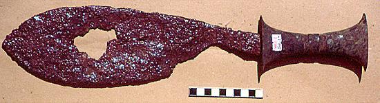

I understand from Bob Hudson that leaf-bladed two-edged daggers have been excavated at Pyu sites such as Halin, which precede the Pagan era. Its not clear to me whether the swords are from the Pyu era, or from the later Bagan era (I have a report of the excavation of Halin somewhere, so maybe I can find that out). The Pyu were also a Tibeto-Burman people, so that might be some indication of what a was in use by that group of people, but there is no way of knowing. I have come across references to excavated swords from Pagan-era sites, but never with any photographs or descriptions.
