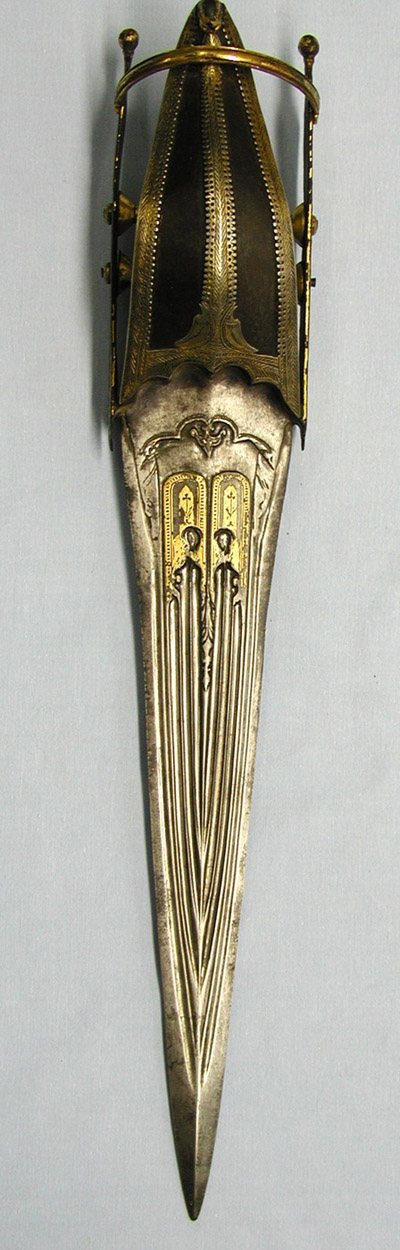

Here is a south Indian katar, most likely from Tanjore. Notice that the fishes have eyes on both the inside and the outside of the side guards. In the middle of each of the two cross bars, a steel ball is rolling. Under the hilt you can see two fish and two peacocks. A few of the seven little wheels in between the two cross bars can still turn, I guess the rest are rusted.

This katar is one of the nicest pieces of chiseling in a katar to date that I have seen. If you get bored with it email me. Great piece
Old 12th February 2007, 12:09 AM   #3
Posts: 10,867
Truly a most beautiful katar, and as noted, almost certainly from Tanjore.
Elgood ("Hindu Arms and Ritual", p.162, fig. 15.39) notes 17th c. examples with the twin humped bars separated by connecting pins with small wheels, and suggests they are from the 'Tanjore school'. The flared sidebars which enclose panels of beautifully chiselled iconography are also characteristic.
The beaded bordering around these seem distinctive and unusual as not seen in most examples shown in references. This beading seems to reflect that feature often appearing in Indian art in depictions of figures wearing strings of pearls in miniatures etc.
The pair of fish is theologically auspicious in India of course, but the theme in the motif in the sidebars seems possibly to associate to the Pandyan Dynasty in early Tamil Nadu, whose royal emblem was the fish. Elgood (op.cit.p.134) notes that "...fish are frequently chiselled as subordinate decoration on the earlier Tanjore arms".
The fish, and notably, the peacock, are often featured in Tamil poetry.
The blade with triangular striated form seems to correspond to early form associated with Vijayanagara from about 16th c. and later supplanted by the influx of European blades.
I am curious about what these wheels in the grip represent, and it does seem significant that they do number seven, an important number symbolically. I think you once mentioned prayer wheels and I wonder if that might have any association. It does not seem that they would have any practical purpose (though it is curious they are mindful of the little scrolling wheel on my mouse here as I write this !.
Any thoughts or other examples of these wheels in the grips of katars?

Your Katar is a beautiful piece .... Is it worth trying to soak the Katar in an oil bath for a few hours.....to 'free' the rusted wheels.

When I examine the wheels closely, some of the wheels will never turn, as they seem to be almost welded together with the cross bars, but I will try with some WD40 and see what happens. On the left picture you can see that it is the two wheels to the right, which can turn. Before I got it, someone had treated the blade with acid, probably due to heavy rust; fortunately the hilt was spared, as it took me endless hours before I had removed the dull grey colour, left from the acid, on the blade.
