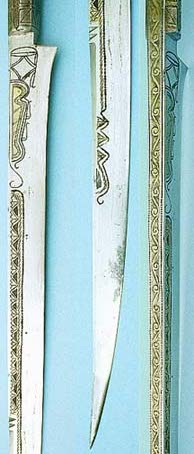

I just stumbled over this discussion on SFI: Lots of pictures... a link to a website with pictures from said museum...it shows a most surprising thing. A curved flyssa (isn't it?) among various weaponry. The pommel is sort of a mix/transition between the kabyle camel and the caucasus lobe. The captions are in Russian, so perhaps some of the members knowledgeable in this language can translate...
Dear Lord, it's like an ordynka...what is this, the missing link??

Damn! I'll be dreaming about this thing tonight.
Some of my rants:
- It's got the zoomorphic pommel but it's different from the camel/dog/eagle-style usually seen. It looks more like a lobed pommel as on shashka. It isn't as "cubic" as usual flyssa pommels. Then again, what is "usual" ? I have seen relatively few examples and never in hand...
- It's got what looks to be an octogonal handle...but could be hexagonal
- the haxa/octogonal drum between the handle and the blade is a bit weird, but looks all right
- It's got inlaid decoration, it looks like classical designs, as seen on the pic from Oriental Arms
- It's got the indentation into the spine of the blade, that are seen on flyssa
So to me that is a flyssa made by kabyles or according to kabyle designs, but...it's very very curved, and it doesn't have a deep belly...it's like a shamshir. The smaller knife-sized flyssa are sometimes curved, but not at this scale and not to this degree. Has anyone seen this before?

Could it have simply been modified? A regular long flyssa bent in a curve to the whim of a new owner? Would such deformation affect the integrity of the blade and its decorations?

the Flyssa is slightly unusual...IMHO....it fits the overall description of one. Nice sword either way. As to the curve being formed from an originally straight blade......as the sword is forged, the curve would have been formed early in the making of the sword. To form the curve on an already forged straight blade would be more trouble than its worth...I believe it would be easier to forge a new blade.
The one that caught my eye is the wavy edged Shamshir....I am wondering whether its wavy edge enhances its 'cutting abillity' when used with a 'slash' type blow.

The exhibition describes it as an "Uzbeki Shashka". Very strange. I am quite uncertain about the validity of IDs: there is a typical Qajar Revival sword with a very usual point, described as Zulfiqar
However, the ax is an Uzbeki Ay-Balta, the shamshir has a collar of turquoise on the throat of the scabbard ( you even can see a part of it in the picture showing the hilt of the "'shashka") and provenanced as the gift of the Emir of Bukhara to the Tsar, and the karud also has the same collar on the bolster.
Assuming the Uzbeki attribution is correct, we can go on a very, very long limb: is it possible that the blade is the ancestor of both Laz Bicagi (Black Sea Yataghan) and Flyssa?

Phew, good thing you said it Ariel. That's the little demon that got in my head when I saw this. The decorations are stylistically kabyle though, so at some point this sword was in Algeria (compare the second and last pics). That such decorations endured from uzbeks to be used by kabyles is a long limb indeed.
