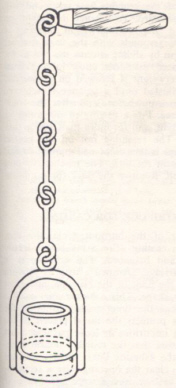

Yes. The mould is spun like in a sling shot. Today this can be done with a machine, centrifugal casting in some kind of spinner. This must of been a risky pass time. I do not know what size limits there must been. Hardness would also depend on the alloy.

Hand sling for casting. Some big chap might be able to swing quite large flasks.
