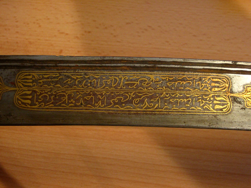

I recently got 2 yatagan swords as a present from my grandmother.
I already posted those pictures in the german Messerforum and got the hint to ask here for more information.
I added some pictures and some closeups of the inscriptions.
Maybe someone can help me to find out more about origin and age of those pieces.
Also the question came up if the blades could be made of wootz steel. Could that be possible?
Thanks in advance for any help.
greetings from Vienna,
Eugen aka the_Nazgul

Zifir
Zifir's Avatar
Location: Istanbul
Posts: 228
I would definitely like to get such presents too, but no luck so far
Ya Muhammed kıl şefa'at ümmetindir Hasan
O Muhammed! Intercede on the day of Judgement on the behalf of Hasan,
who is one of your Ummah (community of believers).
Bıçak elde gerek dilde sübhan
"One should have sword(knife) in his hands and the Subhan (popular name for Sorat Al-Isra from Quran) in his tongue."
1216 Amal-i Mustafa Sahib Hasan Beşe
Year 1801/2 Swordmaker Mustafa Owner Hasan Beşe( beşe title suggests that he was a janissary)
Amal-i Ahmed Alemdar sahib İbrahim Ağa sene 1116
Sword maker Ahmed Alemdar (alemdar is another janissary title used by subordinate officers) Owner İbrahim Ağa Year 1704/5

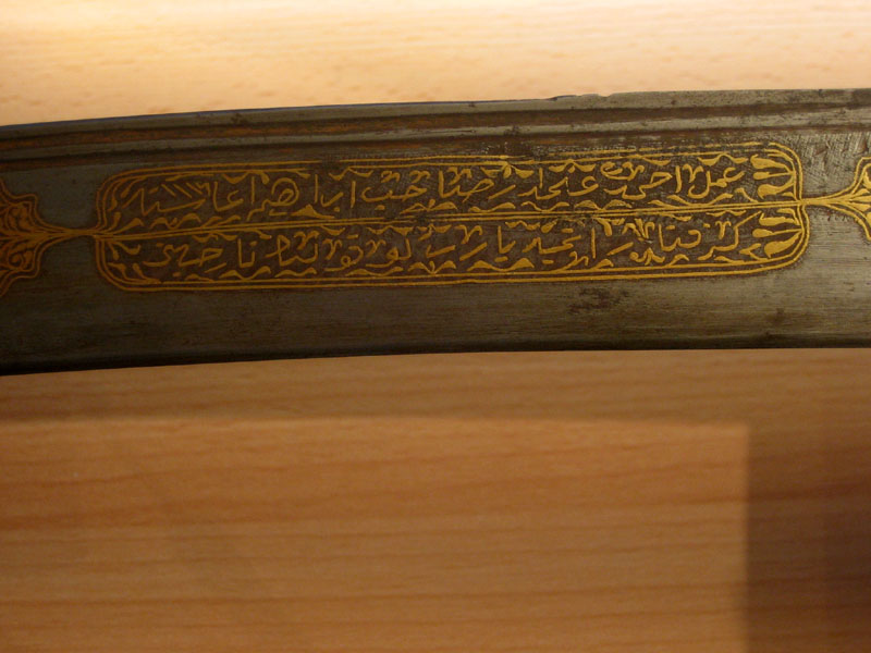

I have difficulty in reading the second line, maybe a better picture helps.

I attached two more pictures of the inscriptions on the larger one (I just noticed I only uploaded a photo of one of the two inscriptions so far)

Very nice pieces.Completely original and intact with no restorations. Zifir,your existence here is a great plus,as the only member who can read and translate Turkish written in Ottoman alphabet. I must learn that too,when I find some free time.I just need to ask about the date on the first one. It must be 1216 instead of 1116,not? I think age would matter a lot on the rarity and price of a piece so intact and complete,especially if it is an early date like 1704.
