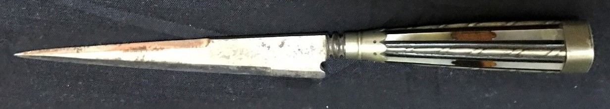

I recently got this dagger and am wondering if it is an Italian vendetta knife. It doesn’t have the Spanish notch usually seen on those blades. If it is Italian, is there an Italian name for the type and does it have a specific geographical area?
Specs:
7.5” (19.05cm) blade with integral bolster and 3.75” (9.525cm) false edge
Flattened octagonal, black horn hilt with 8 German silver strips inlaid longitudinally (all but 2 missing); German silver ferrule; Butt cap and nut for threaded tang missing (both probably German silver also)
Black leather sheath with German silver throat and missing chape (probably German silver also)
I plan to restore the missing pieces. The missing butt cap probably looked like the ferrule but if anyone has photos or advice as to what the nut and the chape probably looked like, I would appreciate hearing from them.

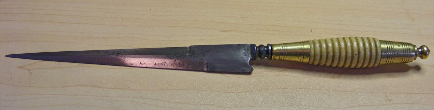

Attached is a Corsican one from my own collection, it's 23,5 cm long inside scabbard.

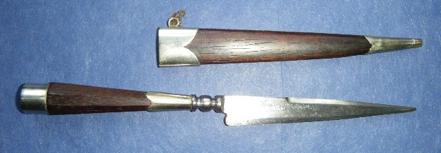

Old 27th April 2026, 09:11 AM   #4
And here are my two other ones.

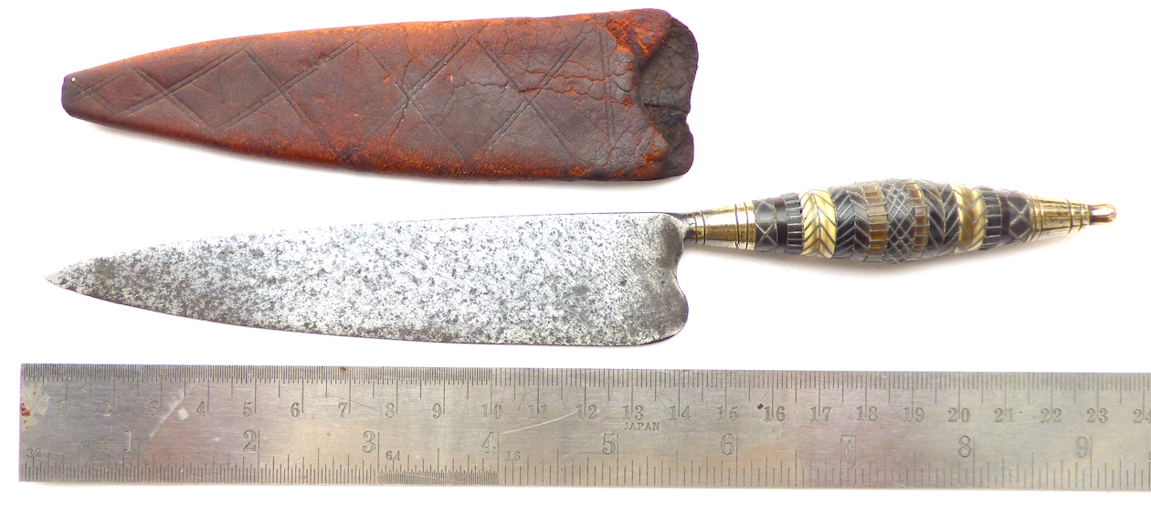

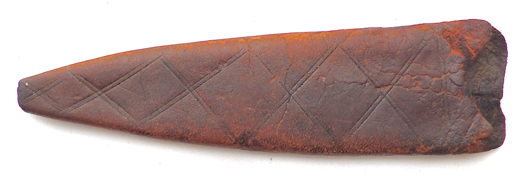

Your knife has a sheath that looks familiar, with the criss-cross pattern lightly embossed on soft leather. I have a Canary Islands' knife with a sheath of a similar pattern on soft leather. I'm not suggesting that your knife was necessarily made in the Canary Islands, but it might argue that your knife is perhaps Spanish in origin.
As Detlef has noted, the description of your knife as a Corsican vendetta example may be a little off. A number of Spanish and Italian knives are similar, and for that reason are sometimes designated as "Mediterranean." Perhaps that might apply here. Just to illustrate the similarity in styles, note the hilt on the second example shown in Detlef's most recent post. it has a brass ferrule at each end, a swollen central part and a small ball at the pommel. This hilt looks very similar to so-called Spanish ripol hilts.
Attached are pictures of my Canary Islands' knife and sheath.

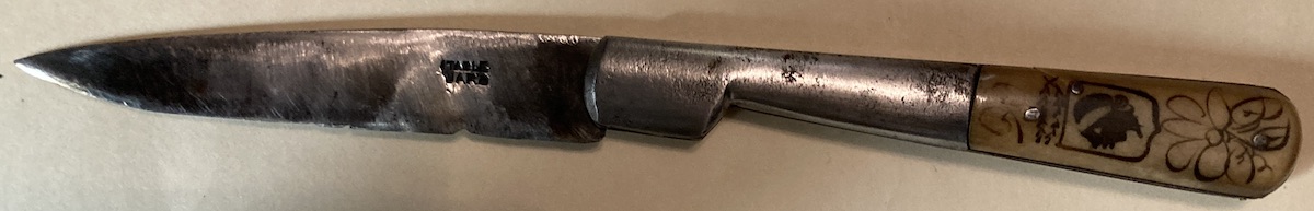

The Corsican vendetta dagger on the other hand is a folding knife with a spear point blade and a French slip joint lock. The hilt features a peculiarly shaped long bolster and, on vintage knives, the scales have a Moore’s head on one side. I have provided a photo of one of mine below but an online search using “Corsican vendetta” will yield many more.

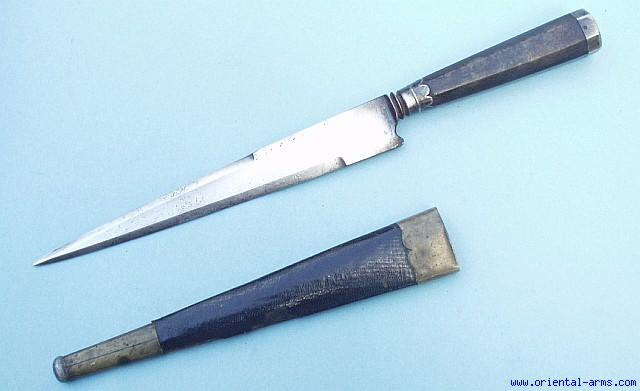

Just have a look here: http://www.oriental-arms.co.il/item.php?id=1094 or better here: http://www.oriental-arms.co.il/searc...&s.x=11&s.y=15
But yes, I know that these folding knives are also called vendetta knives but the fixed daggers are the older ones.
