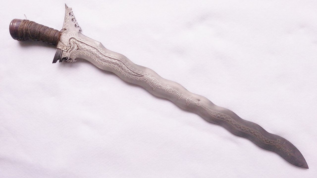

Hi all. New here and looking for advice/opinions on my keris. I inherited this from my father several years ago, and despite much research, I cannot find any published examples that are truly comparable - particularly the inlay. I'm hoping someone here has some insight. If nothing else, I hope you all find this half as fascinating as I have.
Details:
1) Luk-11, blade-only (no ukiran, waranga, etc.)
2) Weight: 1,023 g
3) Length: 57.3 cm (not including pesi)
4) Blade Width: 5.4 cm at luk-1, tapering to 4.6 cm at luk-11
5) Blade Thickness: 0.60 cm at luk-1, tapering to 0.44 cm at luk-11
6) Ganja Width: 15.8 cm
7) Ganja Thickness: 1.60 cm (at center)
8) Inlay: Both sides of the blade contain the same, intricate inlay (kinitah?) that extends from ganja to tip. Inlay material is almost entirely present, but the few voids present reveal deeply cut channels (~1.5 mm).
I believe this to be from central Java, possibly late 18th century, but that's I brave to speculate at this point. Any info or questions are welcome.
(Note: Final photo a sketch-over, intending to show the full inlay design clearly.)
Thank you,
another_rick

This Kris is from the Philippines, not Indonesia and is from one of the Muslim Moro tribes.

Welcome to the forum! Like Rick noted, it's a kris from the Philippines, around 1900 would be my guess. I think it's from Mindanao but I am not sure but we have members here who will be able to tell you more.
You need to clean the blade from rust, the blade will benefit from a good clean-up. To restore it to a complete kris would be what the most of us here would do, adding a fitting handle and clamps would make this a beautiful kris, the blade has beautiful inlays! The inlays have a talismanic purpose. See here for kris with talismanic inlays: http://www.vikingsword.com/vb/showth...ght=kris+inlay

Welcome to the Ethnographic Forum! As Rick has noted, this is an example of a Moro kris. It has a complicated inlaid pattern that is very unusual.
I don't think this is an 18th C blade, but rather late 19th or even early 20th C. judging from its width and the way the terminal luk and tip have been constructed. The dark patina and mild surface pitting suggest that the blade has not been well maintained over the last century or so.

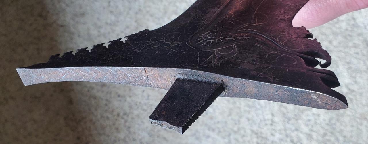

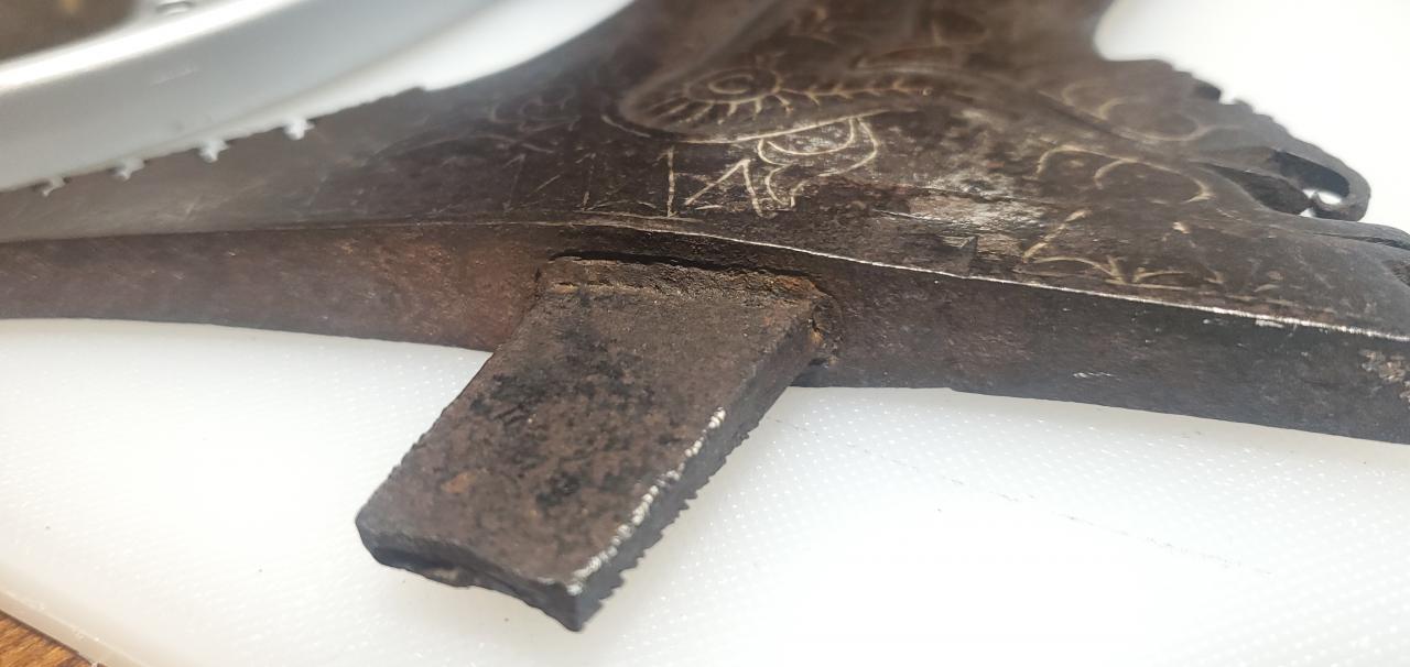

Of note is the very short tang. It is possible that this is a broken tang, but short tangs such as this one were made that way on some early 20th C kris. I do n ot see a separate gangya, and the tang has been welded directly to the gangya rather than passing through it. Again, this suggests 20th C work.
We need some help from our Filipino colleagues to explain the significance of the motifs on this blade. Some of them appear to be influenced by a naga (snake).

I agree with the dating and everything, except with the Gangya issue - this blade has a separate Gangya.

I too thought the ganya was separate and agree with the naga influence, hence, my original assessment.

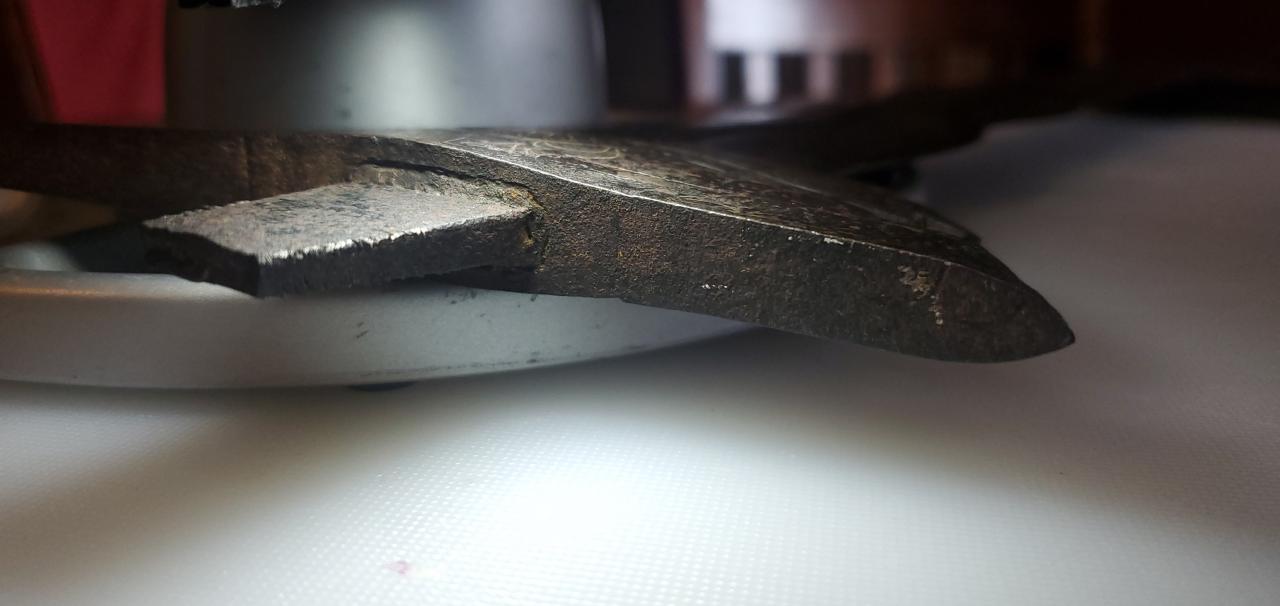

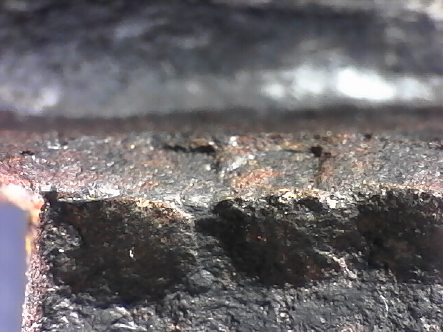

More photos of the underside with different lighting. I don't see evidence of modern welding but forging, perhaps.
The closeup (60X) is the face of the pesi/tang, at juction/joint with blade/ganya.
That does not seem very sturdy... Would a kris with a tang that short have had baca baca for reinforcement?

The tang was longer originally, of course

Yeah in this case it looks like it would have been longer originally. But I guess I'm asking in the abstract, given what Ian said.
