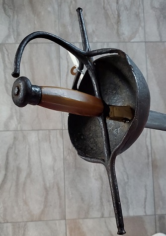

I am a bit puzzled about the 'Caribbean' rapier reference, are you referring to the cup hilt forms which often seem mounted with heavier 'arming' type blades? In the brief glimpse of the wreck site from 1708 in the linked Utube entry, there seemed an intact cup type hilt with the quillon across.
I could not make out the shell type versions. Are they in accord with these images attached? you indicate these are from the book shown by Mr.Wells, but going through that I could not find the images.
Please forgive my confusion, just wanted to be sure I am following.
I have always understood these much simpler versions of the often smartly embellished Spanish cup hilt rapiers, especially in the 'arming sword' character were indeed from makers in the colonies, hence being labeled 'Caribbean' in most references. I had always thought of the very crude example shown in "Arms and Armor in Colonial America" (Peterson) which I cannot seem to find an image of, were the typical examples of these forms.
However, I later found that better quality examples but still relatively austere were also deemed 'colonial'.

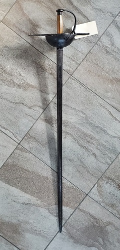

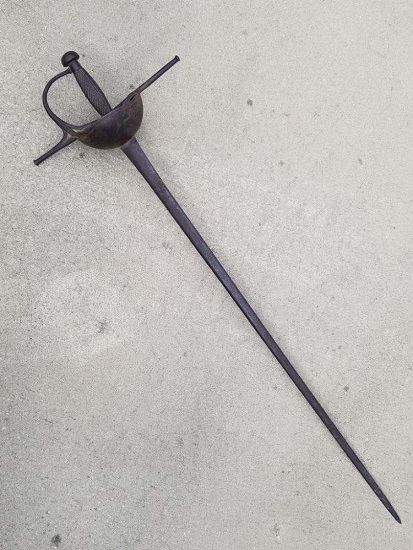

Attached are images of one with what appears cross hatched ebony grip, and my humble example which as had a crude bone grip refurbished.

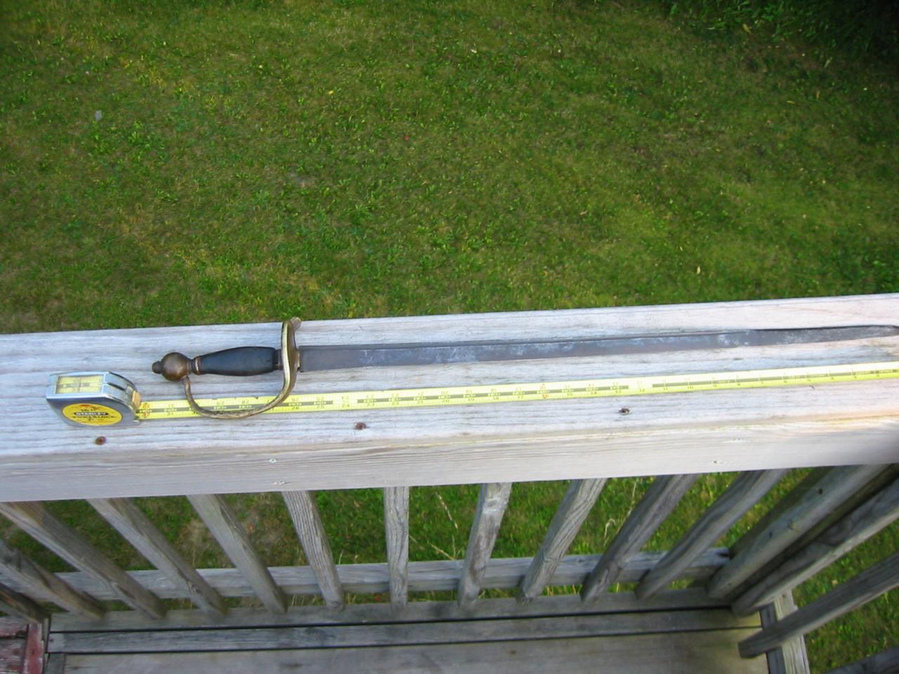

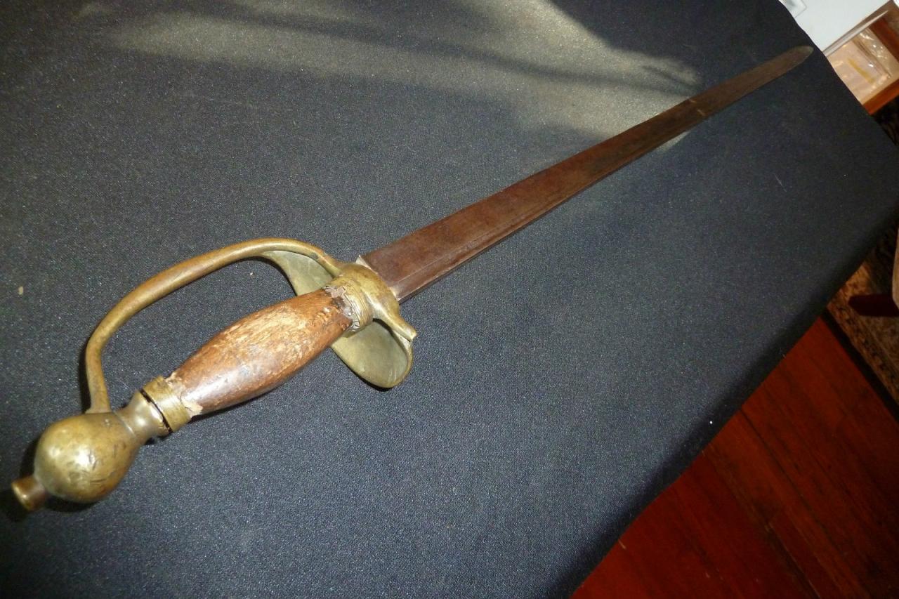

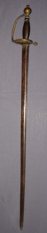

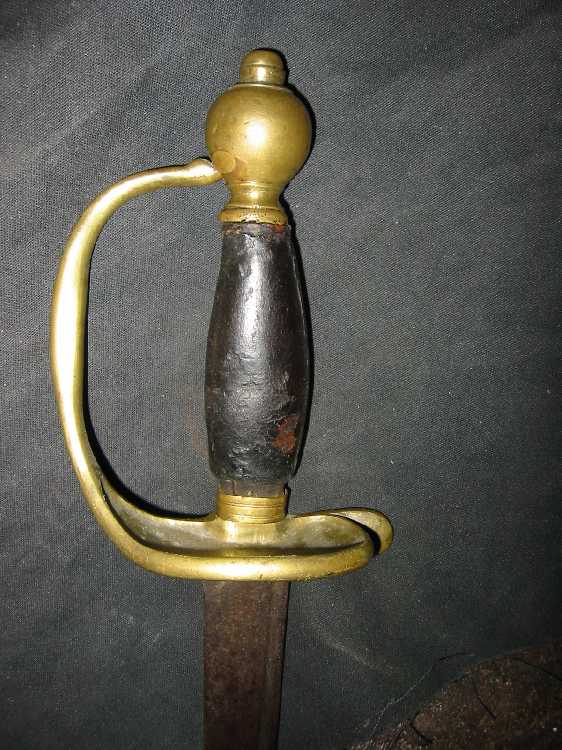

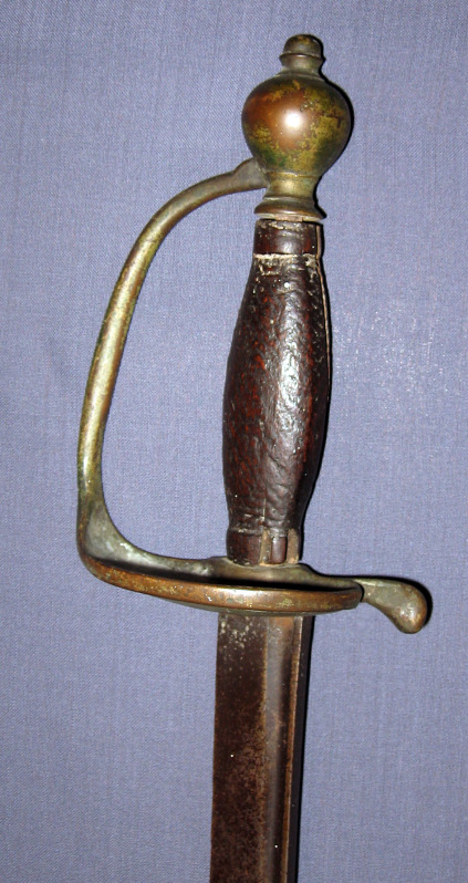

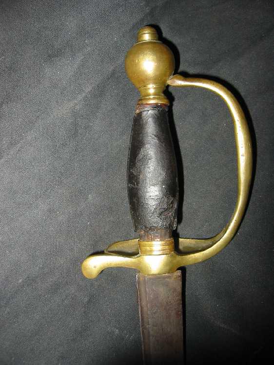

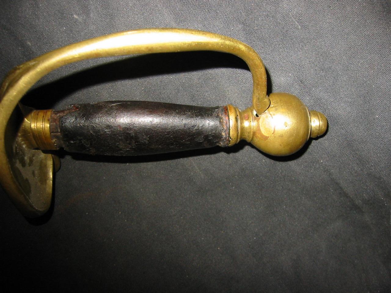

David, of The Royal Sword shared his at one point and I saved that set
Old 15th December 2025, 03:28 AM   #5
Hotspur
Hotspur's Avatar
Join Date: Jul 2009
Location: Nipmuc USA
Posts: 556
They are almost peas in a pod. The Rose hangers, from a century later are very similar
