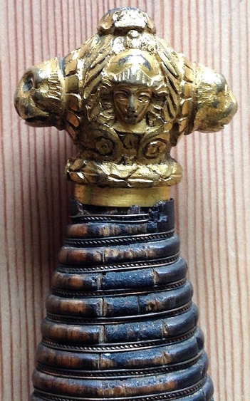

A distinctive feature in this otherwise rather ubiquitous form of hilt which remained popular well through the 19th century, are the dual, opposed lion heads at the pommel. This feature seems to have become popular throughout Europe early in the century, as it occurs on various examples French and Spanish in first half of the century.

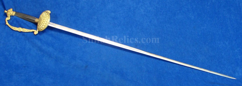

First pic: Dutch infantry officer (Puype, 1981) c. 1820

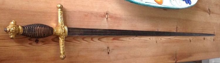

Next 2: Spanish infantry officer c. 1850 'Isabelina' dress sword

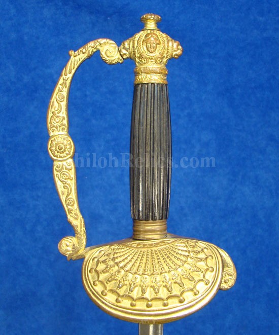

Next, blue background French, c1830s

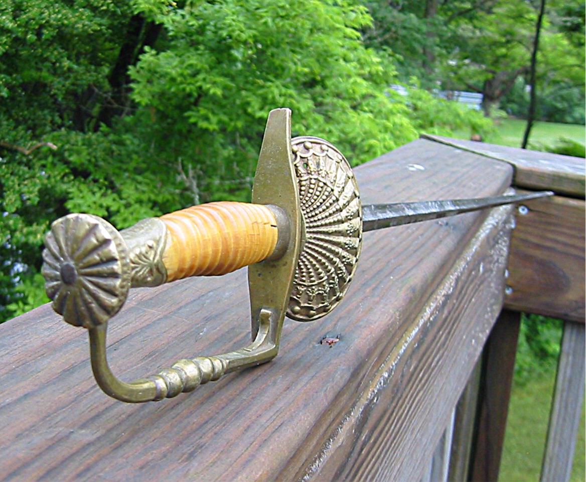

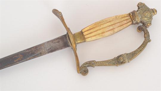

Next, fluted ivory, Spanish, probably c. 1810-20

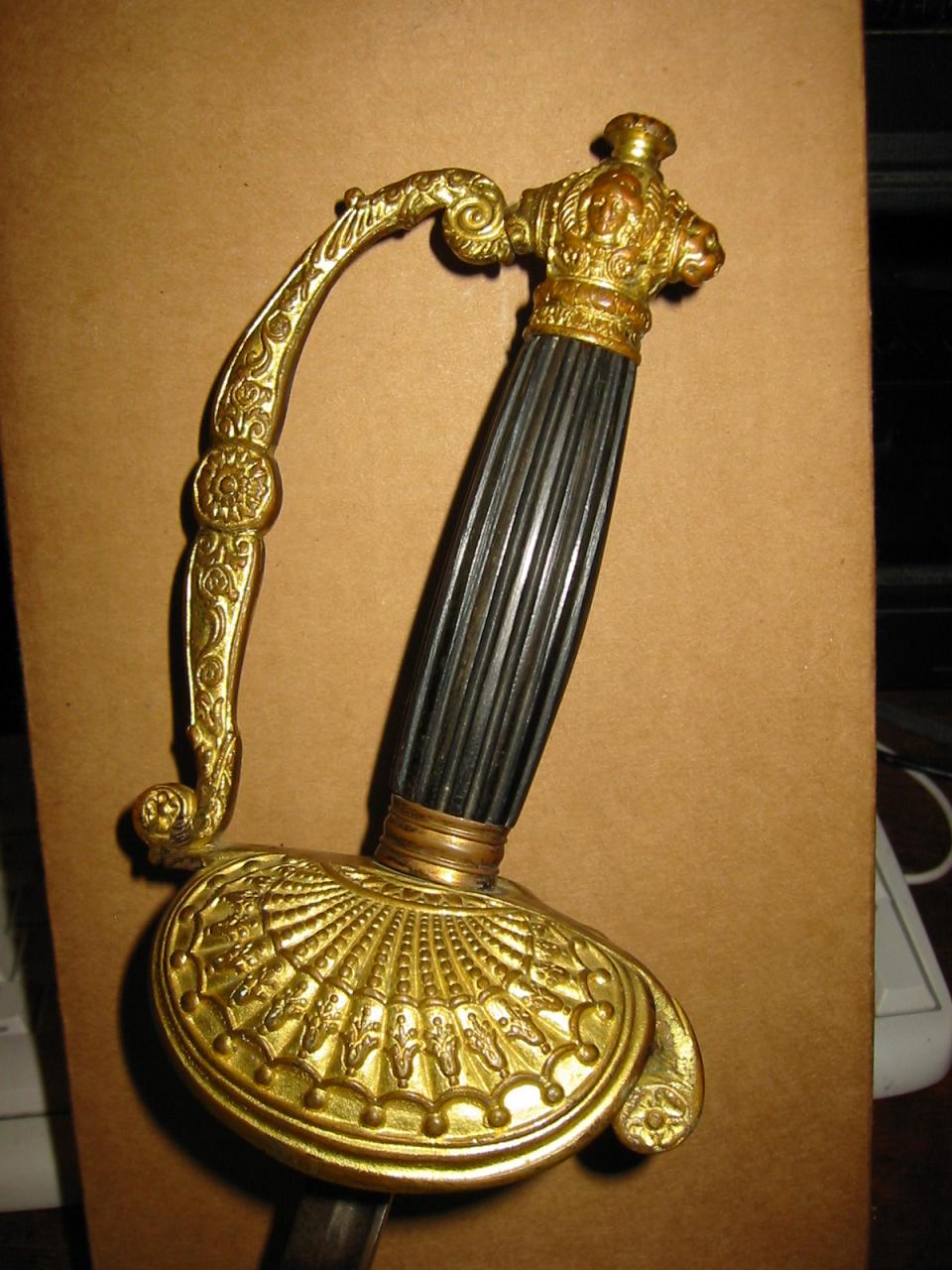

The blue background Shiloh sword is mine and it is 20th century
A fancy plastic grip on that one
Fittings got mixed and matched for more than a century
Cheers
GC
