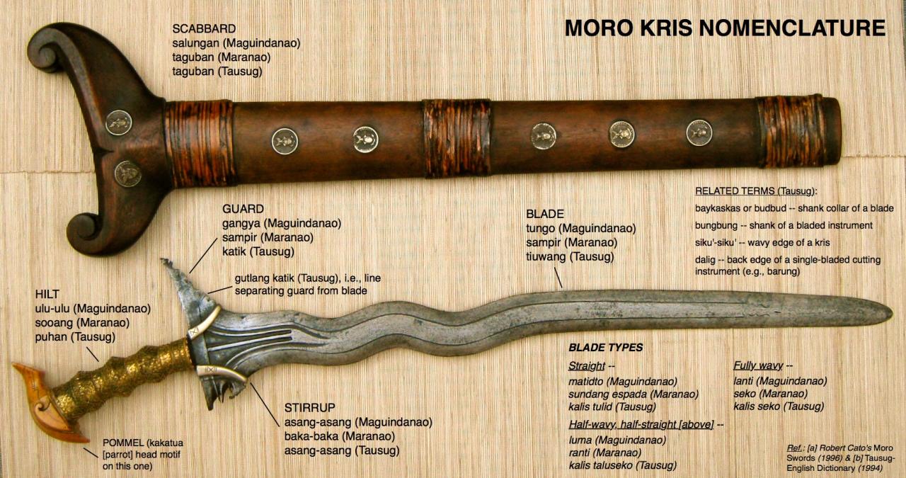

Comparing these two Maguindanao kris.
The two swords differ somewhat in length and weight. The second one feels "heavier" in the hand, while the first, although by no means a light sword, feels less "heavy." The slightly shorter, narrower, and thinner blade of the first one contribute to this.
Significant differences in the ricikin and gangya point to the first one being the older sword. The "elephant trunk-gandhik" area of the first sword is a more traditional style that predates the more recent style of the second one. The length, height, and thickness of the gangya of the first are all smaller than the second one. The height of the gangya, in particular, can be a useful guide to age IMHO, with older swords having shorter gangya than late 19th C ones.
Also contributing to the age assessment is the style of pommel. The very small kakatua without a crest, as seen on the first sword, is often seen on swords pre-dating 1800. The flared hilt and "horse hoof" pommel on Maguindanao kris seem to be features of the second half of the 19th C and later.
It is interesting to note a one-piece asang asang is present on both these swords. Recent discussion here noted that this feature appears to have arisen in the second half of the 19th C. It's presence on the first sword seems out of place, and perhaps it was a later replacement.
Lastly, I would draw your attention to the tips of each blade. The first example has a rounded tip that does not come to an acute point, while the second has an acute point and is less rounded. The latter feature is seen almost exclusively from the late 19th C on.
I believe that the first sword was made no later than the early 19th C, and the second no earlier than the mid-19th C.

If we look at the history of the Moro Wars outlined in a recent post in another thread, there was a gap in Spanish aggression between 1737 (a peace treaty signed) and 1851 (renewed Spanish attacks). During this period, the two sides were evenly matched and conflict favored neither side. The Spanish made improvements in their military equipment, particularly the acquisition of steam-powered gunships capable of navigating the rivers of Mindanao and Sulu. This development gave them a considerable advantage by the mid-19th C. Hence the renewed assault on Moro strongholds.
The second sword above corresponds, I believe, to the Spanish-Moro conflicts resuming in 1851. It represents a small increase in length, width, and thickness relative to the first sword from pre-1850. However, the difference in size and weight between the two swords is not great. The measurements of the kris from pre-1850 shows it is a large kris also. So, to what era of conflict did this kris correspond. Perhaps we need to go back to the prior period of Spanish-Moro fighting in the first half of the 18th C to find the origin of this version of the Maguindanao kris. Or perhaps it is necessary to go even further back to the 17th C in the history of these wars to identify the modifications made to the earliest Moro kris to arrive at the bigger and heavier versions shown here.
Please note that I am not saying that the first kris shown above was made in the early 18th C, but rather that it represents a style that perhaps was used at that time.

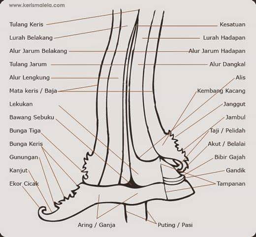

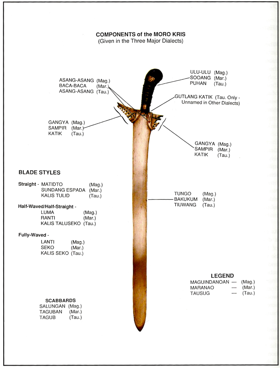

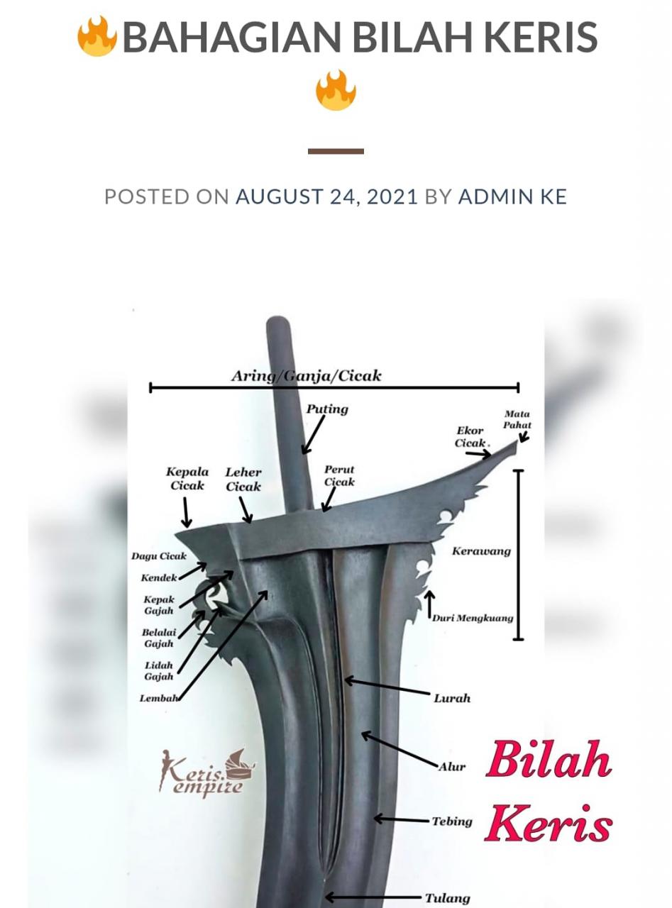

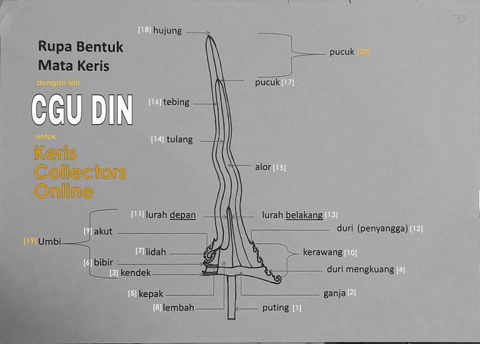

Reading the descriptions has raised a question for me. Ricikan, sekar kacang, praen, gandhik, lambe gajah, greneng, jenggot, sogokan and blumbangan are all Javanese words for parts or aspects of the Javanese keris. Gangya is the one word here that has obviously had some carry over to the Moro kris/kalis as a variation of their word gonjo (ganja). This terminology has, to a greater extent, been adopted and applied to keris from outside the Javanese culture, though i have run across numerous diagrams that show the more culturally correct terminology for various other Indonesian and Malay cultures as well. While i do understand that using one lexicon to describe the features of keris makes communication a bit easier it still seems a shame to allow more specific cultural identities to fade away from lack of use. But rarely have i seen this many Javanese keris terms used to describe a Moro kris. I have to wonder if we are not doing the Moro culture a bit of a disservice by not seeking out the terminology used by their smiths and people to describe the parts of their own weapons. I has seen a few diagrams that attempt to lists these culturally correct terms, but none seem to be as extensive as the Javanese lexicon for keris parts. I have attached what little i have seen in this regard even though i am fairly sure that you all have seen them as well.
I am also attaching a few diagrams showing some of the variations on keris terminolgy that can be found in various places around the archipelago that are different from the generally embraced Javanese terms.

David, you raise a very good point. There likely is more specific terminology in the original Moro cultures for the features that I have labeled with Indonesian terms. If I had a reliable lexicon for those terms, I would certainly use them. For example, I have used the Maguindanao terms gangya consistently for Moro swords because that is a term used by the Maguindanao and is sufficiently close to ganja to be understood. The term asang asang is Maguindanao, and I have also used the Maguindanao terms for a straight kris (matidto) and a fully-waved kris (lanti), as recorded by Cato (p. 60).
As for the carved features for which I use keris-related terms, I have no information as to what they may be called in the various local languages. Hence, I use common Javanese terms for these. This decision was made after corresponding with Alan Maisey, who recommended an accepted set of keris terms that would be understood widely among the keris community.
I also use the Indonesian terms because I want to remind people about the origins of the Moro kris, and what those features originally meant. No doubt there has been some re-interpretation of those features over time among the Moro communities. Again, I'm not privy to how Moro peoples have interpreted the Indonesian keris symbolism that they adopted and adapted over time. There are some suggestions in the Western literature, but frustratingly little scholarship on that subject.
Yes, it would be nice to have more information about local terms and interpretations. I would use such terms if I could find them. However, I'm aiming for clarity and how to communicate the features of these swords in a way that can be understood widely. The Javanese naming system seems a place to start until more accurate terms are available.

Halloo, just as an aside- according to a Maguindanaon culture-bearer of the Salipada lineage, the proper terminologies should be:
If it's a straight kris, it's called "kris sundang."
If the kris has waves, then it's called "kris a lanti."
These terms are different from Sulu's, since kalis has its own proper terminologies, as asserted by modern-day Tausug culture-bearers:
If it's a straight kalis, it's called "kalis buntul."
If it has waves, then it's "kalis ____ siku," the number of waves is specified.

Xas, thank you the terminology. While it differs a little from what Robert Cato collected from his informants in the 1990s, I shall revise my data accordingly.
Ian, please understand that i was not criticizing your usage of these Javanese terms in this regard, simply making a call for more vigorous research to discover the proper names for these features in at least one, if not more, of the Moro languages. We do have at least a few native Filipino members here who may be able to make some inroads on this study. It just seems that we have for some time assumed that this knowledge is not available, which i suppose could be the case. But i would hate to see Moro collectors give up on this search altogether because language is such an important part of any culture and understanding deeper or hidden meanings that might be lurking there. Despite the obvious fact that the Moro kris descended from the Indonesian keris, clearly these two weapons were treated in very different ways by these respective cultures and the specific names used for the various features can help us understand better how these people related to these weapons.
Old 27th August 2024, 12:53 AM   #8
Posts: 4,614
David, I agree completely. It would be very helpful to have the culturally appropriate terminology, and that could indeed give insights into how different features of the Moro kris have been absorbed into the local cultures and what they mean in regard to local traditions.
