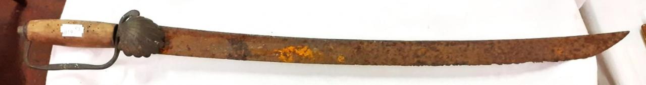

The work continues, and I recently found a shellguard example (attached) which is yet to arrive. As noted earlier by Mark Eley (again my sincere thanks to him for his response) these had a close connection to the 'cutlass', from which they evolved as discussed in the article.

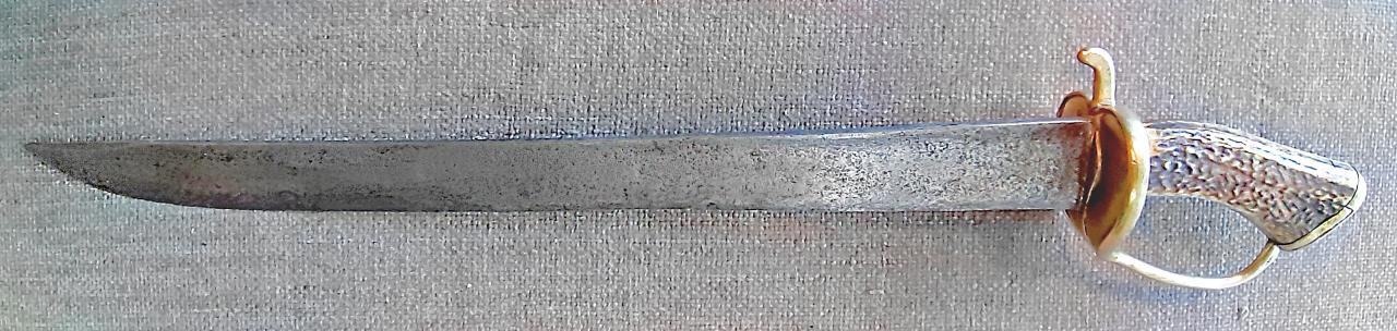

I wonder if this curiosity of mine fits anywhere in your world; it is certainly an oddity with more relations in the naval world, but still not certain.

Default The naval hanger cut down into a dirk
"You will recall this example,an English or French hanger cut down into a dirk." (Jim)
Yes, indeed Jim, and your 1785 cutlass.

The cutlass arrived today, and it has crowned GR on blade (Gilkerson, p.88) but hilted with Spanish cockle shell guard of espada ancha. It appears to be indeed a cutlass but of the 'Spanish Main' of the early 19th century in Caribbean 'South Seas'. As these Caribbean colonies were using many English (or Solingen produced versions) in these times, this falls neatly into that regional part of the espada ancha spectrum.
