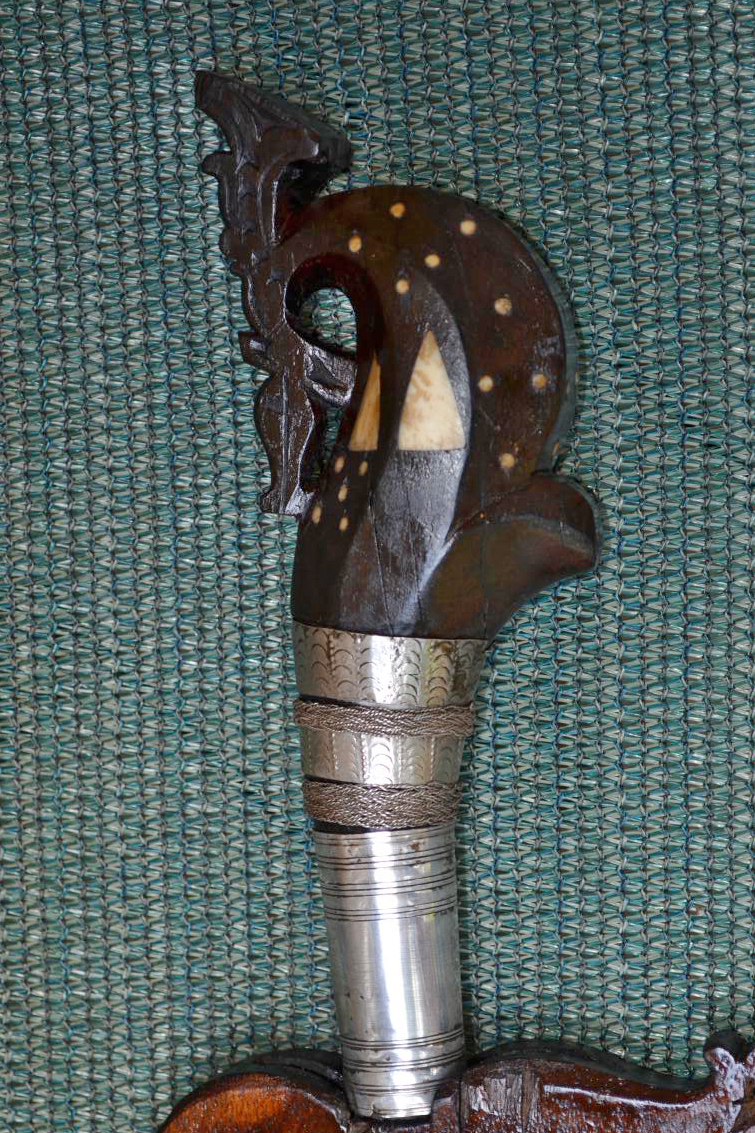

Posts: 1,334
Do you know what is called and where is the wood damaged; is there some part of the carving missing?
In front of the handle seems a tiny part missing, that's what Jose means I think.

While the bone inlay, the silver punto, and the silver braidings seem to suggest honest age, I get mixed feelings: While stylistically correct, the scabbard is pretty roughly finished - something I haven't seen from 19th century status examples; I'm also not convinced the hilt being kamagong (from the limited pics, the surface texture seems to be off) - could this possibly be a stained, medium-weight timber? I'd be inclined to place this ensemble into the first half of the 20th c. Just a gut feeling though.
The fittings are clearly Sulu work, Tausug specifically I believe. While the blade may originate inside the culture, I couldn't exclude it being a Maranao trade blade, especially if later.

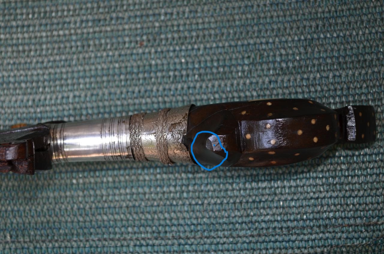

I adjusted this photo for a better view. Can someone point out the damaged part of this hilt? I am afraid i do not see it.
Nice find btw!
Old 23rd August 2023, 10:44 PM   #9
I am not sure if it is in front, but I think this marked tiny loss was meant by Jose.
And by this break it looks indeed like kamagong.
Thanks Detlef. That does look like it could be minor damage. Better photos of the area would tell more.
David, Jose's mention of "damaging" was an autocorrection glitch when trying to type kamagong...

That's an interesting old piece. The naga hilt is an unusual item and very similar to the one in Cato's book. I suspect the wood is kumagong, which is used sometimes for Moro hilts. It is very dark and dense.
As to what your blade is, that's a bit of a mystery. The blade is very forward weighted, much like a Mandaya general purpose bolo. It does not correspond to the leaf-shape profile of a barung. I looked back at some of the archive pictures of Moro weapons plaques and found a somewhat similar example in my large plaque from the 1930s: see the bottom left item in the central panel here. Unfortunately, the examples are not named on this old handmade plaque. Nevertheless, the blade profile may once have been in the Moro repertoire of weapons or general purpose blades, as your example suggests.
Heavy, forward weighted blades are seen among other Filipino groups. I mentioned the Mandaya already, and I've seen similar Bagobo blades, but this type of blade is also common among the Ifugao groups and others in central and northern Luzon. I would not be surprised if there are Visayan and Bicolano versions also. The design seems well suited to heavy chopping.
As to what this knife/sword might have been called, I don't know. I suspect it may have been made in Zamboanga.
As per Jose's post #10.
