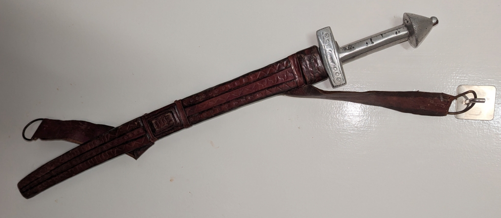

That was my initial thoughts, but then the blade has tak-like fullers and that crossguard is not very viking. reminded me of asub saharan short tak with a cast aluminum guard I have. (below)
In any case, it was cheap. Thought it might be worth checking it out in hand.

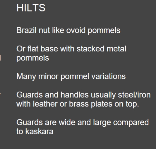

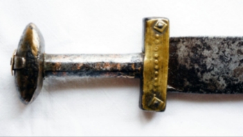

I Note on mine in post #1, the wide blade, single fuller, rounded tip, reenforcing plates on the crossguard, holes that may have once had rivets for a cover. And the oval half a brazil nut pommel.

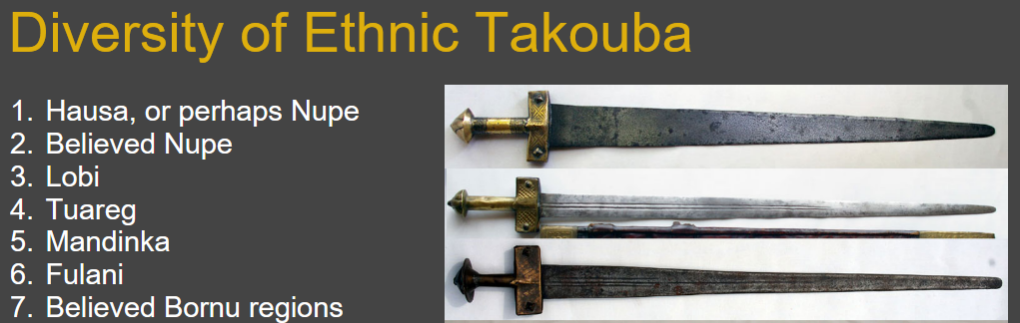

Also I note from http://takouba.org/the_takouba_form_...stribution.pdf
the oval pommel is also a feature on some.

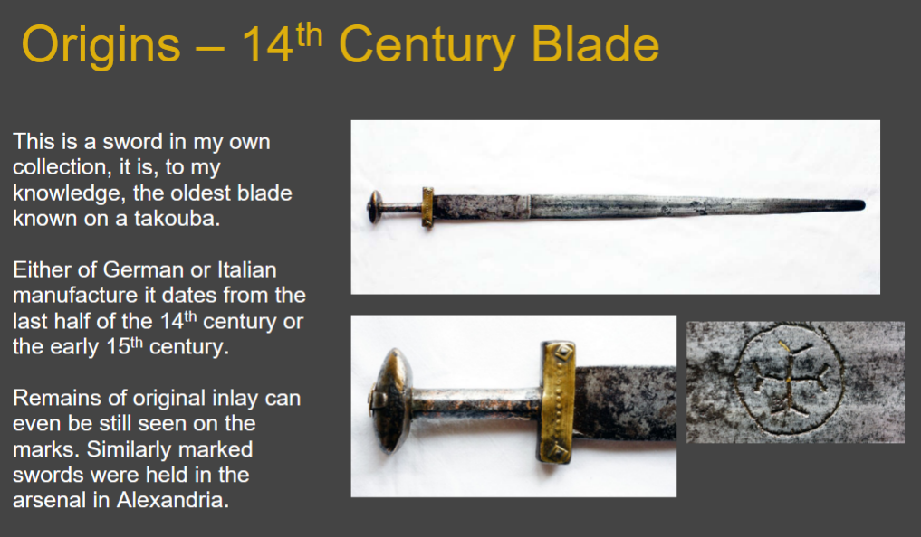

In my view its not a takouba, its most likely an old stage prop aping a viking sword. The pommel is not of the type you would see on a takouba, its made to imitate a two part viking pommel. The blade could have been taken from a takouba or a kaskara, this was fairly common when making stage swords in the early 20th century, but its very hard to say given the current mounts.
The screenshots you posted are actually from a very old PDF I wrote and the sword is no longer in my hands but looks a lot better these days. I have posted it several times in the past.
