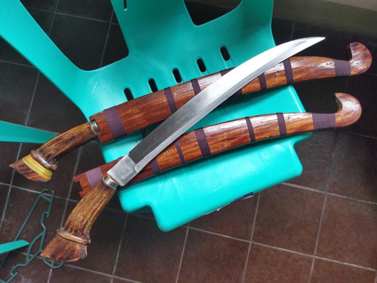

It reminds me of what they call "Tinari/Binulang" in Waray-speaking areas of Eastern Visayas, Philippines. Though your scabbard and hilt look different.
Similar blades in the Philippines that have similar profiles to this are the modern Ginunting from Hiligaynon-speaking areas and the Sinampalok from Tagalog and Bicolano provinces. With that being said, I cannot really be certain that your blade is from the Philippines.
Edit: Image not actually mine, please take down my post if ever it's not allowed.

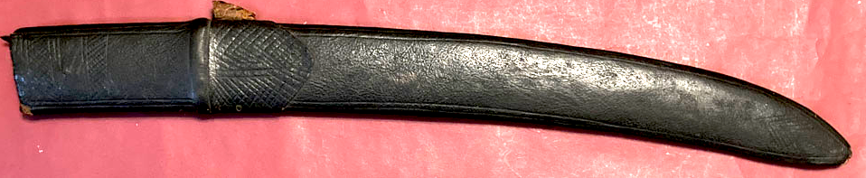

Old 24th October 2022, 10:14 PM   #8
Posts: 4,738
Tanaruz, hard to say from the original picture, so I adjusted the contrast of the OP to get a better look at the leather-wrapped scabbard (attached). It does not look Visayan to me. While there is a superficial resemblance, the overall construction of RobT's sheath seems unlikely to be Visayan.
Wayne, thanks for the additional pics of the Nepalese sickle and other work knives. Ooops, where did Wayne's post with those pictures disappear to?

Old 25th October 2022, 11:17 AM   #10
Wink
The sheath is black leather wrapped wood. The leather wrap is expertly stitched along the back with a single seam from throat to tip. Under the leather, there appears to be a cord binding holding the upper portion of the sheath together. There is a decorative leather flap below this binding that appears to have had one time some sort of leather suspension loop.
If Rob were to post a pic of the backside, the construction differences to the Visayan scabbards would become more obvious, I guess.

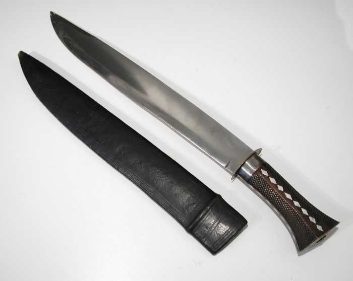

Old 26th October 2022, 07:17 AM   #11

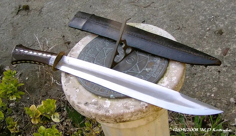

The scabbard does remind me of my Nepali 'Bowie' knife's one. the ridge formed by the 'string' near the throat is to keep a slip-on frog from riding up.
I've been holding back on the photo until now.
Old 26th October 2022, 05:04 PM   #12
JBG163
Join Date: Sep 2019
Location: France
Posts: 209
In my humble opinion, scabbard looks 100% nepalese, as much as bolster that is really similar to kukri ones.
The start of the sharpening have an indian/nepalese feeling too.
To me, the origine is quite sure

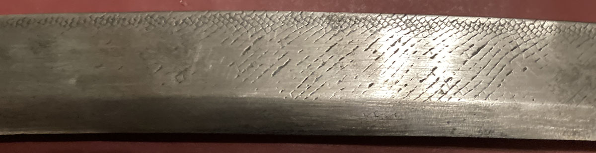

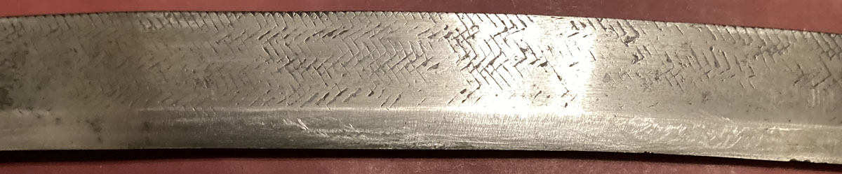

Here are the photos that were asked for.

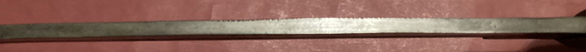

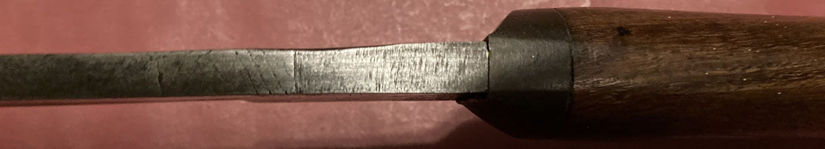

Interested Party,
Here are close ups of the spine and spine at the ricasso.

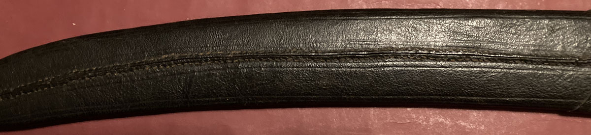

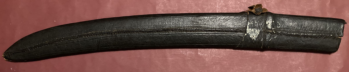

kai,
Here are pictures of the sheath back (1 full view and 1 close up).
kronckew,
Here are close ups of segments of both sides of the blade.

Old 27th October 2022, 09:36 PM   #14
Thanks, Rob!
Clearly not Visayan IMHO.
