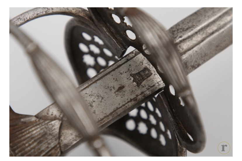

Hey Guys,
here are my new beatuiful Rapier. The bladesmith is Tomas Aiala, but i can not found this marker ( T with crown). I hope u can tell what the secret is.

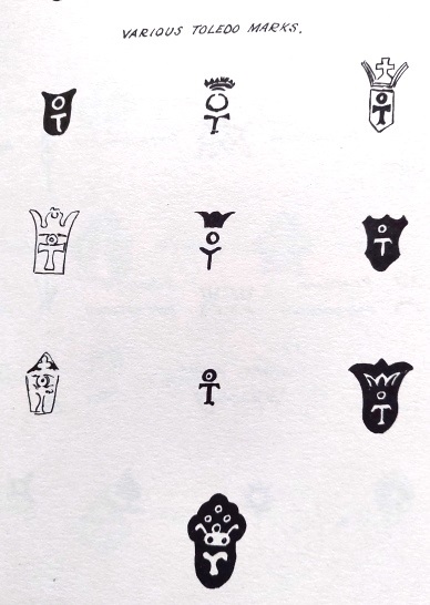

Toledo

Old 27th October 2021, 11:11 AM   #4
Default If i am correct ...
Excelent rapier, Merenti. If the mark shown has a little S between the crown and the T, this would be the personal mark of Thomas de Ayala. This would mean that you have the real thing, which is rather unusual; Ayala was one of names more used by other smiths to give their blades a grade of quality.
If instead the mark is a T with a little o over it, that would be one of marks of the city of Toledo, often used many of its smiths.

Hey Guys, Thank u for your opinion and thanks @Fernando!! I think this is the reason for the t.
Here are a pic from the other side, they are the same mark
Merenti, i am sorry i don't get you. Which T are you referring to; the one of Ayala or one of Toledo.
Why don't you give a little cleaning to the mark, so tat we may better discern the details. Now that you showed the other side i seem to see different symbols .
