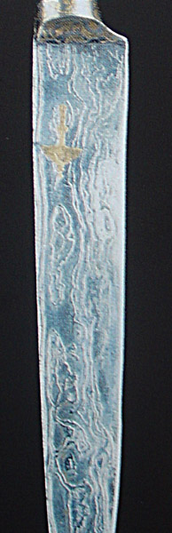

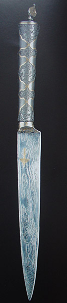

back to the original quote by jens, about the meteorite weapons commisioned by jahangir. well, the dagger actually exists still and is in the freer gallery of art in washington.
to quote on the dagger in the gallery -
'it was ordered together with a dagger and two swords, to be made from the metal of a meteorite. accounts of this incident appear in jahangirs memoirs and also in the iqbal-nameh-i jahangiri. the armourer was ustad da'ud, described in the iqbal-nameh as 'well known in those days for the swords he made'. it is inscribed in gold persian nasta'liq on the spine of the blade:
'there fell in the time of jahangir shah from lightning-like precious piece.janhangir ibn akbar ordered to make from it two swords (shamshir), this knife (kard) and a dagger (khanjar). in the year 1030 (1621ad) in the year 16 (of jahangirs succession),146.'
the hilt of this knife, clearly original, is decoarated with typically persian chisselled vignettes of a lion killing an antelope and a hawk killing a bird. the form and repeat pattern of these medallions are founds on persian metalwork such as candlesticks of the period. this object is pure persian in inspiration, except that the royal ownership is underlined by the inlaid gold umbrella mark on the blade.'
note, he number 146 has been debated and general consencus agree the possibility of it being an inventory number. also, by pure speculation from an image, without holding the piece, the persian work on the hilt just reminds me of late 18thC work, and not of the period stated. its just a speculative opinion, as the quote is from a good source, as are the general opinions from the freer gallery.
interesting stuff!!
btw, although it is a great dagger indeed, i think i would gladly exchange it for the chance to see jens' face when i sees the images

I was a bit surprised to see that ’Meteoric’ was still alive, and to see the picture was an even bigger surprise. I had never thought that any of these weapons, made out of the meteor, still existed. How or where you found it is a riddle to me, but thank you very much for showing it. The pattern on the blade is most unusual, but I like it a lot, just like I like the whole knife. Your end remark about seeing my face when I read the text and saw the pictures, was very well placed .

This is a link to the dagger that B.I.
is showing.
http://www.asia.si.edu/collections/s...ObjectId=10925
Gene

Gene, thank you for the link – it is a beauty. I wonder what the museum want this knife for, now in my collection – it would be real comfy – but I am afraid that they will not part with it, sigh.
I think I will have to settle with the fact that it is safe, and kept for new collectors to see and admire. Just imagine its history – fantastic. The pattern of the blade, besides being very unusual, really fascinates me. How many other blades do we know, of which we are sure, that they are made of meteoric iron?
