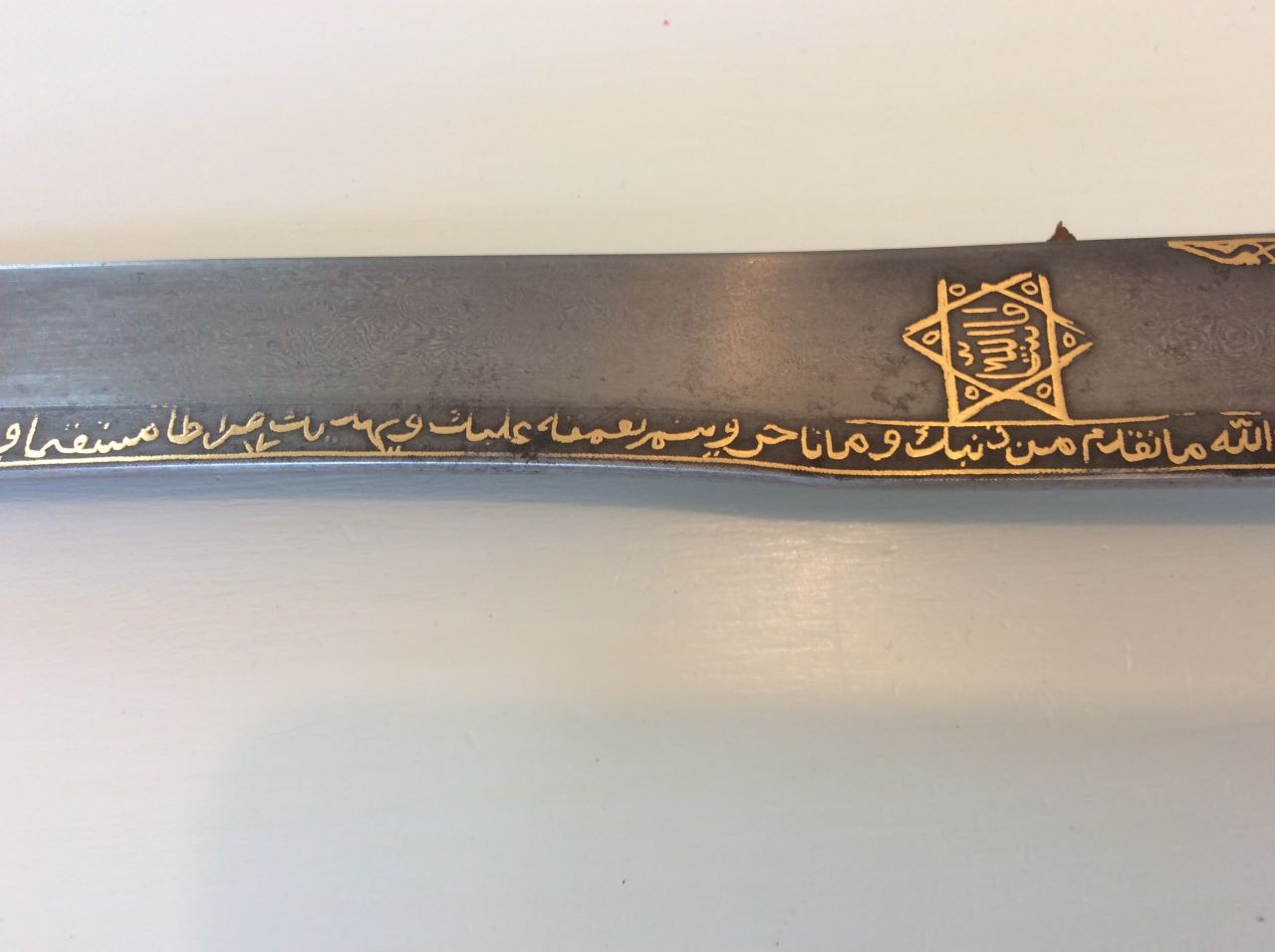

Hello. Am hoping to receive assistance with the extensive calligraphy on this Kilij which I think is circa 1750-1825. I have also included a picture of the tughra and hallmark. These marks show on the tang band, cross guard, all scabbard mounts as well as the hanging rings. These marks are very bold and quite visible so I think they were meant to be seen. I'm hoping the hallmarks and the inscriptions shed more light into this sword.

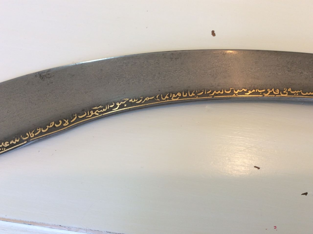

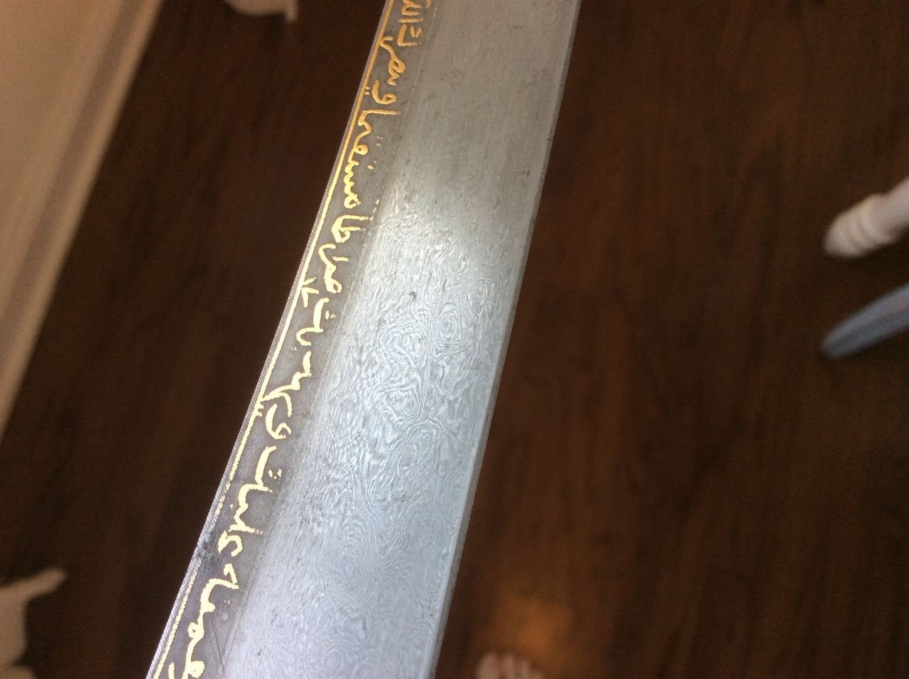

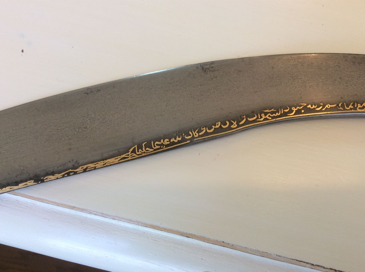

Here are the additional inscriptions that run along the spine. Thank you again.

The upper inscription is the ubiquitous
لا فتا (فتى) الا علي لا سيف الا ذ[و] الفقار
“There is no hero but ‘Ali, no sword but Dhu’l-Fiqar”
The lower, long inscription is Qur’an 48:1-4
In the 5-pointed star is ما شاء الله
“What God wills (ma sha’a allah)”
The inscription on the other side in the cartouche next to the grip is
يا مفتح الابواب افتح لنا خير الباب
“O Opener of Doors, open for us the best of doors.”
The larger silver assay mark looks like the tughra of ‘Abdulaziz (r. 1861-76). I’d have to look at it with a magnifying glass to be completely sure. The smaller one is the sahh assay mark.
