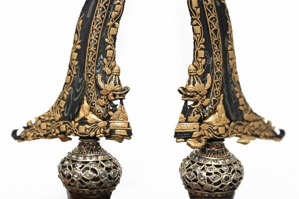

Yohan, i'm not sure it is always a matter of which method is "superior", but rather which methods suits the need. For instance, i might be wrong, but i would image that the heavy pieces of gold that stick out from the bottom of this gonjo must have been adhered using the Sinarasah method, otherwise they would be too prone to falling off. But i am sure that Alan and other here will have more information about this.
Hum, the heavy pieces of gold are just steel/ iron covered by a thin layer of gold?

Dear Kai,
Would you classify the gold work on the blade shown by David as kinatah or sinarasah?
As I said, we can't really know from any pic but a high-power X-ray...
As a default, I'd assume that the figurines have an iron core which was pre-modelled on the gonjo. The gold layer may be thin, indeed.
I believe this most likely would be subsumed under kinatah by Jawa standards.

David's Example
The work on David's keris is kinatah work, the two little protuberances on top of the gonjo could be achieved with other methods, but are most likely to be gonjo material left proud and then the gold foil applied.
