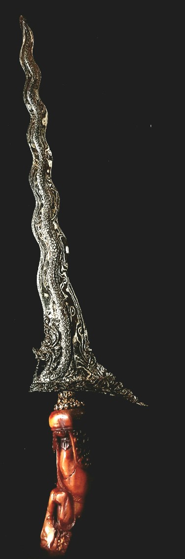

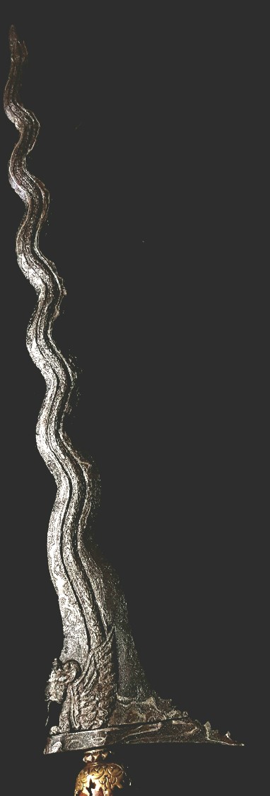

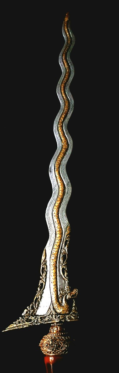

Hi Forum.
I really need your advice and comment. Which one of those keris with gandik Naga ornament is fake(not old keris)?
Thank you all
Regards.
Ridho Pulungan

As Rick suggested in another thread, we need better photgraphs.
Also, i would not use the word "fake" to describe newer keris unless they are being presented to you as antiques. Even then the intention of the maker probably was not to create a "fake".

Instead of fake, may I suggest that you make your question more concrete, e.g. which of these keris are kemardikan? Or which of these keris are older than the 19th century?

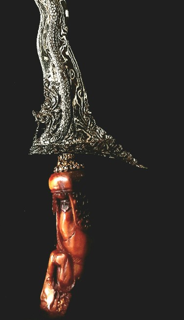

I make a litlle change to the picture. I know its not perfect enough,but i hope the new pict can give Rick more clear about the keris. I really want to take another picture with new angle and lighting soon.
Thank you for your kind.

Ridho, I'm not brave enough to jump in and declare that something in a picture on a screen is not old. By "old", I'm thinking in terms of pre-WWII.
But I will say this:- I have not seen, nor handled any keris that I knew to pre-date WWII that looked anything like any of these keris.
I began really looking at keris about 65 years ago, during that period I have handled literally thousands of keris, including many with genuine provenance that went back in some cases to pre-1700. No keris that I knew to pre-date WWII looked anything at all like any of these keris.
