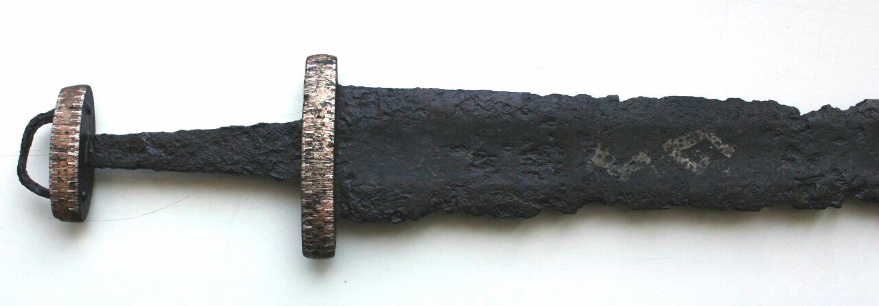

Help determine the pommel of the sword.

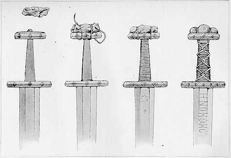

In Peterson's book, he points to the finding of two or three swords with a similar pommel.
The question is -

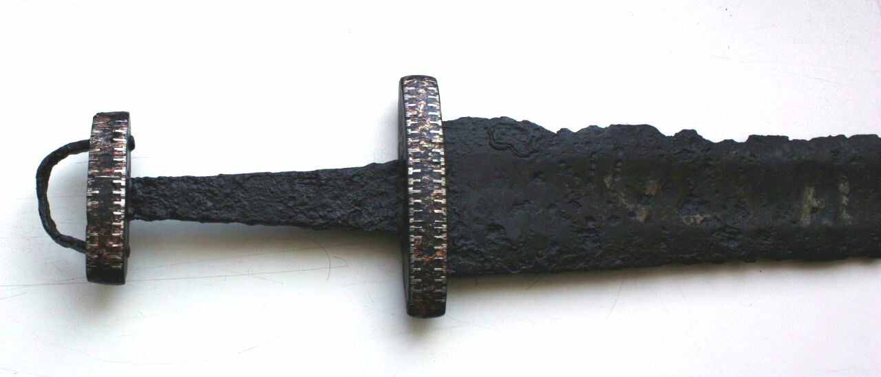

1. Is this pommel originally created in this form?
2. Or the pommel has lost its upper part?
In the photo you can see that the shank was riveted right after the first part of the top, although it is well known that the rasp has always completed the opening of the second part.
Gentlemen, what are your opinions?
Regards Alex

beautifull sword!
there is a theory that relics were bound to the pommel, in order to avert misfortune.
this bracket could be intended for this, the organic material has been lost after 1000 year, of course.
hopes it helps
best,
Jasper

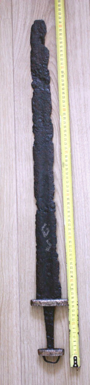

Can we see a picture of the whole sword, Alex ?
Is it part of your collection ?

I believe that part of the pommel would have been lost, the loop presently seen having once supported an outer shell decorated en suite with the rest of the hilt. Still, it remains a gorgeous Petersen type H hilt.

I think it is almost certain that these are cases where the upper portion of the pommel has been lost... The examples originally published by Petersen have been re-examined by Fedir Androshchuk and he is positive they are simply damaged specimens of Petersen's type H.

I was also inclined to think that the upper part was lost. Many thanks to all for your help and your answers. Alex
