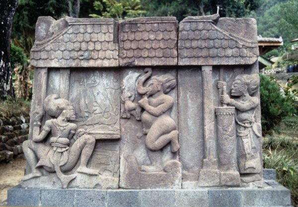

Have seen slightly similar shapes in some Durga Mahisasuramardini statues (9th 10th century mid/east java). The most nearest example however is in the in the relief of sukuh (see below). The sukuh example seems to be a more sophisticated blade, so maybe this is the more earlier and primitive version. Looking for some clues, maybe similar shaped blades in other region and/or more recent “cousins” of this blade. Any opinion or comment welcome. See below for additional pics.

What's hanging between the legs of the leftmost figure?
A kora?
Can't see any elephant features (as in the middle one) to suspect a trunk, and it is a bit too optimistic(?) for anything else...

doecon
Posts: 63
Ariel, the relief is indeed near so called "fertility" cult place
Check : Candi Sukuh, Mount Lawu, Java for more optimistic details.

They certainly have an exaggerated opinion about their accoutrements.
As to the original one, this is the first "Dhu-l-Fiqar" phallus in medical history...
