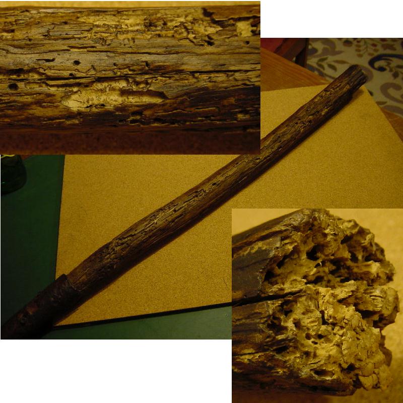

It came with a part of its original shaft, judging by its rusticity and worm degradation.

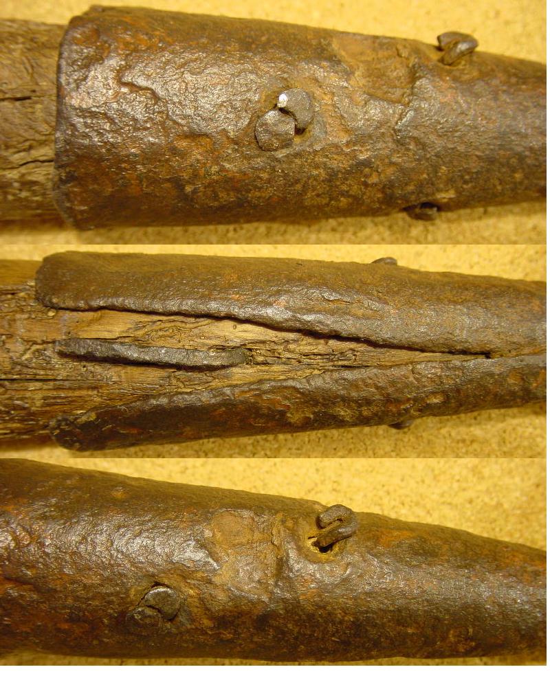

It looks like there is a hole through the head/shaft below the pins attaching the head to the shaft, where perhaps a cross-bar once existed. If there is evidence of a cross-bar, I would say this is conclusive of it being a hunting spear. If you have more than a half meter or so of the shaft, and there is no cross-bar or evidence of one, I would say it is not a hunting spear (at least not a European one).

There are indeed "too many" holes in the socket of this blade, but i can not come to conclusions, as i lack an experienced eye. The pair of holes occupied by those bizarre and apparently useless nails is not placed in an opposite position, and have a very narrow diameter, not seemingly ideal to hold the cross bar, as eventually the one only hole could be the actual fixing mode.

It looks to me, although it isn't my terrain at all, that there was a possibility of cross bars on the place of these opposite holes. The many holes in the shaft are spurs of woodworm. Still present?? Then you better should do something against it.

The worms are death now. I actually killed them by soaking the shaft with worm killer with such abuse that it lost practically all age nice patina. I also had to resharpen it and stick it again into the socket, as it was cracking at the fixing point, due to the iron nails contact corrosion.
Otherwise this shaft must be made of such solid wood that, despite being all perforated by the worms, it steel resisted my rude manipulation.

When i said "too many holes" i was referring to the three orifices on the socket, assuming some of them could be for a device like a cross-bar, after Mark's remark. But the holes are not right opposite, and are too close from the blade, rigt ?

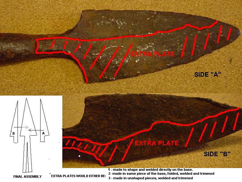

But in those days local tecniques were not so distant from the "Ordnance" ones and, what really touches me is the way this blade was built. Such particular forging ( welding ? ) manner certainly corresponds to an evolution period range , which would allow for a guess on its possible age.

The proportions of Katana's pieces are rather small, for the matter. My lance is a heavy duty thing. Remember the shaft is a 40 m/m thick staff. The blade is 70 m/m wide.
Here i show it in its real size, and the possible manner/s it was built.
I just don't see it being other than european.
