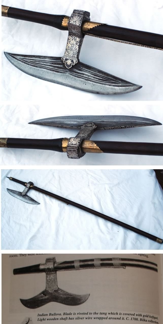

Not my main area of intereset, but the bidding was low and I picked it up from eBay. According to the seller the shaft is a replacement and he is most probably right. The blade was heavily patinated and even appeared as bronze, but it is all steel - head and socket. I would guess 19th century, a simple fighting axe.

Hi TVV,
Very nice!!
It is most certainly a rehafted example of what appears to be a war axe of the Khonds, one of the aboriginal tribes of Chota Nagpur (according to Egerton, 1880, pp.74-75, these tribes found on borders of Cuttack and Ganjora *). In his venerable book, Egerton illustrates one of these in group I , fig. #41.
In Stone, an example like yours is shown in fig.199 (#10) and included among examples of these Chota Nagpur war axes collectively known as 'bullova'.
According to author James Gamble ("Battle Axes", 1981, p.52-54), the battle variations of these Khond axes were only used until around the 1880's. The early examples after 1800 typically had metal shafts which were decorated in the same manner as the head. The early blades were rivetted to the tang, with later examples forged as a single piece. Egerton also notes these fierce tribes, known for particularly gruesome sacrifices known as 'meriah', also used thier axes for hunting wild animals, bear in particular. He notes that they used an axe with short haft and large blade, calling it a 'tungi', but it is unclear whether this would be in that category.
Your example seems to have good age to the blade, and clearly the haft is a replacement, but looks very nicely done. Very nice acquisition

Thanks for your reply, full of information as usual. I ordered Egerton's book, which is something I should have done a long time ago. Gamble's book also seems like a great resource, so I would try to get it too.

I also think that it is rehafted and the hilt looks verry awkward. It seems that it is from a modern lumberjack axe and that it has been repainted black. Also a part of the tang was painted.
Well, talking about bullovas, that was on ebay not so long ago and it is gorgeous. A similar example is pictured in Gamble's book stating that it is a 1750 piece.
TVV, I'm also in the search of Gambles book. If you find it please give me a hint.

It appears that James Douglas Gamble has several books, and I have no idea if "Battle Axes" and "Axes of War and Power" are similar in content. I beleive that the picture you have posted is from "Axes of War and Power". It is also the much cheaper one, as you can see.
I completely agree with you on the lumberjack hilt. However, the tang (or is socket a more appropriate term?) is not painted at all, it just comes out darker in the pictures. It is steel, the same patination as the rest of the piece. There is some simple engraving on it, most probably for decoration.
