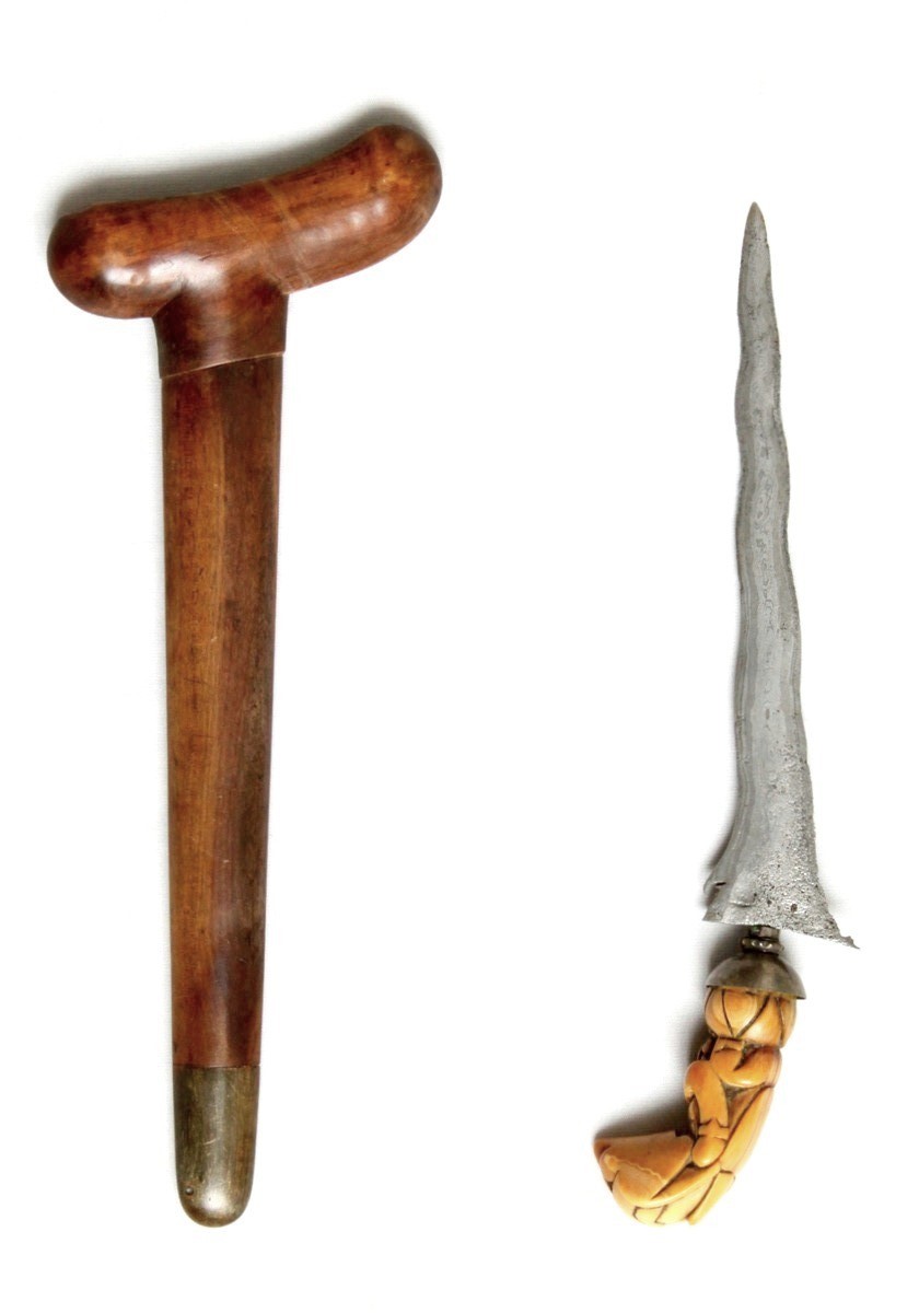

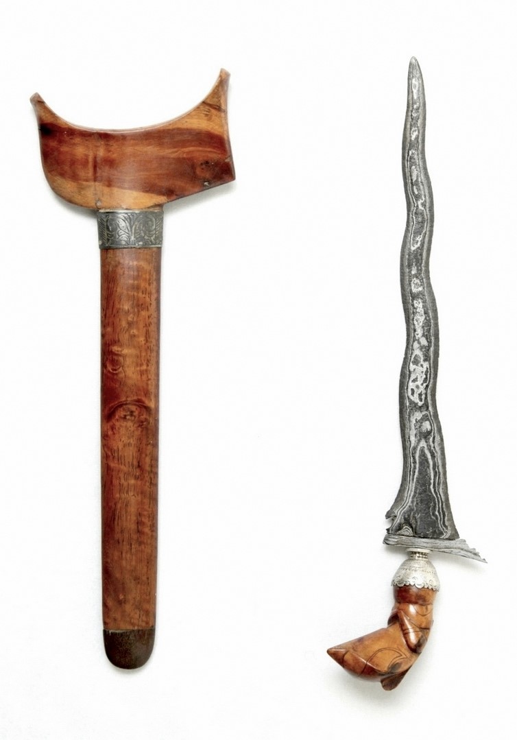

Nice specimen, I wonder whether the blade has been shortened a bit? (slanted at the tip).
I attach the pics of 2 small Malay krisses from my collection (already shown, sorry), the blades are 16 cm and 22.5 cm long respectively.

That's a very beautiful peninsula Malaysia keris selit. By the way, Peninsula malaysia people don't use the term keris patrem but just keris selit. It is usually worn by groom during wedding, when they use formal 'Malay busana'... Old traditional Malay attire. And also during any traditional events when Malay busana is worn.
Jean;
Your first keris is not from peninsula Malaysia, but I guess from Sumatra based on the hilt form. The second is not Malay too I believe. the blade is heavily stained (warangan) whereas malay blade is never waranged. The hilt of the second keris is Peninsula Malay hilt though.
I agree with Green on your first keris and i'm not sure that it is specifically intended to be keris selit. Perhaps someone knows more about the tradition of such small keris in Sumatra. I would imagine that dependent upon what part of the island one is on traditions vary. But i believe in certain areas patrems are known. Perhaps further north closer to the Peninsula keris selit are known, but on this i am not at all sure.

Originally Posted by Green
David;
Jean;
Hello Green,
I agree that the first kris is probably from Sumatra but not of a common type. I have used the word Malay in the broad sense so it is not equivalent to Malaysian.
Regarding the blade of the second kris, it was treated by warangan in Solo even if this is not traditional in Malaysia so you can't assess its origin based on this

Originally Posted by Jean
Hello Green,
I certainly understood your usage of "Malay" in this sense and also agree with you that you can't place the origin of a blade based upon whether or not it has received a warangan treatment since any blade from anywhere might get such a treatment dependent upon who its owner is and the customs of the area in which the blade travels and ends up.
I could be mistaken, but from my understanding Sumatra is a bit of a mixed bag culturally. Parts of it seem to be strongly under the influence of Malay keris culture while other parts (Palembang area) were strongly influenced by Jawa. So i wonder if the custom of keris selit was not known in the more Malay influenced regions.
