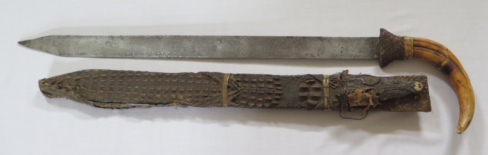

Hello everyone,
I've recently acquired some addition to my collection and the first piece I'll present is a nice kaskara sword from Sudan.
It would date from the mahdist war or maybe a little bit before.
I hope you will like this little new addition just for waiting the rest of the presentation
Friendly,
Clement

The blade appears to have 5 fullers, which is an interesting and uncommon feature. I also like the thick silver inlay. Per previous discussion in this forum, the crossguard is of a style attributed to Darfur. I wonder however about the hilt and whether it is a more modern replacement.

It is difficult to judge from the photos, butvthis appears to be a locally made blade.

Better photos would help, but the blade could be European with the later addition of the half moon marks in Sudan (notice how the one mark overlaps the fuller). However, it could also be local. Always hard to tell without better photos or the blade in hand.
The crossguard is of high quality and the blade decoration is an interesting departure for the more commonly observed thuluth acid etching, again better photos would help in this case.
Unfortunately I also suspect the hilt is a more modern addition.
An interesting piece, but I have some doubts the entire piece is homogeneous to the Mahdist period.

thank's for your comm !
I will promptly post new pictures of this kaskara, don't have the time and good conditions to take nice pictures....
For the hilt, it look like really homogeneous with the rest of the blade so it could be a later addition but I think really old ?
Clement

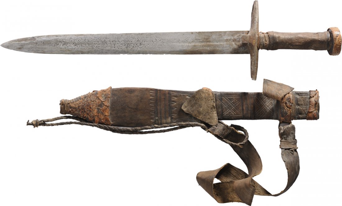

Here is something similar from the internet...
Perfect, I knew I'd seen that style of work before but wasn't coming up with anything in my notes.
I'd be curious if there are any firmly dated examples or bring backs exhibiting this type of work that can be used to establish a baseline.
A check on the British Museum and Pitts River Museum collections didn't turn up anything.

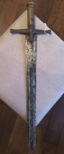

This sword was recently sold in England. It would appear to have been made to look even more overtly "exotic". Most likely another example of the "made for sale" genre, dating to the early part of the 20th century ? (Although from the image it does seem to have some wear).
I'd agree. The blade looks to be sheet steel and very crude.
Old 21st November 2017, 06:26 PM   #21
Posts: 10,862
Agree, sheet steel, and this certainly seems a piece made 'in the spirit of the Mahdist spectrum of weapons'.
It would be naïve to think that in the time of the Condominium, post Omdurman, that industrious native sellers would not fashion items for the bustling souvenier markets to satisfy occupying forces.
It seems a well known fact that often the production of certain items were even produced in Birmingham and furnished to vendors in the bazaars for such purpose. After all, Birmingham had been producing armor and such materials to Egypt for the Khedives forces long before this.
However, we do know that these 'souvenier' items which have severely clouded the integrity of the collected weaponry from Omdurman, and in the time thereafter, which was authentically used.
In fact the volume of such authentic weaponry was staggering, and the removal of much of it was seemingly a standard for British forces. Actually, as well shown by Kipling, the British military had great respect for the Ansar of the Mahdist forces as brave warriors, and collected his weapons in that regard. Certainly in the early years, even toward WWI, there was still substantial volume of authentic materials from these campaigns.
The conundrum faced by the ethnographic weapons collector is of course, how to discern whether a 'Mahdist' item is in fact an authentically collected campaign relic, or a facsimile produced for bazaar's or other commercial sale.
It must be remembered that in the time of the Khalifa, after the death of the Mahdi in 1885, there was a great push for weaponry to arm the forces, and the need to carry forward the instilled power of the Mahdi and the cause.
The use of profound embellishment in the form of 'thuluth' calligraphy was instrumental on these weapons, which in effect carried the messages and the 'magic' of the Mahdi.
In forces which were brought in from other regions, their ethnic forms of weapons were retained and even produced faithfully in Khartoum, many more ornate and thuluth embellished and intended for chiefs and tribal leaders of these groups.
Many of these unusual weapons seem to have been of somewhat dubious quality, and there is no doubt that the sheet steel and materials which had been in the shops and factories at Khartoum were used in fabrication of weapons intended more as emblems of authority to such figures. One source I recall noted that it seemed virtually every scrap of metal in the Sudan had ended up in Gordon's industrial complexes.
These are the kinds of considerations which come into play as we examine these kinds of examples, and each item must be judged on its own merits.
It is very hard to gauge from photos of course, and there seems to be few limits to the variations in weaponry which came from these times in the Sudan.

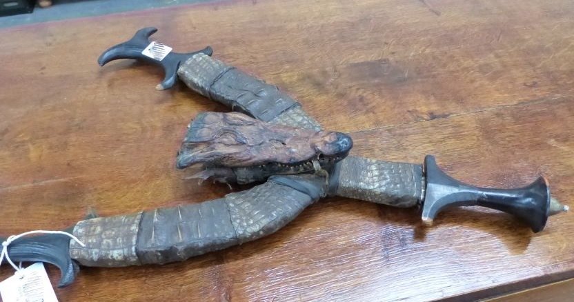

This item sold in the UK a little while ago... it is the most bizarre example yet I have seen of this Sudanese souvenir genre. As such, it's appropriate for me to add an image to this old thread on the subject.
