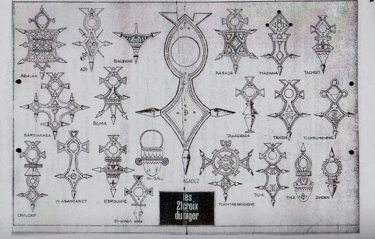

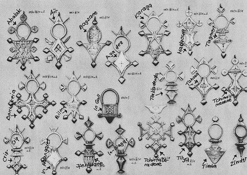

One thing I did discover is that the 'Agadez cross' as seen on the left and right examples in the original three posted here, is indeed that known as 'Agadez', but it is one of 21 cross forms, each attributed to other primary Tuareg locations. I found that Agadez (in Niger) was a kind of key point or center in a sense, and for example, the green leather used in scabbards was apparently produced there, and traded for use through Tuareg networks.
The Agadez cross seems prevalent symbolically on many of these daggers as well as on the Tuareg camel saddles.
The other forms of cross seem to be used primarily on jewellery, and not as I presumed in other hilts, though the center dagger here seems to be a variation of the Agadez with arms splayed upward.

Salaams Jim, As you note earlier the Tuareg Jewellery form is closely related in tradition:
Quote'' Cross of Agadez from http://anakomvoyages.com/tuareghistory.html often worked in Silver. The Agadez cross is the most important piece of jewelry for a Tuareg. According to some sources the Agadez cross is traditionally given by a father to his son when he reaches around 15 years of age. This is the age a boy becomes a man and is free to travel anywhere he wishes. The four points of the cross represent the four corners of the world".Unquote

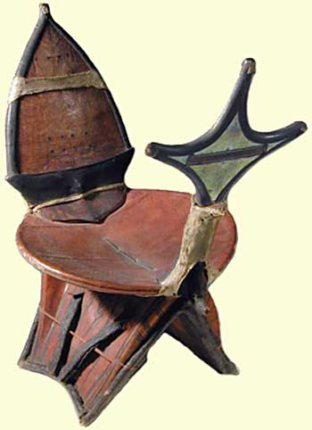

I note from http://camelphotos.com/camel_saddle.html the peculiar forked saddle made in Agadez by blacksmiths is also a related design feature incorporated also in the Agadez cross idea.

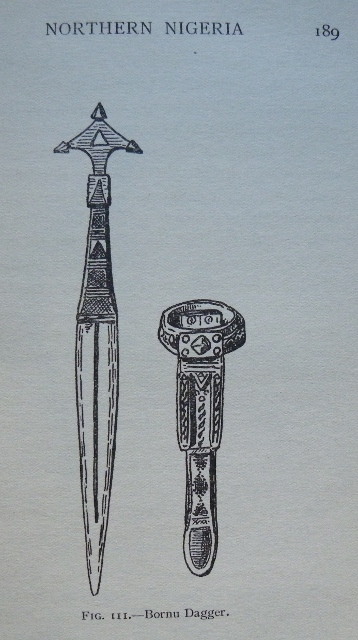

There is a dagger very similar to that on the left of the image from thinreadline, in the book "Weapons and Implements of Savage Races" by Montague 1921. He ascribes it to Bornu, which was inhabited by the Kanuri people ?
