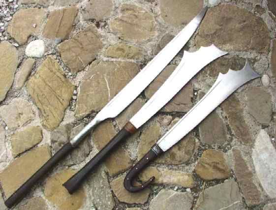

Old 9th February 2017, 11:56 AM   #8
Roland_M
Roland_M's Avatar
Join Date: Aug 2014
Location: Germany
Posts: 528
Originally Posted by Kubur
Is it a real sword or a fantasy??
Like a cleaver / pala... should be a fantasy...
I was sure, that I already have seen the point of this sword. It took some hours but now I know where. It is the point of a European medieval cleaver or falchion, see the picture.
I know this point from the "Mount and Blade" game, it's one of the most powerful weapons.
So the point of your sword seems to be inspired by a very old European type.
best wishes,
Roland
