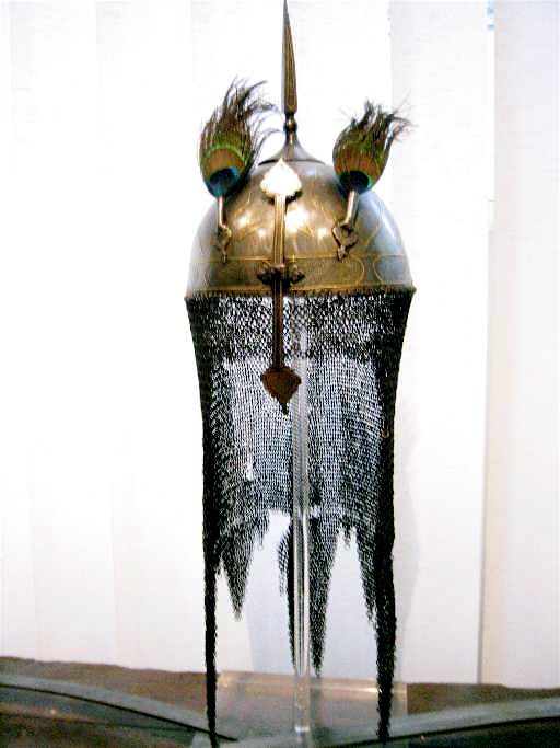

Guys, i was just wondering why we discuss blades all the time? 99,9999% of all posts is about various but still blades . No guns, no rifles, no fittings, no shields, no other accesories... Is beginning to be a little dull...
Well, lets hear your comments about a kulah khud. From the realisation of the mail I would say that it is a pretty new thing, but it is much less decorated that the late 19th century indian examples and it is definetly not a quajar persia, wich were predominantly engraved/etched for what I know...
I feel a little confused by thatone...
What do you think?

A wonderful and complete piece. Persian? Nice to have the silver koftgari intact. All the chain maille seems intact as well. We have discussed shields and guns on this forum as well......OO!OO! - A BLADE NEXT TO THE KULA KHUD!

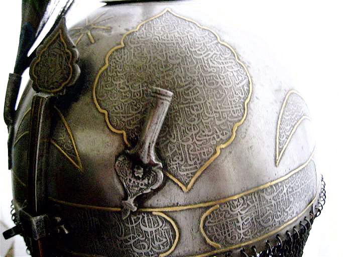

Congratulations Valjhun, it is certainly a very attractive piece, with all the bits present, i.e. the spike, the nasal bar, the plume holders, the mail camail etc, often one or more of these is missing or damaged.
My guess from the shape, the length of the mail camail and style of decoration is that it is Indian, mid to late 19th century. As to which part of India though i have absolutely no idea. India had many regions with many different local styles of decoration. B.I. might be the man to ask where Indian armour is concerned.
My guess is that the mail is unrivetted, am I right?
I would love to own one of these babies BTW, but with a wife, 3 kids and a mortgage that is a plan for the distant future. I am green with envy.

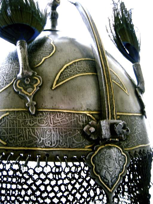

its a nice a decorative helmet. i strongly feel the date is late (late 20thC). the decoration is nice, and found on contempory jambiyas made in india for export.
there are a few types of later helmet, and of them all this is the most decorative and 'authentic' looking. if you consider that the majority of 19thC helmets (both indian and persian) were made as decorative items and not to be worn, then your helmet has the same merit in any collection.

That possibility didn't even cross my mind. I am aware that reproductions/replicas of kulah khuds are made in India, but the quality of the ones I have seen on the internet is quite poor, by contrast Valjhun's new helmet seems very well made, with rather tasteful decoration.
I suppose the reason I didn't consider that possibility is because a- the camail looks rusted and b- the bowl looks like it has a patina.

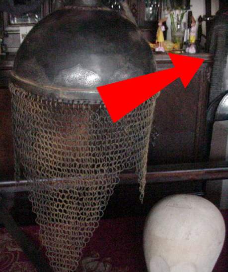

Hi
just to put in comparison
I believe that one really Kadjar, not only because is mine
I'm using it as "avatar", but it's not only a picture

Dom, that is a gorgeous helmet, I'm feeling quite envious now.
