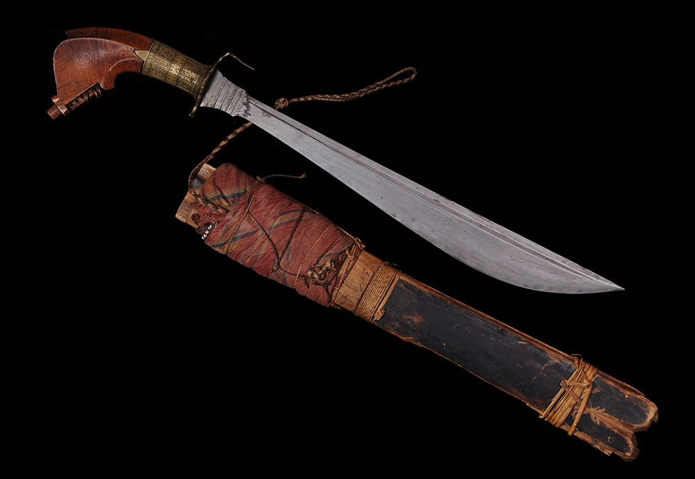

Here is some pics of items I have.
1. Katipunan? Matulis?

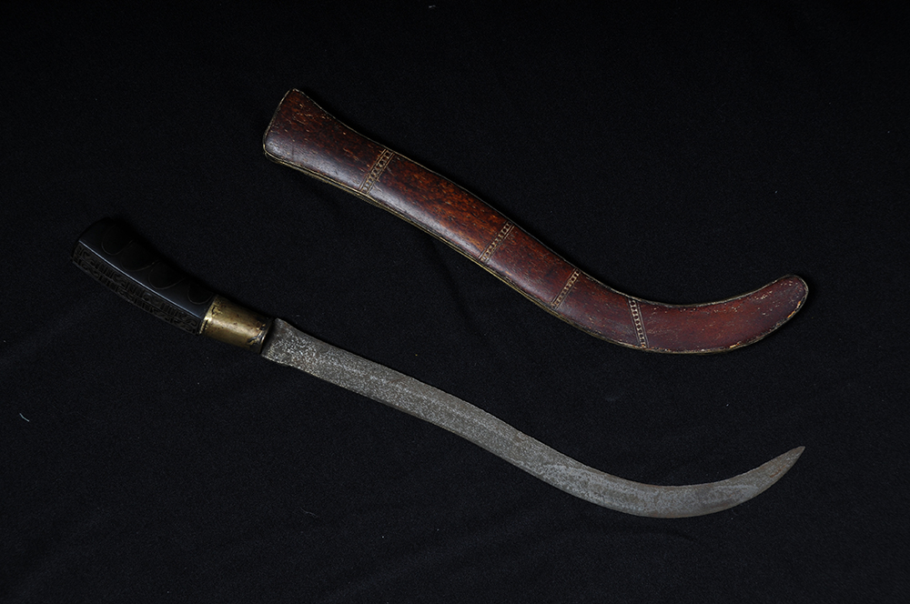

2.T’Boli Sword from Mindanao. But what its name? T’Boli kampilan?

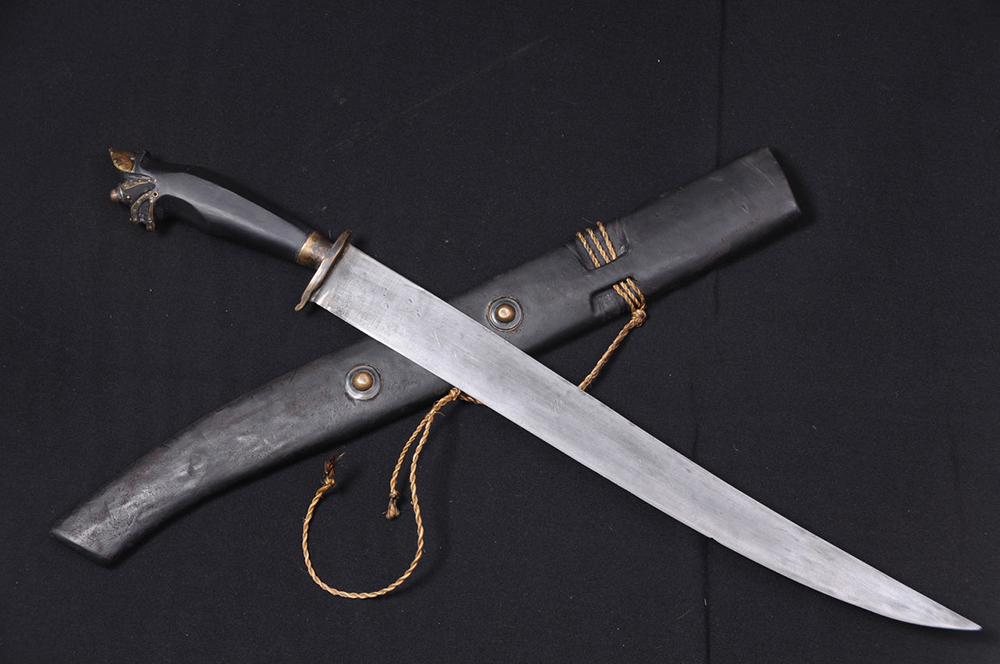

3. Bagobo Sword. Idont know its name as well. And I met Bagobo Sword with absolutly the same handle with kampilan-type blade. Is it diffrent type weapon?

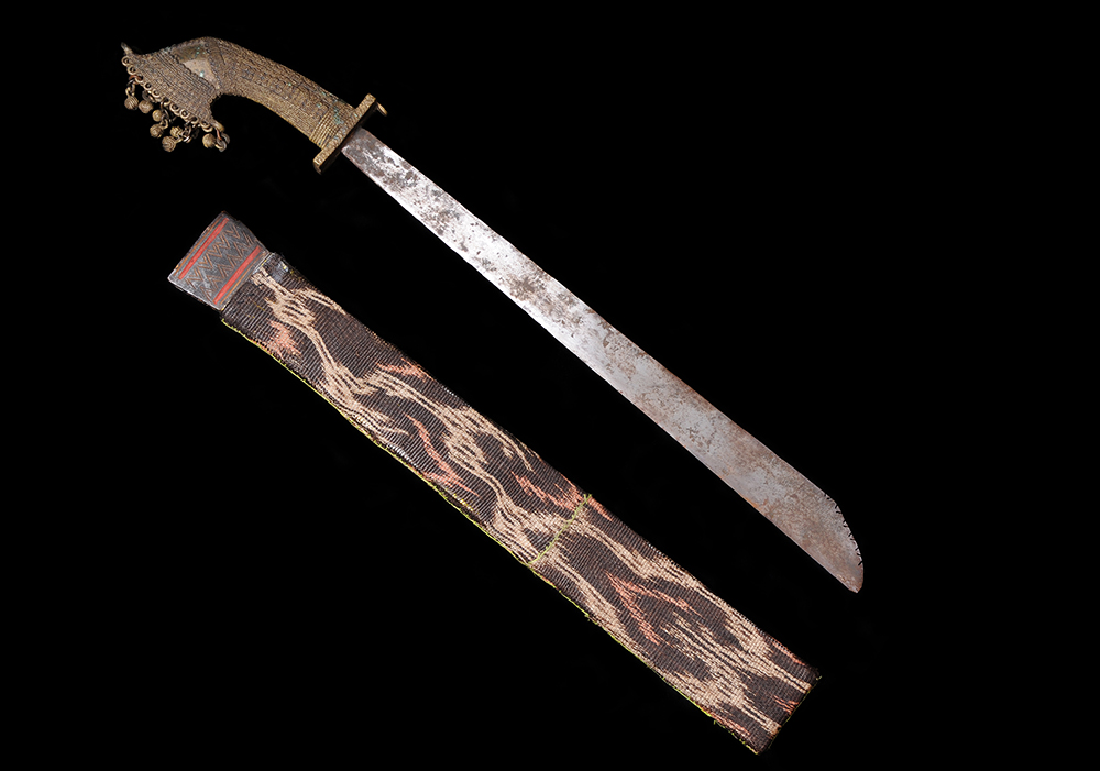

4. Karit? Say the truth Im not sure that Filipino sickle.

1. Is a Tagalog bolo/itak in matulis style, but with a Visayan scabbard
2. Is a T'boli tak
3. Is in deed Bagobo, but I will have to look up in my files for the name
4. I think you are right about it being a karit
The bottom 2 look to be early 20c, and the top 2 might be around WWII.
