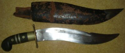

We may have looked at this before. But, I just came across it in the collection again and I am still not sure where to place it. My initial though was an early English Naval dirk influenced by asian design. (Sort of a midshipman's mameluke) Any suggestions?

The scabbard looks home made with standard parts.
The blade also looks shortened.
Are we sure it irt was intended to look like that or is it a reworked sword?

Ariel,
I believe it was intended to look like that:
1) The blade taper has the strong ending withing a few inches of the guard. If it were a full sword it would have extened much further and grinding it down wouldn't have made sense and would have altered the shape of the fuller.
2) The blade thickness is about a 1/4 dropping to 3/16 a few inches in front of the guard. That seems light for most swords.
3) The blade curvature is fairly servere. Extending the curve for a further 12 to 20 inches would leave with something shaped like a shotel; and, this doesn't strike me as a shotel.
4) The handle is very small, perhaps made for a hand that that is no more then 2-1/2 inches wide. Again, consistent with the blade, but inconsistent with the notion of hacking down a sword blade. You would have to cut the tang considerably.
5) The scabbard is significantly old. The whole piece strikes me as having been overly cleaned or restored (as in the outside of the scabbard may have been painted or tarred) Which gives it a fresher look then really should have.
6) The mounts are fairly heavy steel. Simple, but more like military mounts then a decorative casting or backyard project.
On second though this may not be a dirk at all. It looks more like a 18-19th century child's sword.

The handle looks too big for a child.
Perhaps; if so, what do we have here?

For a woman, perhaps?

Sorry n2 but the knife is in an antique shop. It is quite substantial like a kukri. If it tickles your fancy you can always PM me. Tim

I realy like it N2S but havent a factual clue what it is.
My fantasy though is Turkish Navy or Barbary pirate.

That was my first impression too. Then again this whole Nepal angle is quite fascinating.

It remainds me, especially the scabbard, to the British East India Co. officer sword... Nice dagger! I'd love to have it!

This knife has just finished on ebay, I did not bid, no one else did either, could have got it for two portions. I do not think it is that old and in my opinion the one in question is not old. I think you can see the N.Indian/Pakistan/Afghan origin in both knives. This is almost identical to to knife with the spit scabbard I did not buy.

In looking at this example posted by N2S I am inclined to think of this weapon as a dirk for a naval officer, and although not necessarily British EIC as suggested by Valihun, it does very much seem British. After the Napoleonic campaigns in Egypt the mameluke form sabres did become popular with British as well as French officers, and the distinctive Ottoman hilt forms in particular. In the early 19th century there were a great deal of military outfitters in British occupied areas of the Ottoman sphere, especially in Egypt and Aden in Arabia. It would seem that such a dirk may have been fashioned for sale to British naval officers near the close of the Georgian period, however these were strictly for dress wear. Gilkerson in "Boarders Away" (p.115) notes that "..no battle use of a curved naval dirk is known, and it cannot be considered as ever intended for anything other than dress wear".
The curved blade in dirk size according to Gilkerson (op.cit.) was inefficient at best, noting that the true fighting dirk was straight bladed and for of course, the thrust.
Annis & May ("Swords for Sea Service" p.75-76) note also the apparant disregard for curved dirks as weapons, but interestingly do note that there are a number of them with curved blades and 'mameluke' pommels in the National Maritime Museum in England.
It would seem that while the dirk was of course known in other European navies, the mounts were most likely with zoomorphic pommels reflecting those typically seen on officers dress swords.
These are simply some observations from standard references that may pertain to the example shown, however the blade seems to be quite substantial and quite as deadly as any curved Oriental dagger whether intended for combat or not. In any case, a very attractive weapon.
