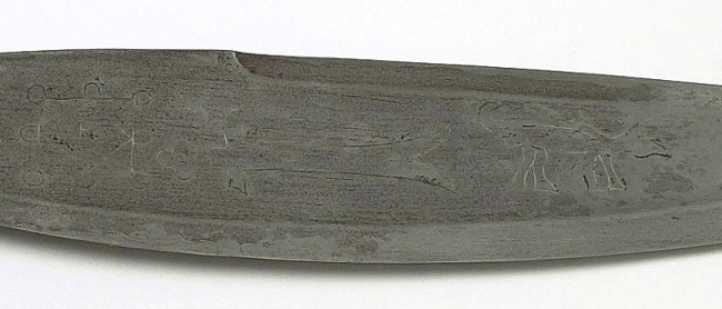

I hope some of the Moro experts can help with explaining the signs on this Barong?
As I understand it's a double edged Shandigan?
- The Ring of Solomon I recognise but what's the "cross tongue" below it?
- Is it a dog or something else depicted closest to the tip?
- Is it a naga or a centipede at the other side of the blade?
- And what's the meaning of the symbols?
All comments appreciated.

Here is a close up of the blade of the Barong from the seller.
One day maybe I will learn how to take better pictures...

The second picture, it might be "Dhu'l Faqar", the holy sword of Islam.
Refer to this thread for details on this sword...
http://www.vikingsword.com/vb/showthread.php?t=1923

The undulating snake with transverse lines reminds me of Persian motives.
Going totally on a limb, is it possible that the dog is a local "transcription" of a famous Passau mark? Many local blades from the Caucasus ("ters maimal")to E.Africa carried fake Passau marks as a testament to their quality.
Would it be possible that the maker of this Barong just went overboard and marked his creation with marks from all the best swords he knew: Passau, Persian and Zulfikar just as an equivalent of "Wow, look at it!"
And indeed, it is a very, very well made blade, something to be proud of.

I am going to sound really outrageous especially as I know little about these things but look hard at the snake and I am sure is has curved pincers at the mouth and the over all look is one of a centipede or millipede insect. I also believe that dogs can be auspicious animals in many parts of the world. These symbols could be saying I can hunt and find you like a dog and ferociously devour you like the millipede. I think we have seen dogs on other S,E,A weapons.
Edit, the so called Naga also has antennae so if I am reading the pictures correctly I am sure it is an insect. These pictures are not of a weapon, a Borneo? smoking pipe, the only S,E,A thing I have that shows the use of the dog as a symbol. Tim

I also think the last symbol looks more like a centipede/millipede than a naga.
But I have seen other Moro naga symbols before that resembles this one.
And on the dog (or whatever animal it is?) it could be like you suggest.
But I don't know anything about how a Moro would interpret a dog in a symbolic way?
In Dayak cultures however dogs have a well-documented value as a symbol (aso).
Cato mentions horses as status symbols.
But I don't think it looks like a horse on my Barong?

the dog could be nothing more than his family pet, that's all

Sure its a dog it has even got the Dogs Bollocks there I have said it out loud at last . It could well be a pet dog but I do not think so. It is a bit girlie for a macho barong swinging warrior .

Very nice puppy (the barung I mean ). Yes, it is not a centipede but a stylized naga - seen this type on other Moro things (including Ian's barung). the other - horse, aso (though rare on Moro)?

Look folks how many horses carry their tails like this one, it could almost wag, even young children draw horses with some attempt at a long neck and long rounded head. Is it possible that you have seen Nagas where there is really a centipede? I agree one sees many stylised forms of serpent but go into your garden turn over a stone and one of these with pincers and antennae is likely to be there. It is so clearly drawn in my opinion, almost like a road sign. Tim

Having two kids I must agree with Tim on the dog vs horse issue.
On the naga/centipede I just remembered that when I was in the Visayas and had a couple of (new) blades done for me they asked if I wanted to have them specially prepared. The special preparation was mixing live poisonous spiders and centipides in the steel just before tempering it.
Is that something that is done in the south also?

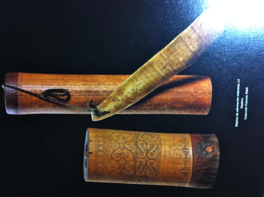

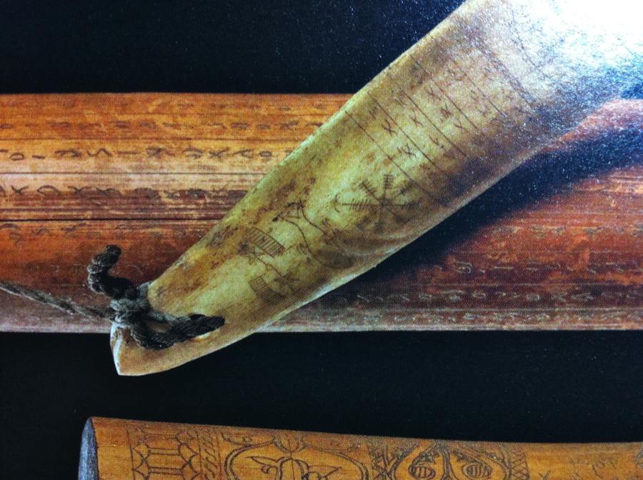

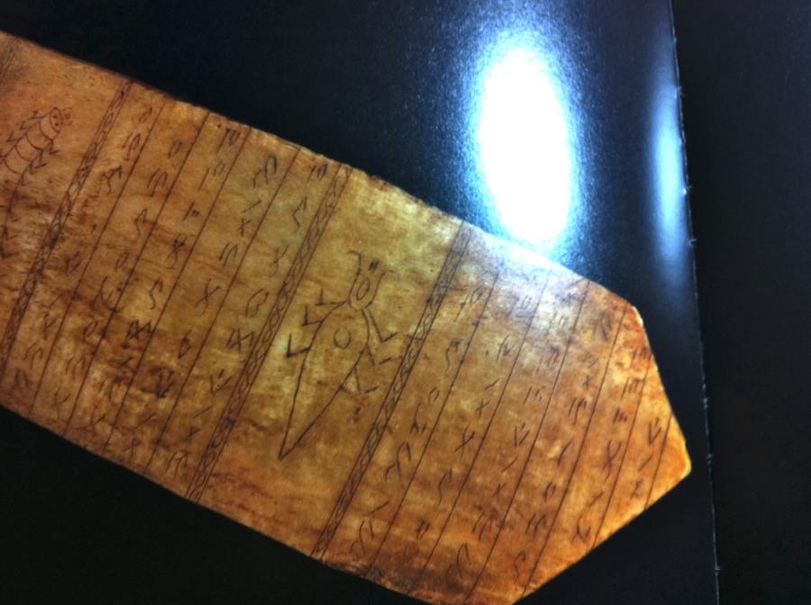

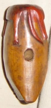

Found these pics from a Spanish photography-travelogue book. The caption says objetos de adivinacion indonesia (Indonesia divination objects).
I thought the centipede and the two other critters look familiar ...
