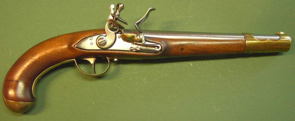

Default Austrian flintlock Pistol for id
Who could tell me which model is it ,this pistol is CIRCA 43 cm ,I found a similar pistol but with percussion lock called Kavalleriepistole M-1851.
Any comment on it will be welcome.

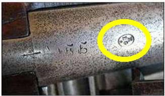

Isn't that the Poinçon de Liege, Jean-Luc ? .
... and isn't the one you found similar, the same model later converted to percussion ?

In other words ...
Your example would be the Austrian cavalry pistol Model 1798. This pistol type later became Model 1851 when it received the Augustin system percussion lock. Some surplus of this Austrian arms were delivered to US forces in the early days of the Civil War.

Hi Fernando
Yes the M1798 has the same type au stock but the lock is different with a brass flash pan.( see the photos) and as you can see my pistol lock is more similar in design to the percution lock M 1851 .
So I was wondering it was not a transition model after the m 1798 and before the M 1851.

For me, is a Belgian copy, the punch of Liege and the number "852" which means 1852

This was originally an Austrian pistol M 1851 system Augustin, a special Percussion system only used in Austria. After the German-Austrian War of 1866 Austria sold lots of these pistols to the market. Liège Dealers and gunmakers bought them in great quantities and built them back to flintlocks. These reconverted pistols have than been sold to states in South America and given as exchange material to African clan chiefs in the European overseas colonies.
