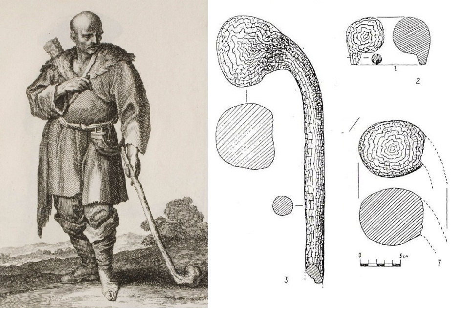

Depiction of a Cossack from 1701 and similar clubs excavated at Berestechko battle site (1651).

about the cossack club!!
thanksdidnt know this very intereting to see as well looks the same as an east african ringu club...
i wounder if these were typically thrown .. as this shape works best as a throwing club.

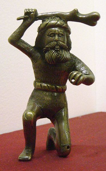

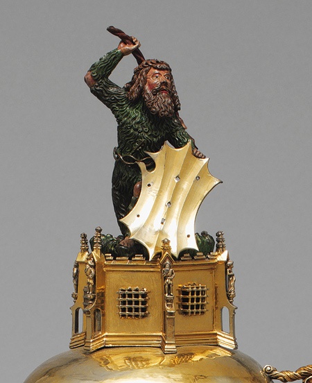

Wooden clubs are often depicted in connection with Wild Men in medieval artworks. Wild men were representing mythical figures and being a symbol of the romantic good old archaic times
