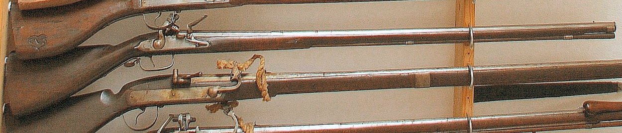

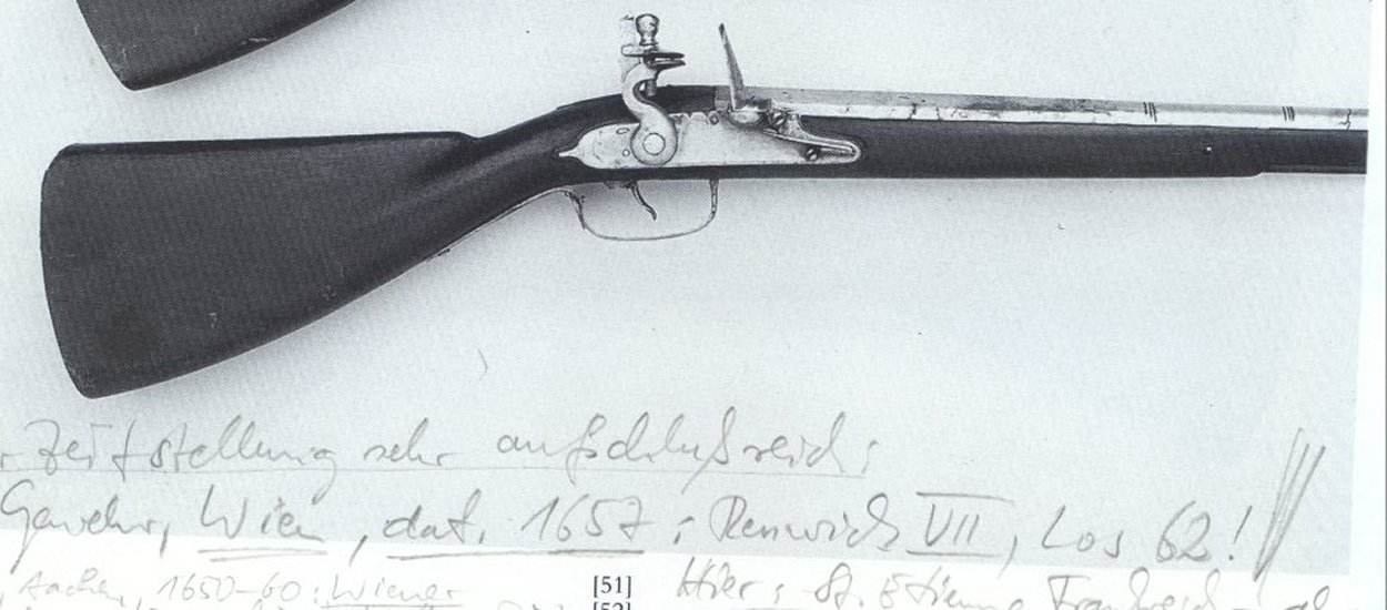

As the maker is apparently unrecorded we can but speculate.
My first guess concerning the date of manufacture would have been 'not before 1645', so why not read the date as 1656? This is more reasonble and would make your lock mechanism contemporary with my Schloss Dyck musket signed by Chiese, St. Etienne.

Hi Michael,
Thank you for this comparison . I was thinking about this possibility as well, but the line beneath the half circle is going askew to the left
I also believe that the schloss Dyck lock is more recent than the Burgunon one. The hammer does have the same duck beak shape, but the burgunon one is more massive in the "head" section of the hammer, also the base is not rounded and larger than the schloss Dyck one
As far as i can tell from the books i got, the hammer slowly evolved to the swan neck? The schloss Dyck lock seems to be further down this line than the burgunon one?

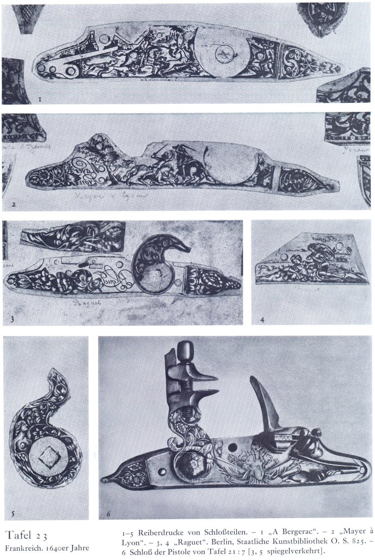

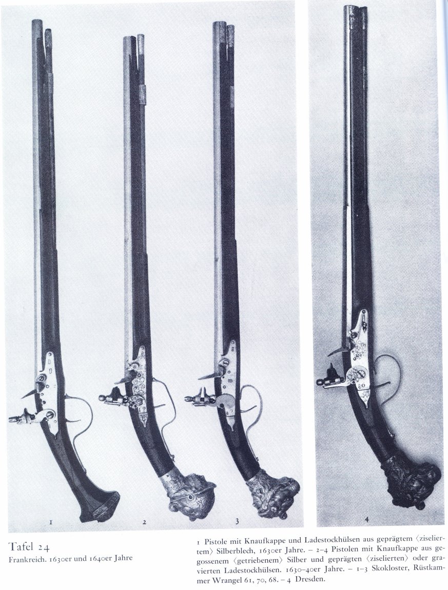

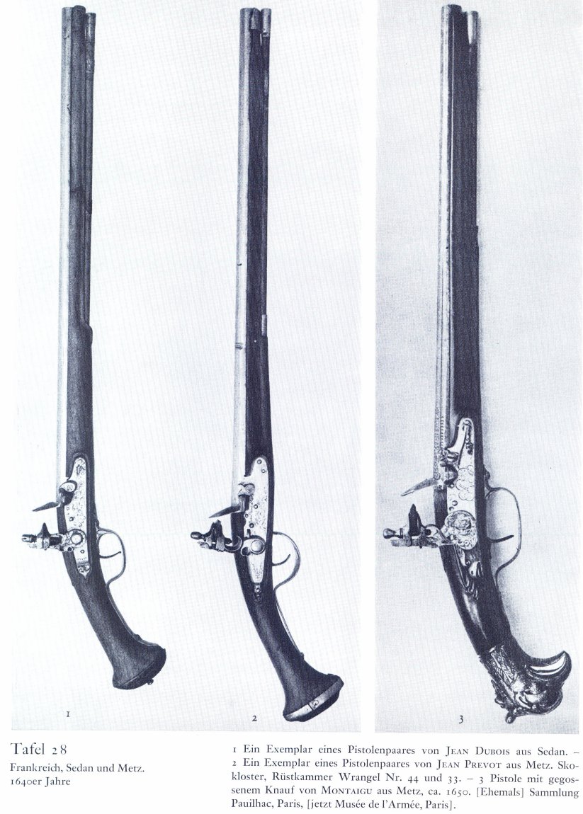

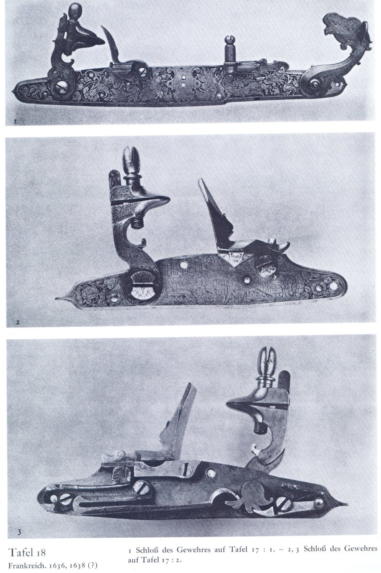

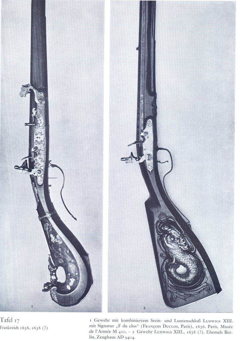

Thank you, and you are right indeed, Marcus,
But the ultimate work on flintlock weapons still is Dr. Torsten Lenk's Flintl°aset, dess uppkomst och utveckling from 1939. Sadly, the photos in the English edition The Flintlock - its Origin and Development in one volume are much worse than in the German 2-volume edition Steinschloss-Feuerwaffen, 1969.
Lenk pictures some firearms with locks almost identical to your instance and assigns them to the 1640's for Paris (!), as I did at first.
I once owned a heavy flintlock wallgun employing a very similar mechanism of ca. 1645:
http://www.vikingsword.com/vb/showth...5+schloss+dyck
