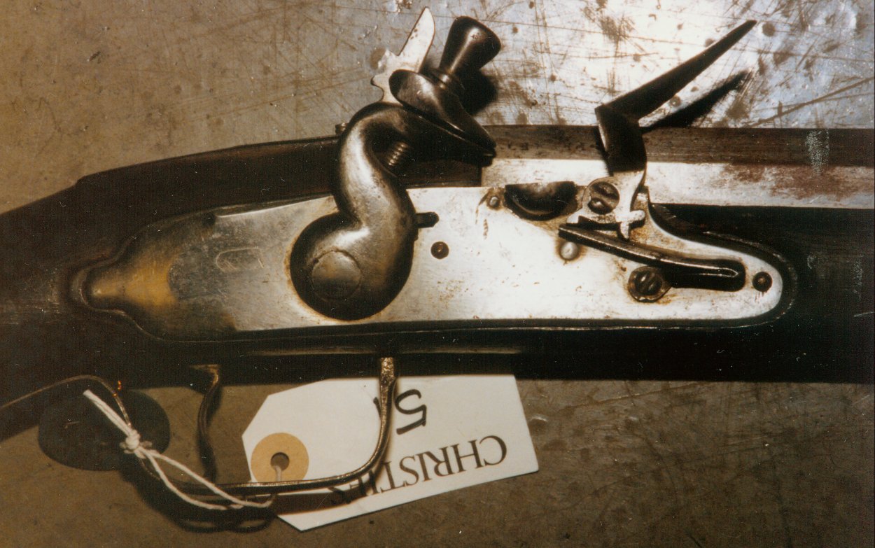

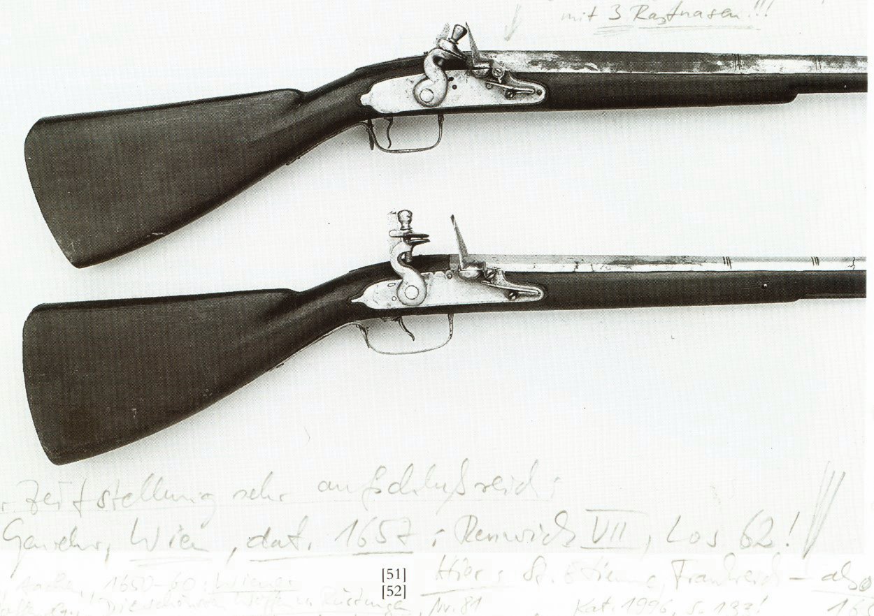

It is rare to see me posting on a gun transformed to percussion in ca. 1840 but this mechanism is notable for the fact that the sear nose protrudes from the outer lockplate. This a very unusual version of a so-called German Hakenspannschloss which first appeared on early flintlocks in ca. 1650.

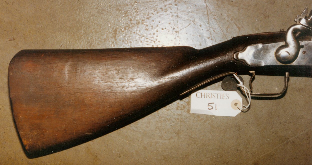

In the first part of the famous auction of the complete armory of Schloss Dyck near Düsseldorf, the former collection of the Princes Salm-Reifferscheidt, at Christie's London, 15 April 1992, there was a remarkable early French flintlock musket, ca. 1655, lot 51, with a lock of that type, falsely labeled as a 'snaphaunce' by Christie's.
It was heavily damaged, with various parts missing and a defective action, so I bought lot 52, in perfect condition including its original ramrod, illustrated with lot 51.
Michl

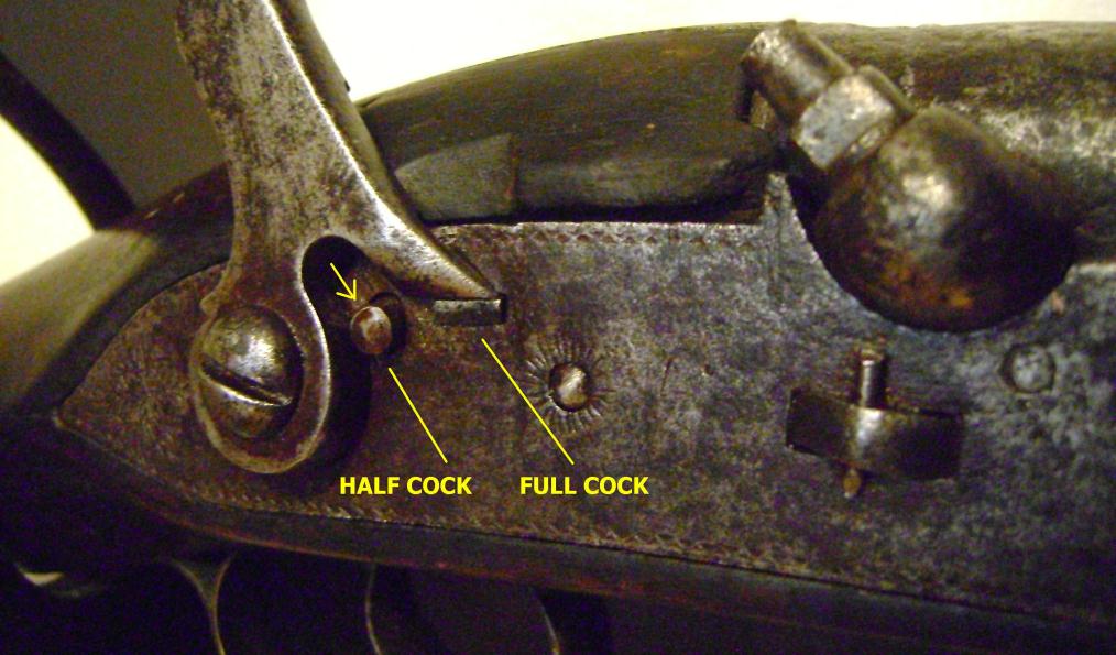

I confess this is the first time I meet with the "crowbar". It has many similarities with the Spanish Miqueletes. The average riding (half cock) is achieved with a projection (arch) that gets under the curve of the appendix and full rides (full cock) is achieved with an appendix spring, I imagine.
The system referred to Matchlock, would not be the same, and which can be seen in some Scottish weapons? (half cock)

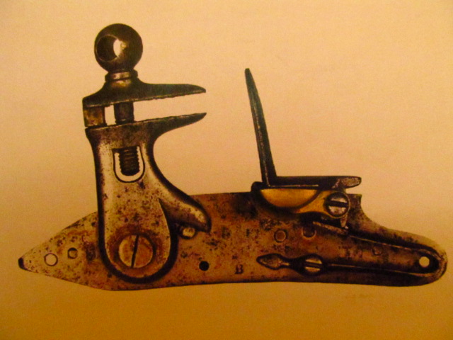

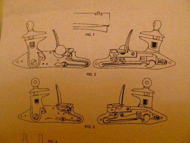

Here I upload a picture of the key (lock) called "mixed" model 1801 pistol. Gib had a musket-fire keeps the bowl (pan), and a drawing of John Sopena Garreta "History of Spanish arms" of the two keys (locks)
affectionately

I was aware of the "llave mixta" 1801, as it comes in Calvó's work ARMAMAMENTO ESPAÑOL EN LA GUERRRA DE INDENPENCIA, equipping cavalry pistols and the tercerola model 1803.
You are right in what concerns the cocking of my carbine, with two positions.
